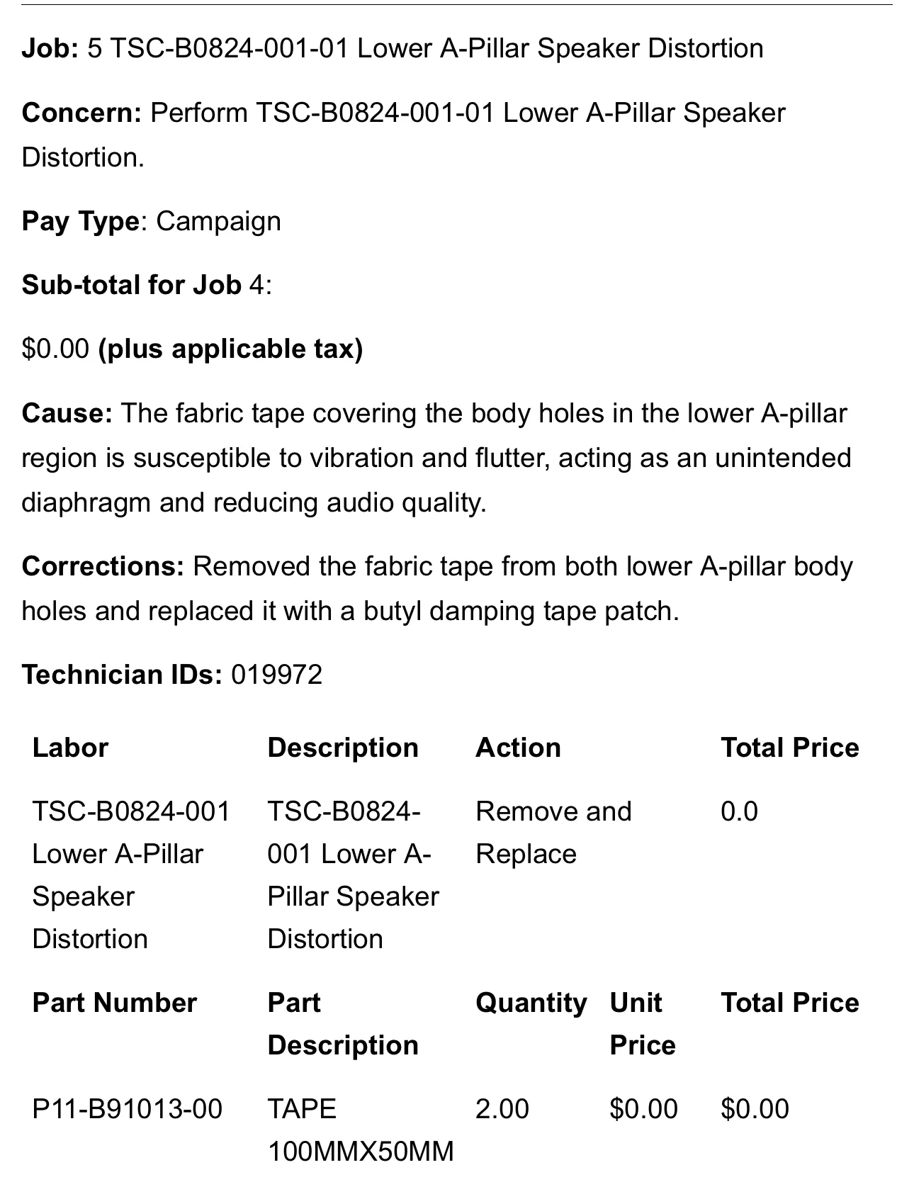

So is it confirmed that TSC-B0824-001-01 is what's needed to "unlock" the full SSP enhancement? I don't think my car has had that applied yet
just updated to 2.5 and I have to say although the bass response is better, I miss the clarity and complexity of the previous SSP. The new system sounded like it was missing the depth and nuances that the previous one provided. Anyone else feel the same way?
Hi, @mcr16! Perhaps you could shed some light on the TSC 'tape fix' requirement, as it relates to us owners with SSP wanting to activate the related enhancements embedded in the 2.5 OTA update. @borski, who I generally find to be the soul of credibility, says that "You need TSC-B0824-001-01, and once that is complete (in Lucid's tracking system), it will "unlock" the new audio system in software automatically....". However, some owners are reporting significant post-update SSP improvements, without having completed any prior 'tape fix'.
While I understand that this TSC is needed to realize the 'full positive effect' of the SSP software changes, I find it kind of hard to believe that the benefits would not be realized 'at all' before the TSC is completed, due to not being activated. I myself had the 'close but no cigar' TSB tape fix last August, and I'm fairly confident that I would not need to bother customer service right away with the TSC 'tape fix' if these software enhancements were activated upon installation.
Otherwise, many of us SSP audiophiles are going to be urgently trying to get this TSC implemented ASAP! Would you please clarify? Thanks!
There are audio improvements experienced without the fix, which many are noting, but the tuning will be improved further after the hardware adjustment as specified in TSC-B0824-001-01.
Thanks so much, @mcr16! Pardon me being dense, but I think you are saying that all of the SSP software will be activated upon installation, but that the sound will further improve once the TSC is done. Is that correct?
Are there any audio improvements with regular SS? It wasnt clear from the release notes because they say "Low listening-level sound quality improvement" without any system qualification and then go on a few lines later to talk about improvements to SSP.
I’ll let her confirm, of course, but I read it as “new tape is better than old tape,” but the tuning changes after “new tape” that are then activated are yet further improvements.
It isn’t just a passive improvement, per my understanding.
So I should ask to have mine updated to "new tape"?
I do. I had the terrible woofer noise long before this update that was fixed by the new butyl tape application.
That is not necessarily the same thing. Check your service invoice. If you did not *specifically* have TSC-B0824-001-01 applied, you do not have the fix.
The old tape applied by the TSB, not the TSC, is not the same.

Make sure you have the TSC.
