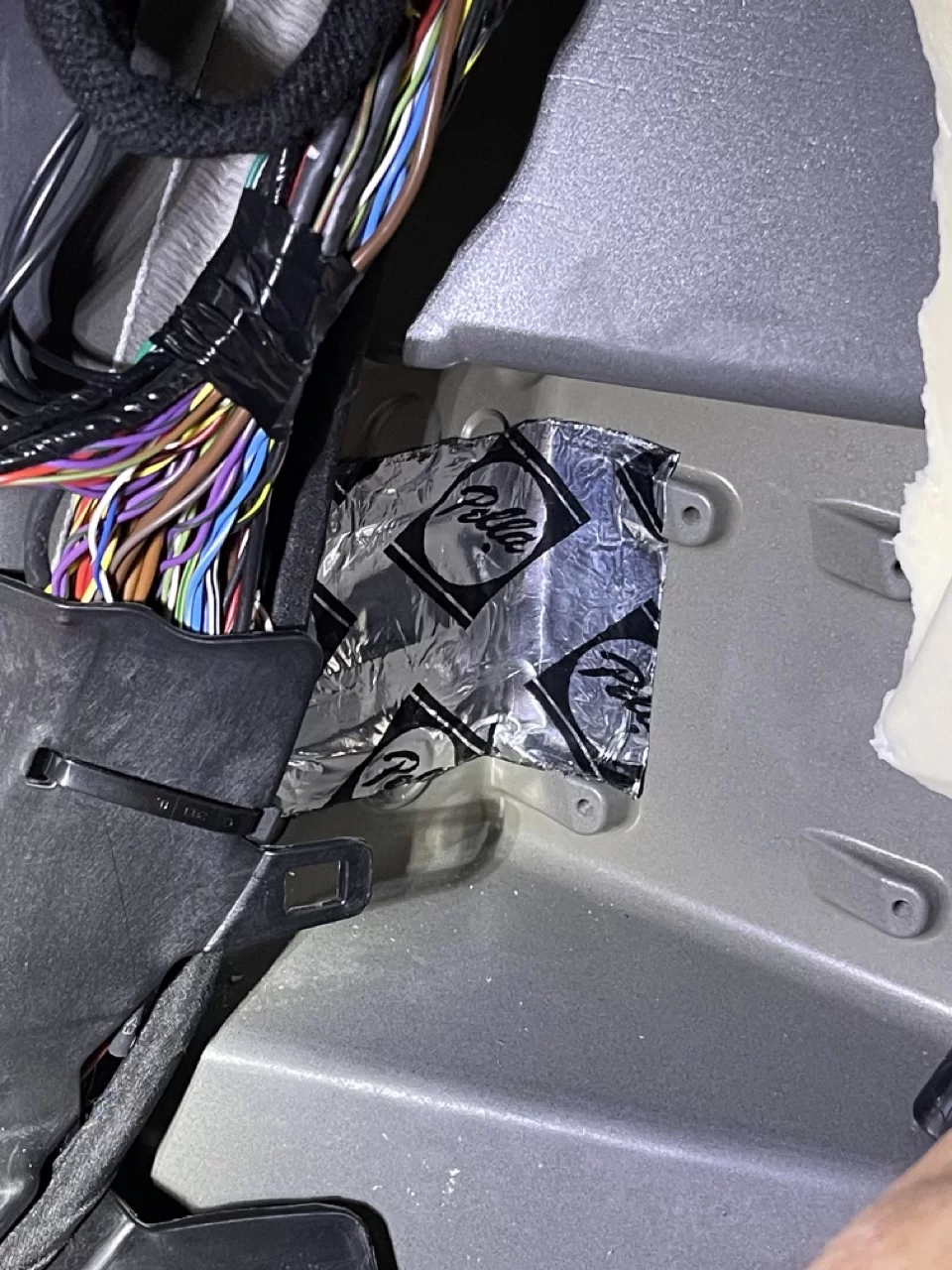

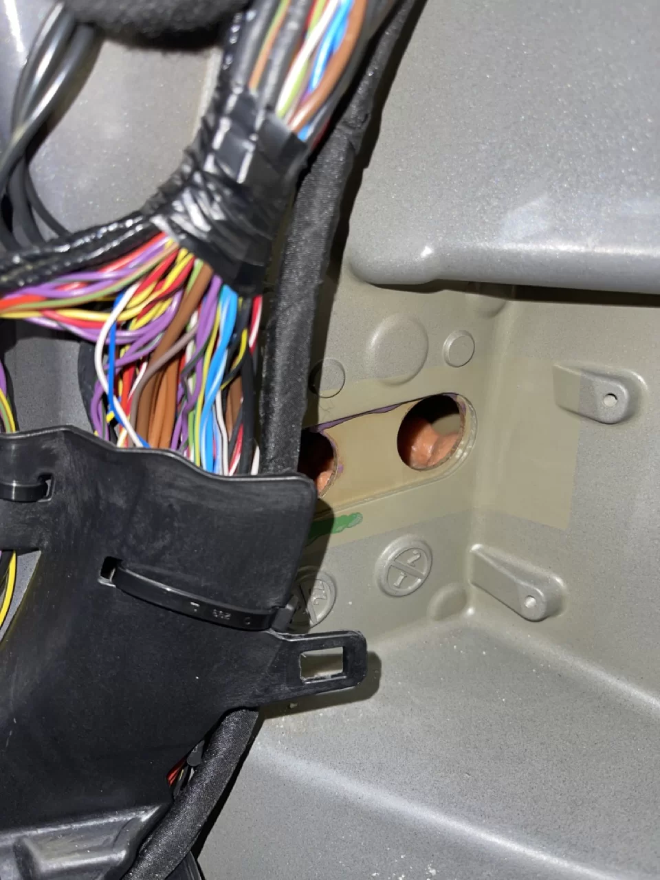

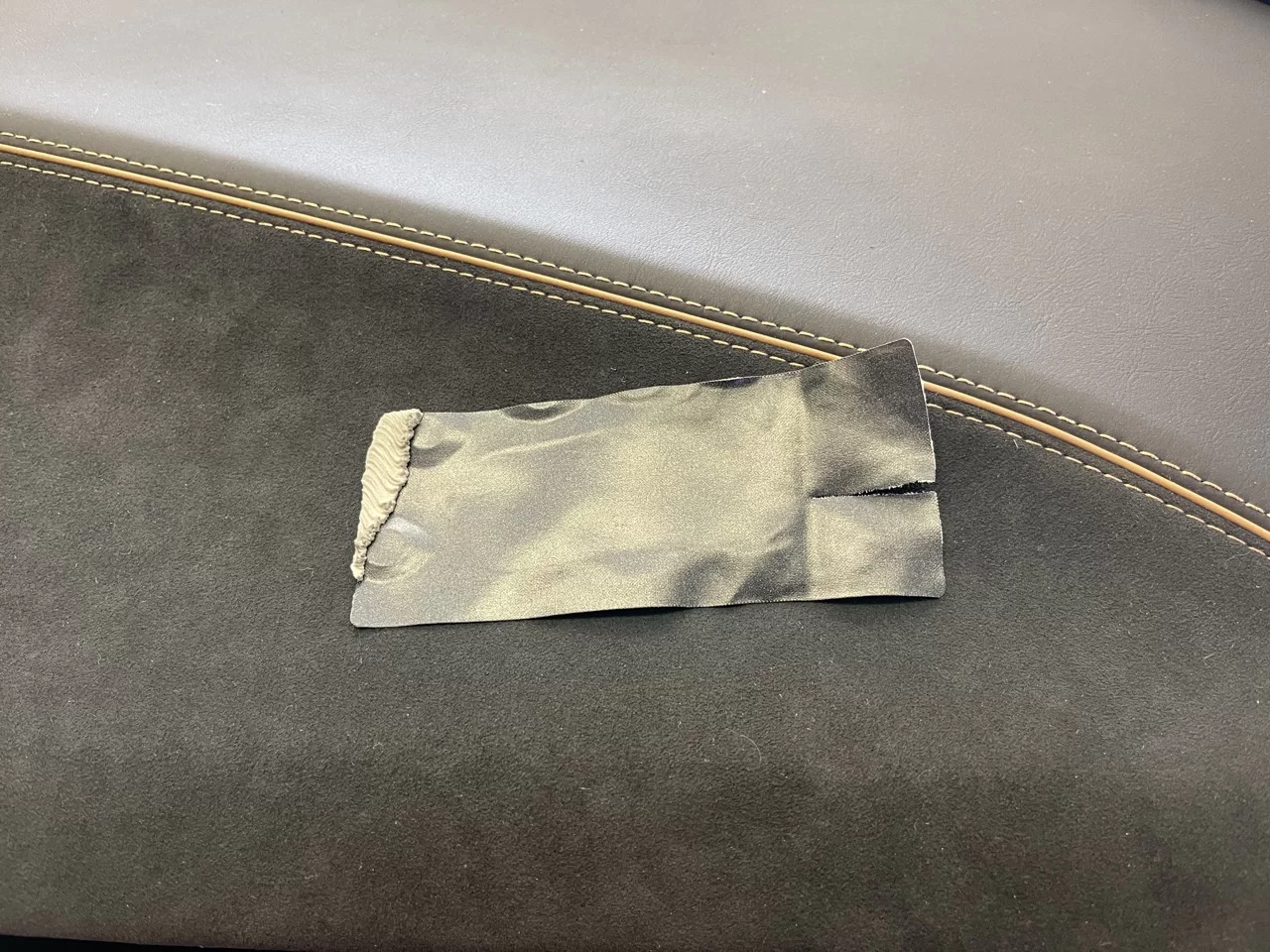

Since the time that I originally discovered the problem, more knowledge has been gained about it. It turns out it's not the speaker at all. Behind the footwell carpet is aluminum body and in it, two 1 inch holes. These holes are covered by a piece of tape that looks like duct tape, about 4" x 2". It turns out it was that very tape that would vibrate and cause the sound of distortion. Frank removed that tape and replaced it with some foil backed butyl tape (Pella window tape to be specific). Voilà, the problem was instantly gone. The sound system sounds amazing now. While he was at it, he also did the passenger football which had some of the same problem, but not as pronounced. So happy with the sound system now!

Thank you so very much for your information sharing and particularly these photos. I had the same sound issues reported above, went through the 5 stages of grief, then stumbled upon this post. I showed the issue to Tyler, the mobile tech servicing the Philly region. I explained that I learned of a possible cause and solution on this forum. He was happy to read about it and learn more. I suggested the butyl tape solution. Of course, I wish the Lucid team already knew all the info on this forum already but Tyler was open to learning about it, ordered up some butyl tape, and came back for a second mobile visit to try to fix it. Just as others have described, covering that hole with appropriate damping tape solved the issue instantly. The sound quality in my car is ridiculously improved.
