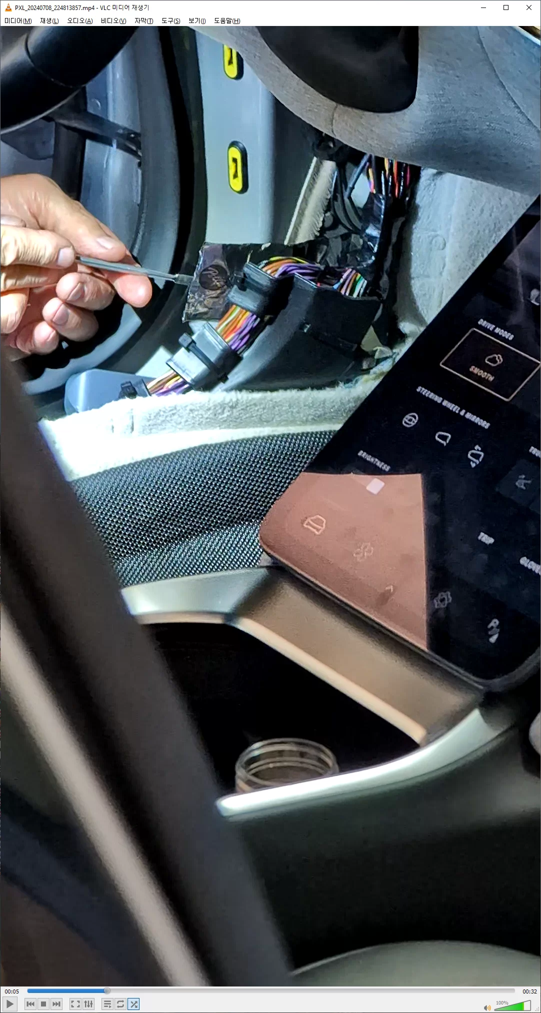

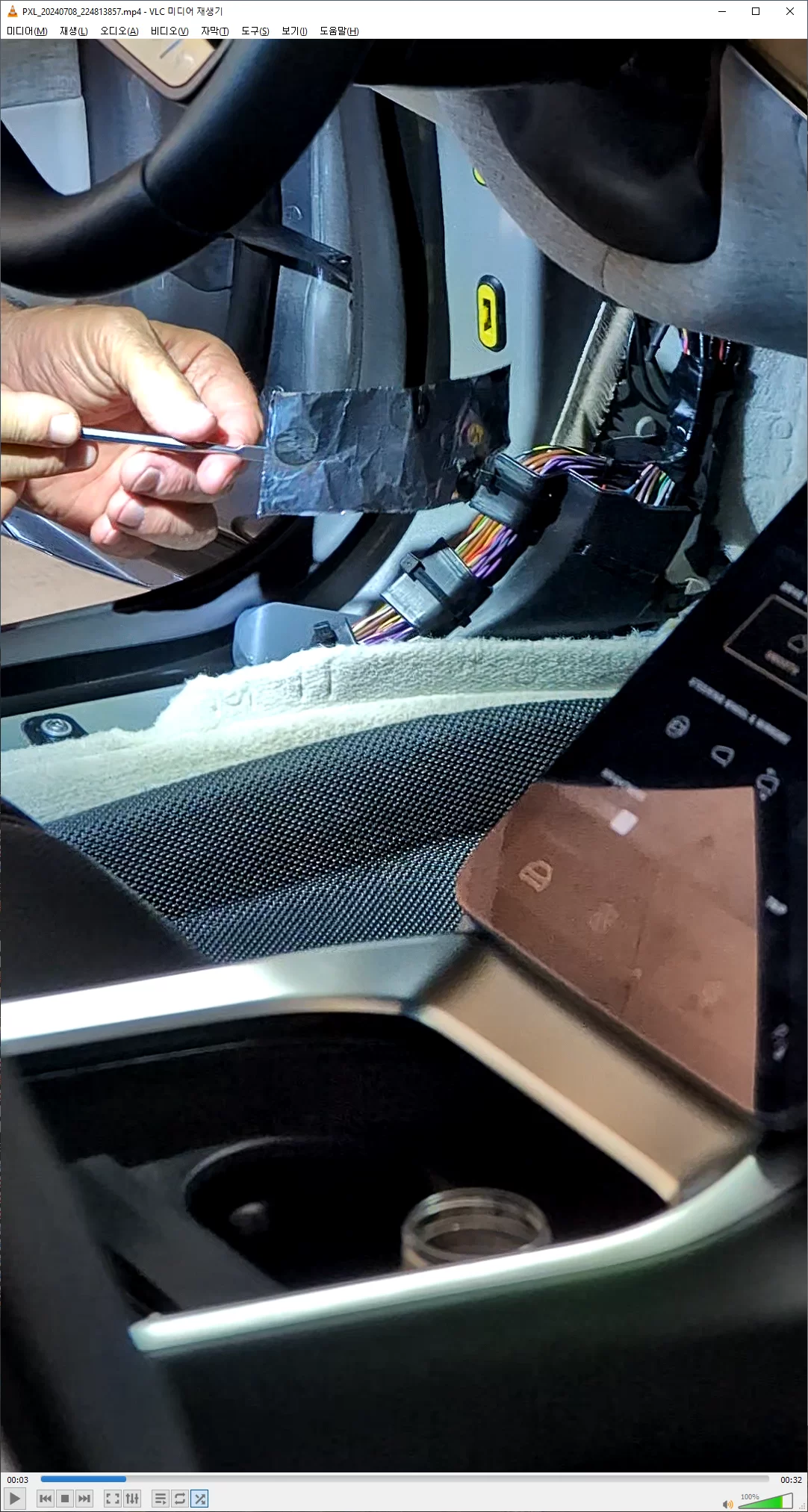

Video screenshots of Frank inserting the Pella tape:
I was going crazy with that "muddy" vibration; I thought the speaker was blown or something.
But yea.. I never imagined how a simple Pella tape was going to resolve that bad woofer sound.
I had the mobile service done for the front driver and passenger seat woofers.
Other good music to test to see if your speakers play the beat like a ghetto street car that blasts music with an ominous "thud" sound...
Groove Armada - Edge Hill; SZA - Kill Bill; Rinocerose - Le Mobilier; Gabin - Doo Uap, Doo Uap, Doo Uap
If your speakers don't deliver a deep clean base, then yea.. call for mobile service.

The way I observed it...
Removing/detaching the panel and rubber seemed easy enough...
But "sliding" in the adhesive tape carefully to a very slim space + knowing exactly where to tape (over the existing tape?) + end-extent...
I'd at least consult with the technician.
More recorded screenshot if you want to give it a try,
