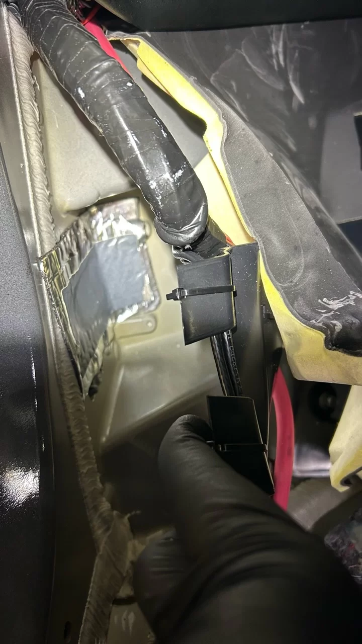

Question.. How difficult is it to remove the panels to get access to cover up the 2 holes…The Earliest my center center can do the repair is next month..I was thinking on doing it myself…Update: Success!
Service (Frank) was at my house today to fix the problem with the woofer in the footwell on the driver side. I previously called in a subwoofer, but he corrected me… It is a woofer. Anyhow, the woofer sounded like it was "blown" from the beginning, so he brought a new speaker with him. The best way to demonstrate it is with the song "Need You Tonight" by INXS, move it the 1:00 minute mark and stick your head down inside of the car next to the dead pedal. Shouldn't hear muddy vibrations on the kick drum.
Since the time that I originally discovered the problem, more knowledge has been gained about it. It turns out it's not the speaker at all. Behind the footwell carpet is aluminum body and in it, two 1 inch holes. These holes are covered by a piece of tape that looks like duct tape, about 4" x 2". It turns out it was that very tape that would vibrate and cause the sound of distortion. Frank removed that tape and replaced it with some foil backed butyl tape (Pella window tape to be specific). Voilà, the problem was instantly gone. The sound system sounds amazing now. While he was at it, he also did the passenger football which had some of the same problem, but not as pronounced. So happy with the sound system now!
While we were at it, he worked on the steering wheel to get rid of the creaking plastic to plastic sound. He took it off and apart (beat that, Tesla, even cooler than your dorky yoke), then put foam spacers at each of the four screws that hold it together from the back. A couple squirts of WD-40 dry lube, and the problem is gone forever!
We are blessed to have Frank here, he's patient and helpful. Thanks, Lucid. Love my GT!

Any difference in sound?Went ahead and got a buddy to pull the panel and seal the 2 holes causing the front speaker to bottom out….Such a simple fix….
Huge difference…..I can play my music loud with the bass set at 0 instead of -6db….No more bottoming out….I still plan to do a full system upgrade next month….Any difference in sound?

After the fix sir…I think the factory tape they use to block the 2 holes is just too thin …Is this photo before the fix? My system sounds pretty good, but I am curious if the system would sound even better after the fix. My mobile tech told me he couldn’t do it for me.
