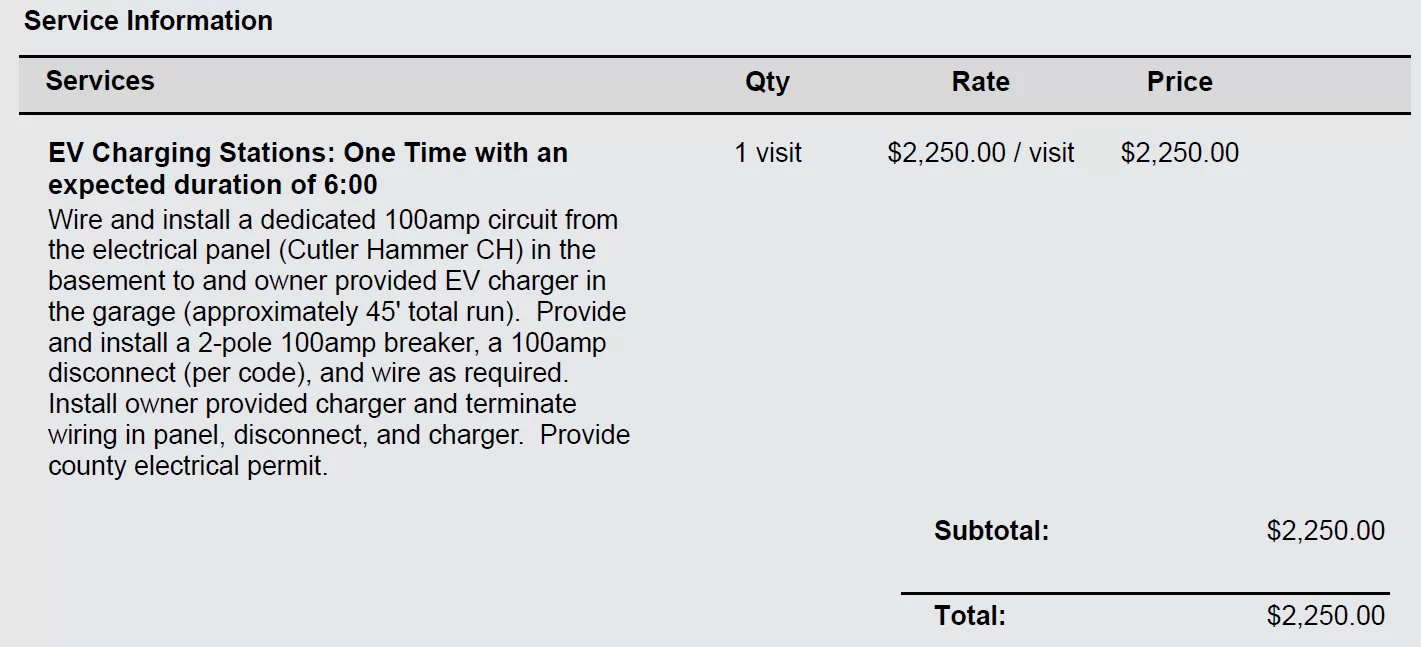

Does this look suspiciously high?4.5k to install a charger? I've seen much lower quotes for Qmerit or is this the price to install the 100AMP charger?
For your reference, mine was also QMerit assigned contractor. $2200 work for my area of Houston, Texas. My circuit breakers panel was 200amp, no more open slot, electrician has to merge 4 other breakers to put in 60amp breaker and extend about 30 feet hardwire to install my 48amp WallBox. 1 month later, Lucid introduced their 80amp charger. But I am very happy with WallBox for now. I can get most of my charging done under 5 hours. I don’t see the need to go under 3 hours.
Initially, I thought bi-directional charge is a very cool idea. But then think further further, do I really want to use EV as power source for the house? So if I unplug the car to go do grocery, my house go black out? I just think practical application is limited.
This appears to be high if the distance from your panel to the charger is less than 40'. I would get a couple of quotes. Also you want the electrician to meet with the inspector. It will costs more but you don't want to be in the middle if the inspector finds an issue that needs to be fixed.
For what it's worth, I have a 200amp panel & Qmerit wanted $4.5 to install a 100amp line, run about 8 feet from my panel, for my Lucid charger. Another electrician I found charged me $1,600 all in, including permits. I'm in Delaware near Lewes, probably a less expensive area than Houston & some others. Hope this helps.
This QMerit charges are crazy! I've found an Electrical company that gave a guestimate of $400-$1250 for everything including permits, they will come next week for onsite visit. I've also heard of Qmerit charging some people as little as $800. btw Lewes is a nice city, so maybe they bill based on that?
I paid 650$ for install . I had space in my panel so I needed the 100 amp breaker and a short wiring run. Maybe 5 feet. I'm in TX.

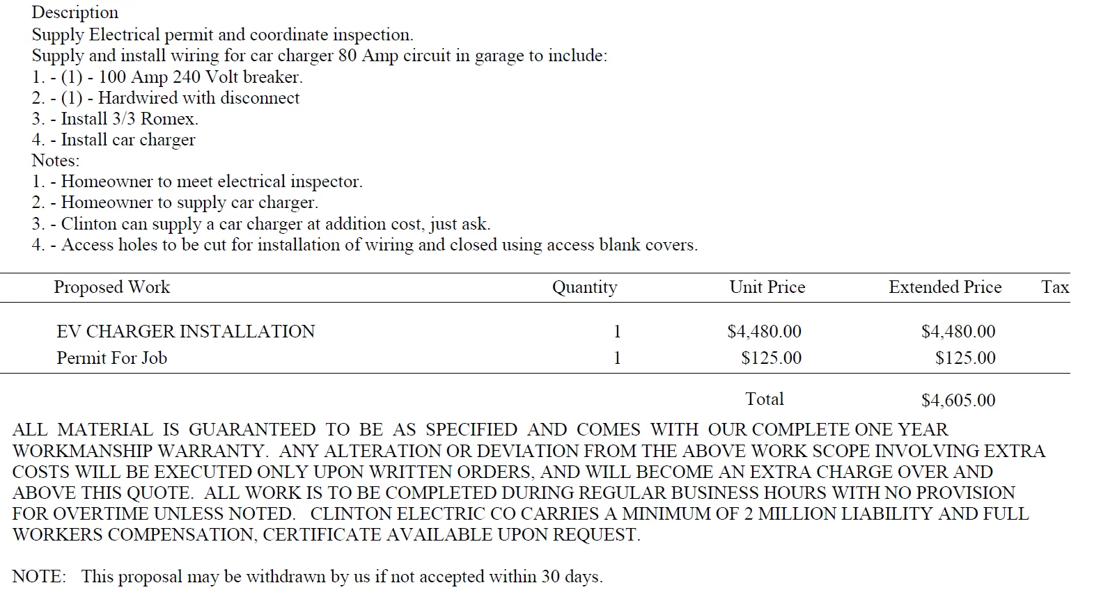

Second quote (non Qmerit) is a lot better. Still waiting on two others (another from Qmerit and non Qmerit), although I'm tending towards this one.
And I opted for the 100amp mainly because its available... probably some future proofing too, if I eventually have to share one charger with two cars.
Your quote seems reasonable.
My invoice for installing my Lucid Connected Home Charging Station was $2090 and that included $650 for city permit. I paid just over $1300 for the LCHCS from Lucid, so my total was around $3400. Fortunately that qualified me for the tax credit rebate of $1000 so my out of pocket cost was $2400. Not sure how much more I will have to pay to retrofit the system once the bi-directional capability becomes available, but I suspect the overall cost will be significantly less than adding a generator or battery backups.
Great! I feel a lot better with this pricing.

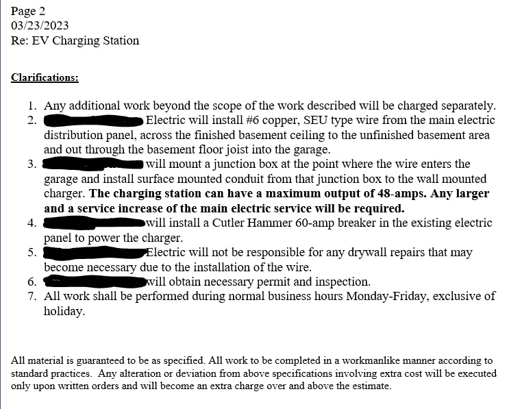

Received the second QMerit quote at $1305 but maximum they can do is 60amps.
I will confirm what the cost implications will be to step up to 100amps... I may have to return the Lucid charger and go with a 60amp.
Thanks to the people here who recommended getting multiple quotes.... hoping my last quote will be half of this... since every quote has reduced by 50% 😏
1305 for 60amp seems good deal, at least better than my 2200 at 60amp.
I finally did this for $875 for 60amps. From a reputable company - It pays to get multiple quotes
