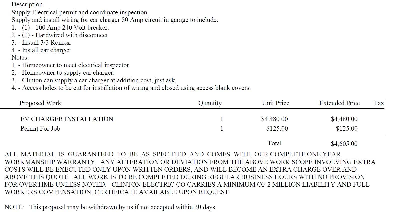

Does this look suspiciously high?4.5k to install a charger? I've seen much lower quotes for Qmerit or is this the price to install the 100AMP charger?
I'm guessing that the installation costs vary by area, difficulty (and length) of electrical wiring, etc. .. but it does seem pretty expensive (I think I paid ~10% of that for my Chargepoint installation last year)
Do you really need 100 Amp to charge your car overnight? I would get another quote.
Yes I think its crazy too, my panel is just above my garage so I don't believe its the length. I also have my generator wired from my garage right beside the panel, which is probably about 20-30ft of wire run. I will probably look for a third party
It's always a good idea to get a few quotes. Beyond any price differences, it's useful to hear the thoughts and ideas of three individuals on the best installation.
