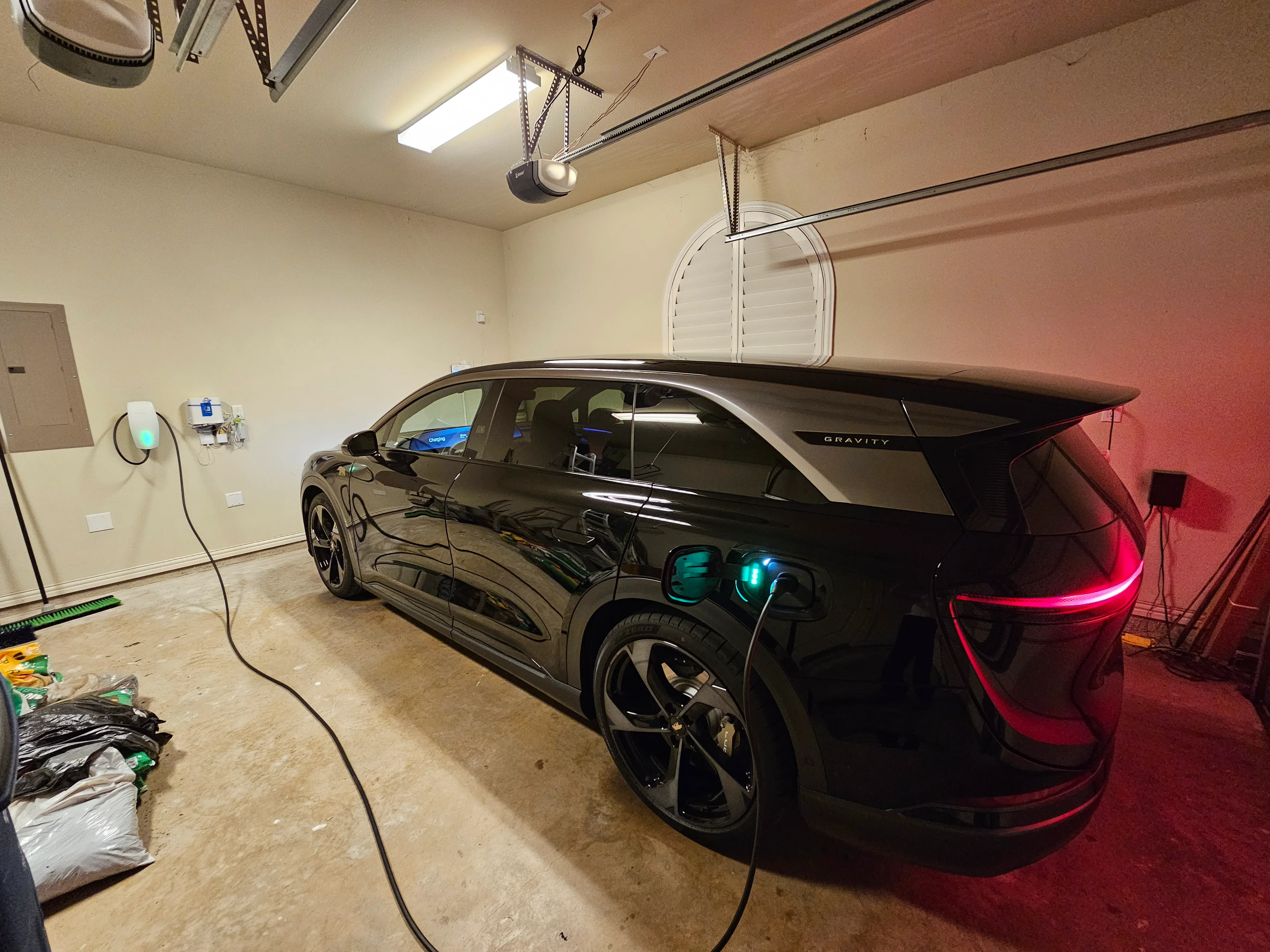

I had my first brief charging session last night (finally got below 80%--the car was delivered to me at 100%) and can confirm that my newly installed Tesla Universal Charger worked perfectly to charge my DE from 78% to 80%! It started charging instantly and at the max rate of that EVSE (48A/11-12kW). I figured I'd add pics and videos for everyone's viewing pleasure. It has quite a light show while charging!
That's really cool but, uh, can you turn it off? I'm not sure I really need a nuisance in my driveway when I'm charging at night...
The light display turns off automatically after less than a minute.

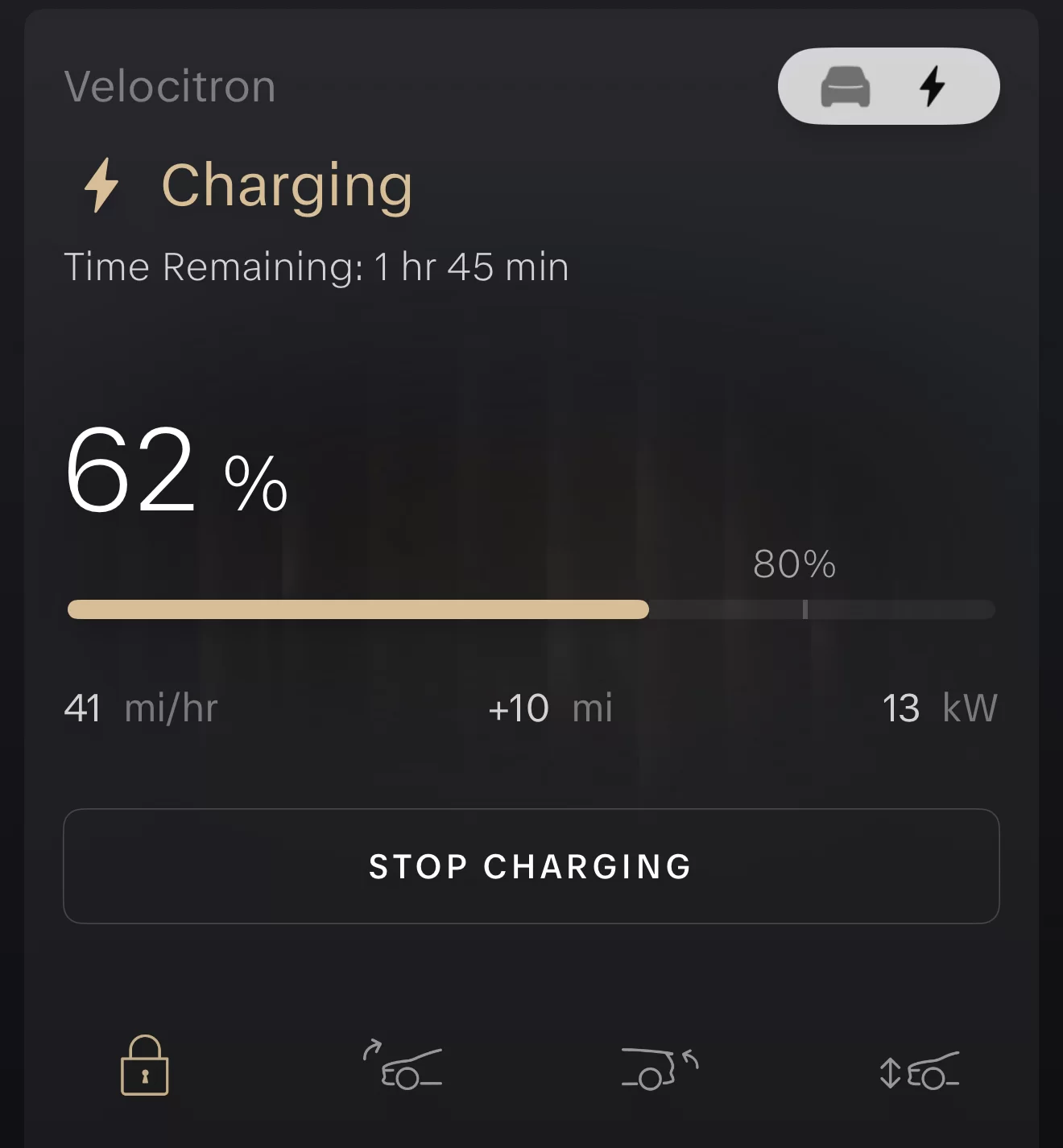

Thank you again for sharing information on the Tesla Gen 2 Wall Charger settings. Today was my first opportunity to tackle this project since taking delivery of my Gravity Dream Edition last week. Super easy. In fact the most difficult part was locating a Torx 20 Security bit for my screwdriver so I could get to the settings inside the Tesla Wall Charger -- a quick run to the hardware store and $2.17 for the bit had me in business. I, too have a 100amp circuit, and adjusted the output on the charger to 56A and voila 🎉 Worked!
I'm even more tickled that I'm adding more MPH on my Gravity than I ever did on my (now departed) Model X Plaid. Best I could get with the Plaid using the wall charger was ~30MPH. I'm pulling 41MPH with the gravity. That could have more to do with the efficiency (and range) of the Gravity calculation.

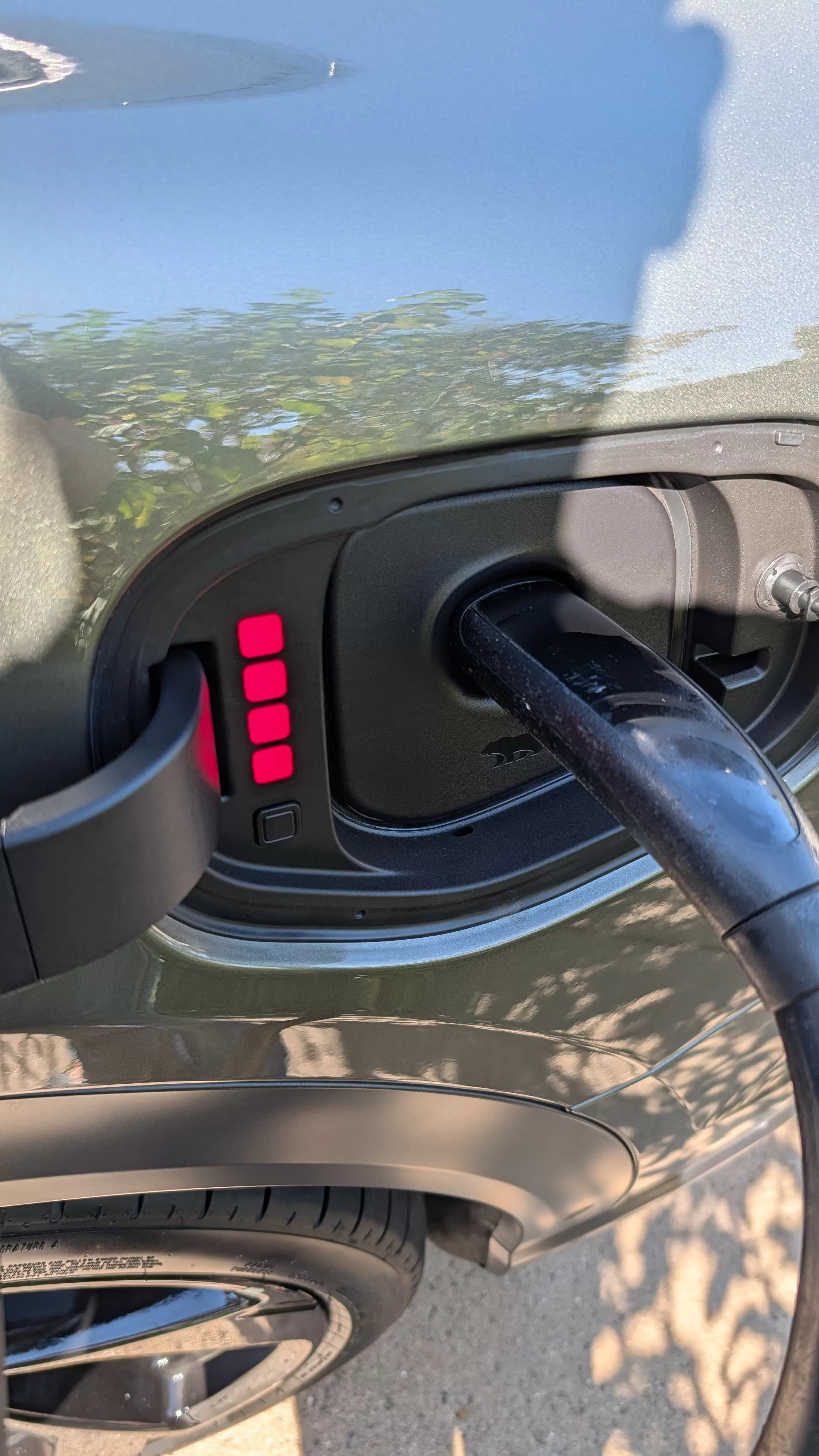

Went to a V3 supercharger, plug connector in, charges for like 2 seconds, then stopped. Screen says require an extra step, I’m not sure what that extra step is. I thought everything is plug and charge. Will ping my SA tomorrow and see.
Testing @ home. Tesla gen 2 wall charger. 100amp circuit. Wall charger charges my 3 other Teslas fine. Charges the Porsche Taycan fine with J1777 adaptor. Plug into Gravity, no clicks, charge cable does not lock (just like when @ v3 Supercharger). Starts flashing red LEDs, screen says problem charging, try replacing. Tesla wall charger flashing red LED. Unplug (again, not locked). Few seconds later, Tesla wall charger goes to GREEN status. Decided to just plug in my Tesla EVSE, I have an 14-50 outlet coming out of the same circuit (for occasions just like this, pad in the back for thinking ahead). Plug into Gravity, I hear cable lock, then starts charging. Get about 9-10kW out of the EVSE, I usually get 11kW out of the wall charger, but that’s fine.

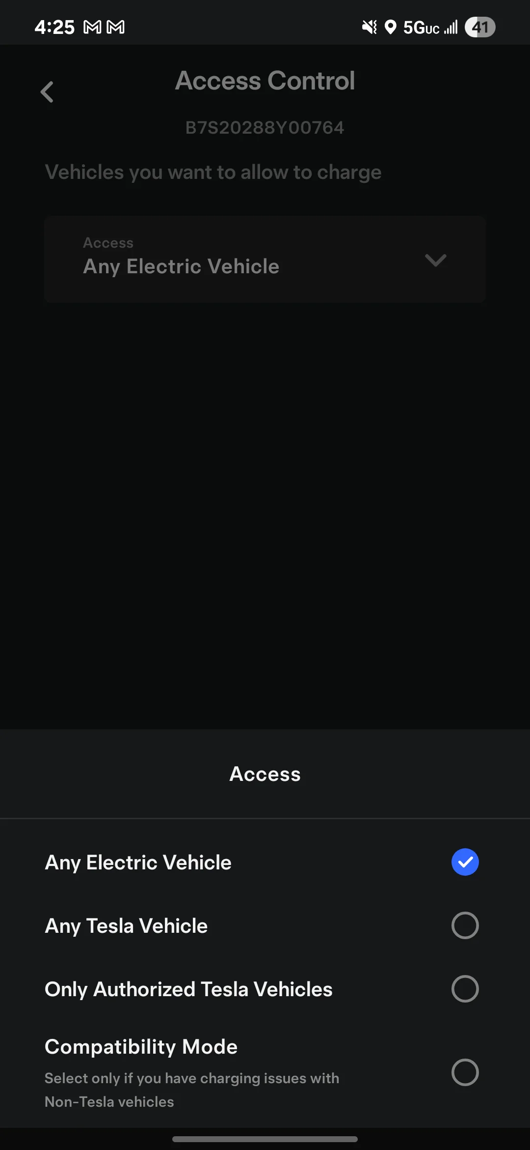

Regarding your home charger, did you configure it to allow non-tesla vehicles to charge on it? You have to use the Tesla app and change it if it isn't already.
Older Gen2 have DIP switches to change that. But I didn't have to. Work on Tesla mode. I like, and prefer to keep the older Gen2s because it can do 100amps, the new ones are max out at 48As.
Just to clarify, you have to use the “Tesla One” app. This is a separate app from the regular “Tesla” app.
Nope, I can do it using the regular Tesla app. Maybe you can do it through both.
