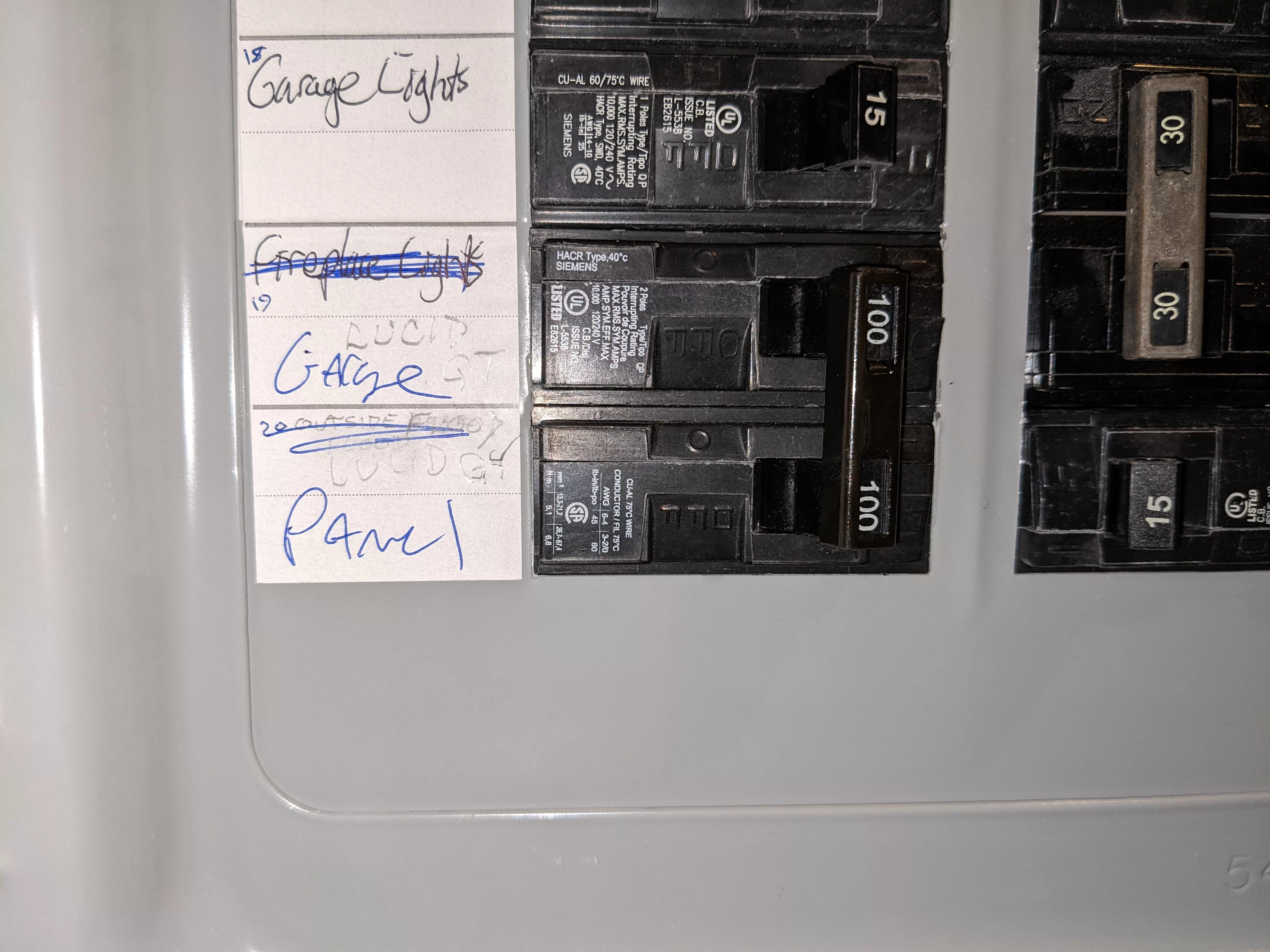

Well I did hire a professional of some (local) repute, and told him I had ordered an 80 amp EV charger ( Lucid Connected Home Charging Station) that required an 100 amp hardwire line. I also told him I wanted to "future proof" the garage because the charger was bi-directional. He'd never heard of Lucid but I saw him look it up on the website. It cost me over $5000. I had the installation inspected by the municipality's hired gun and he approved the work.
I just went to check and see what he put in. 4 AWG.
This is why I should never trust a pro. This is why I usually do things myself.
Now what...

Ask warrantee redo. #4, and 75 deg breaker (likely what you have) has ampacity 85 A. Next size breaker is allowed by code. This size is 90 A. If he set up the charger at 80 A, and your breaker is a 80 % breaker (very likely what you have), 125 % amp breaker is needed. This is 100 A breaker. The installation is an NEC violation. You could call the city inspector for your permit to verify all facts are ok.

Ouch! Now I feel doubly bad. Can you ask the inspector on what basis did he/she accept #4AWG on a 100-amp circuit?
Again, the "hired gun" township inspector barely looked behind the sub- panel. When he confirmed who did the work he pretty much signed the forms and gave me a sticker. Never looked at the main panel or the cable spec. to the garage sub-panel. The work order states "install 100 amp copper line to garage" but does not itemize or state the cable size/rating. I deliberately did not hover around or ask questions while the electrician worked. I did not think it would be necessary to explain how a car charger works, and I thought "100 amp cable to support 80 amps continuous 30 meters away" was enough clarity for a lay person talking to a professional. I was not aware that there are (at least) 4 cable sizes that are considered "100 amp", so I did not see my error in not itemizing and specifying what cable I wanted. I thought that was the reason you hired a pro. I was wrong, and I did not know that the inspector just approves any work done by an established company without even looking.

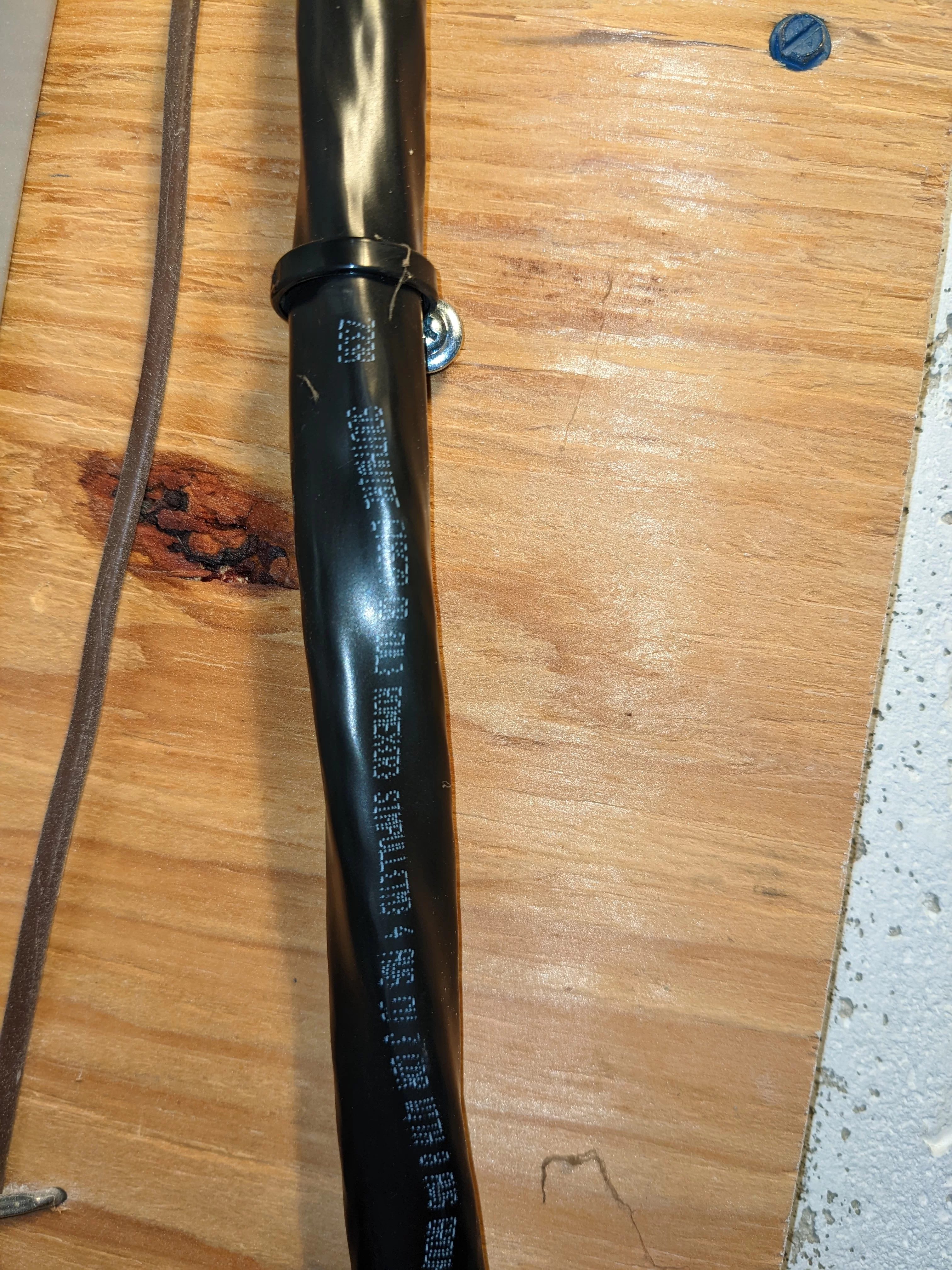

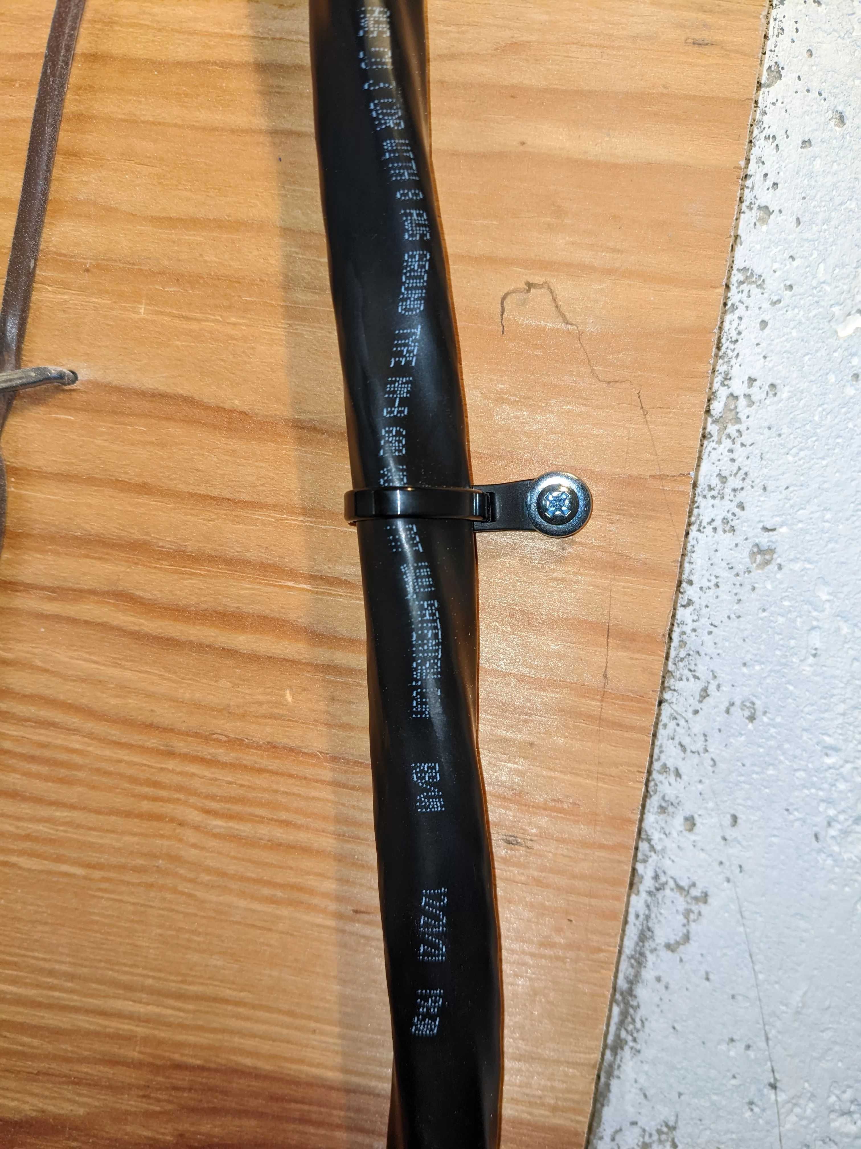

This may vary by location, but where I live, exposed wiring must be in conduit of one type or another.

Your contractor installed #4 Romex which is equivalent to NM-B, rated at 70A. Now, you have to downgrade that by 20% which leaves you at 56 amps. Find the setting that is the closest LOWER number on the Lucid charger. You're not done yet. The #4 Romex wired to a 100A breaker violates the electrical code. You need to replace that with a 70A (or lower number) breaker to meet code.
If your space is still exposed and you want maximum juice from your Lucid charger, you need to replace the #4 Romex with #3 THW or equivalent. I believe they need to be in conduit but not sure, probably depends on your local power company or codes. The ground wire can be a smaller size. The #3 will handle 100A and exactly matches your 100A breaker. That will provide 80 amps to your Lucid charger.

You weren't wrong at all. When a non-electrical person says 100 A wire, he/she means the load needs 100 A CB -- a 100 A circuit. (There's no such thing as a xxx A wire but dependent on the wire and its installation conditions and NEC.) The electrician is then to verify load nameplate -- Full Load Amperes. Let's say it says 80 A. The electrician is now to determine whether it's continuous (more than 3 hours) or non-continuous load. Since the charging will frequently take more than 3 hours, it's continuous load. Now, due to continuous and by NEC, you must do 80 A x 125 % = 100 A circuit. The CB and cable (and whatever else you have) must have 100 A rating.
The cable in your photo is NM-B. It's rated to 90°C (before insulation gets damaged). Per NEC, such a cable has 95 A ampacity. Per NEC you may use next size up CB, which is 100 A, given the CB is rated for 90°C. The CB in your photo is only rated for 75°C (and by far the most typical; 90°C CBs are very unusual). Thus, you need to use the lowest rating of the cable and CB. And this is 75°C. Your cable and for 75°C has ampacity 85 A. Next size up CB is allowed. This is 90 A. Thus, your installation is a NEC violation. The aforementioned is based on cable ambient max 30°. For higher ambient derating applies. For example, if you expect 108°F (for example, at the ceiling in the summer), the derating is 0.87 x 95 A = 83 A. Thus, max 90 A CB is allowed. One day per year heat 30°+C wave wouldn't necessitate derating; however, a few weeks per year of 30°+C would. The language is: likely, frequently, decently long continuous duration, etc. to occur.
Since a charger may draw the 80 A for hours at end, the next size up CB is not a good practice albeit allowed by NEC due to thermal heat buildup that may affect lifetime. A good gauge for 80 A continuous load with 100 CB is #3 (given max 30°C ambient), which is less commonly available, and next size #2 is often used instead. As an extra plus, #2 is now also rated for 108°C ambient.
To be NEC compliant for your present installation, you'd need to replace the CB to 90 A (given max 30°C ambient) and set the dip switches to 72 A or less. As not to use the next size up CB, I'd replace the CB to 80 A (given max 30°C ambient) and the dip switch to 64 A or less -- I'd do this if it were my house. This way you'd not promote long term meltdown at the lugs of the CB or charger or for the very worst causing a fire.

What I did find in the Lucid (install)Guide that comes with the home charger is " rating: 90 degree copper wire". Elsewhere ( I read or saw a reference to 2 AWG, but can't find it now. Had I known this was the spec I would have specified it in the work order. I just thought that was the electrician's job.
Nice to find there are many sloppy ways to avoid using the proper terminology. You can use "amps" or "temperature" or just say, "hire an electrician" and blindly trust them to pick the correct wire. Nobody will check. Or, if you want to be safe, do your own research and post here for confirmation. The more I look the worse it gets. I thought I'd be good lowering the DIP switches, but according to the chart below I'd have to lower the amperage to fourth level down from max.
Your electrician should have gotten this right. I would force him to come back out and fix it.
Are you sure? All the ampacity charts I've seen says NM-B is rated at 60 degrees. My eyes aren't that good anymore but I can't see the temperature rating on the NM-B cable on Cosmo Cruz's pics.
You could be right, but I assumed 90°C. Yes, for 60 °C that column needs to be used in the screenshot. I just looked up a typical NM-B up online and got 90°C. Cable part # and then data sheet would be needed to be absolutely sure or if printed on cable. I believe it used to be 60°C for (older) NM-B. See screenshot for Ampacity for redlined AWGs and temps and copper cable. Ampacity isn't to be confused with circuit ampere or CB ampere rating. Ampacity (for non-electrical people) can be viewed as maximum current the cable can carry under "ideal" installation conditions. Ampacity gives a hint of "maximum possible". Typical Ampacity deratings are ambient temp (above 30°C), number of current carrying wires in cable/conduit/raceway, installation on top of roof in direct sunlight, etc. Voltage drop for long runs is another consideration but typically not needed for 240 V and within a normal house size.
For a continuous load such as a charger, the CB need to be at least 125 % ampere larger than the Full Load Amperes as per charger nameplate. And now (a derated) Ampacity needs to be matched (exceed) that of the CB rating." Also, CB temp rating needs to be considered as per my previous post.
