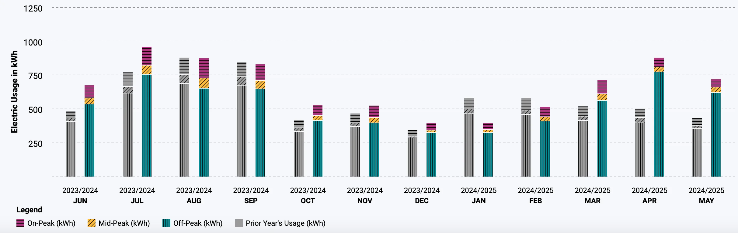

Thanks, I just took the kwh of the screen, so I know what the car used. It is just such a huge coincidence that my off peak usage went up so dramatically once I started charging the EV. Bill below goes from middle of the month, so March 2025 is the first bill with the EV. I came home with 95% charge and had it at service where I received another 35kwh. If I add this to the March consumption it will increase to over 800 kwh, like April.
