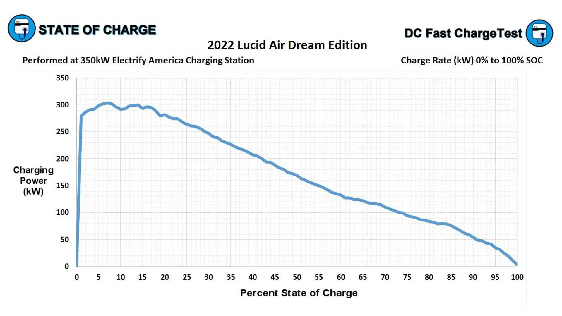

- I have charged at EA fast chargers 5 times (Salem NH, Manchester NH, Nashua NH). If the EA charger is working (sometimes the EA screen on the charger is dead, but the charger still works), my experience has been acceptable. It seems the EA charger kWh correlates to how low the car is - the most I have gotten from an EA charger is 90 kWh when I was at 65% and charging to 80%. Over that charging session, the kWh dropped to 55 kWh by the end of my charging session. Other drivers I have met at EA chargers (non Lucid) seem to confirm this hypothesis that the EA charger output is correlated to the % charge the car is at when plugging in. I saw chatter on a thread someplace that seemed to indicate either (a) the electrical infrastructure or (b) the EA charger cooling, is why the EA charger throttles itself.

Its a matter of keeping the battery healthy, the charge rate has to slow at a higher state of charge so that individual battery cells do not see too much voltage. Here is a charging curve for the Lcuid.
Worth nothing that every EV does this and has a very roughly similar changing curve, with varying shape and much different charging rate (kW) levels.
