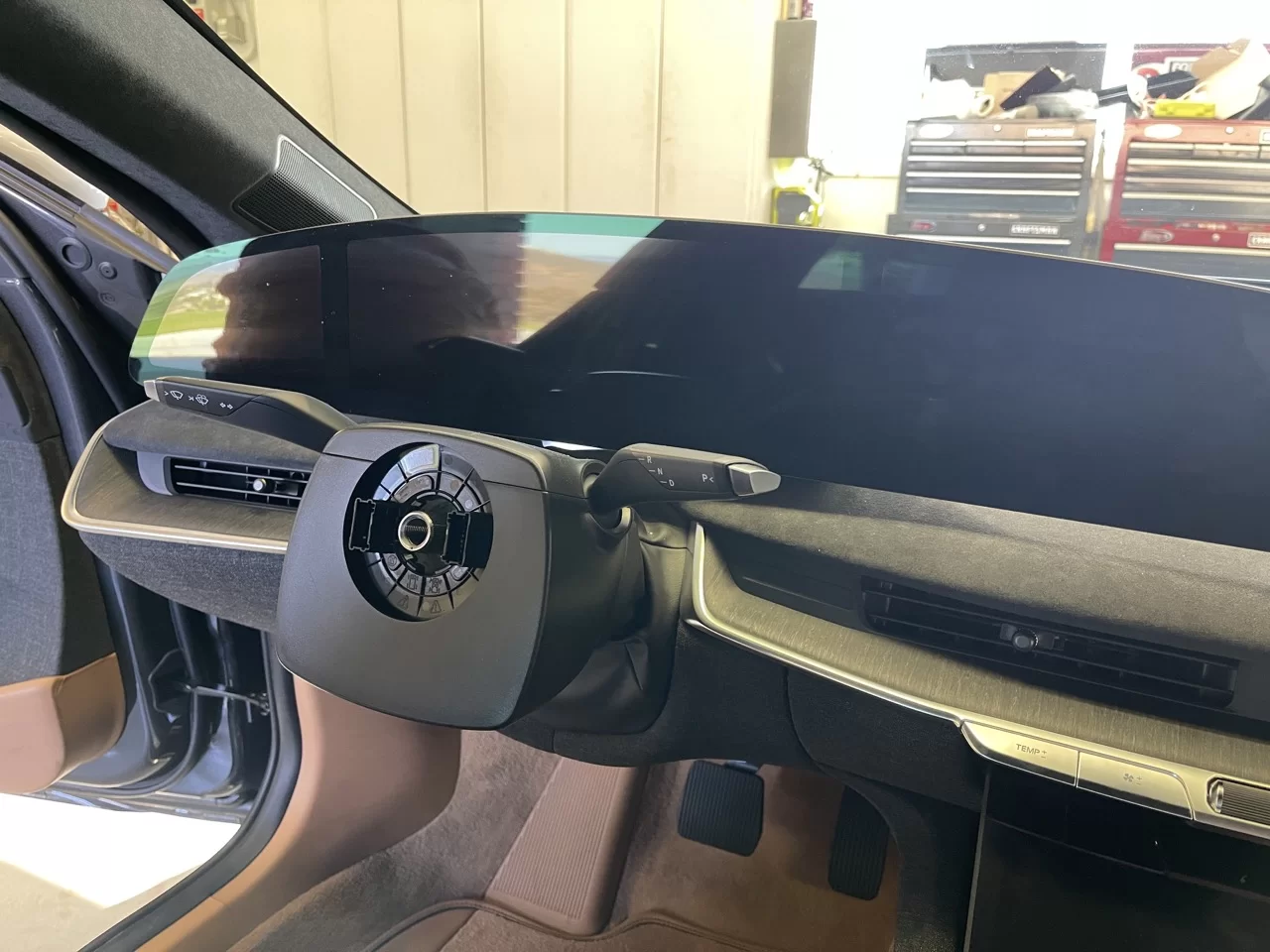

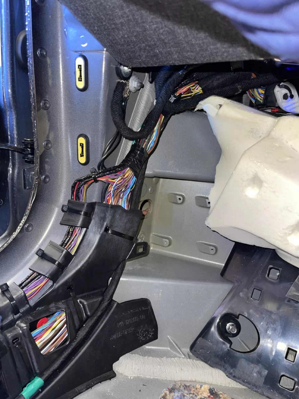

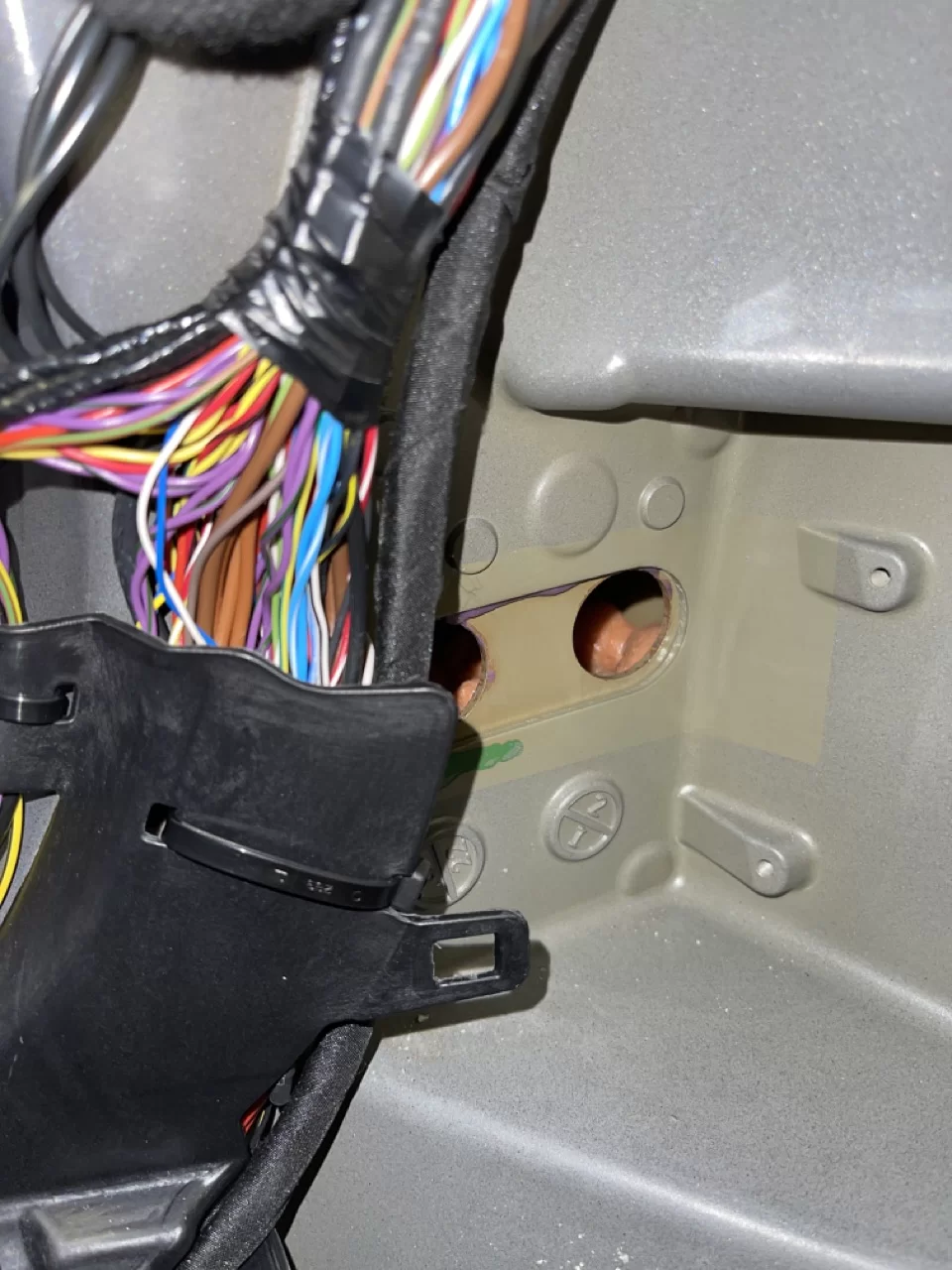

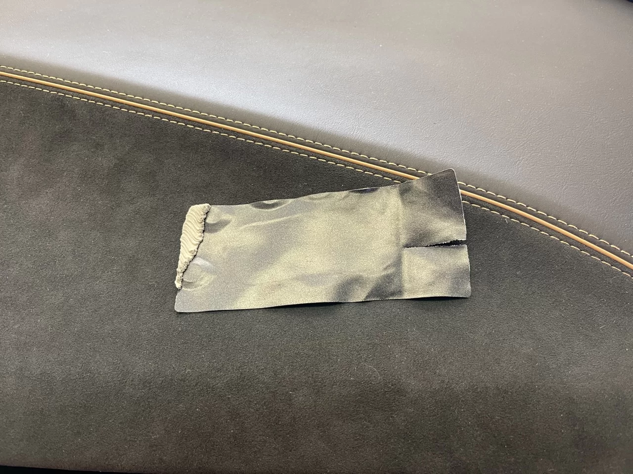

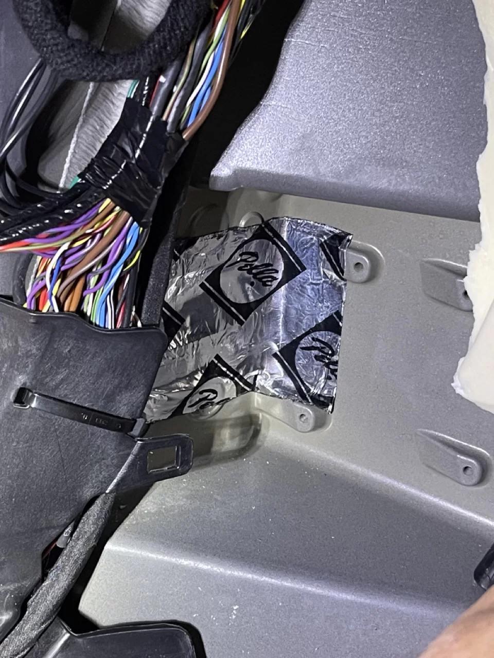

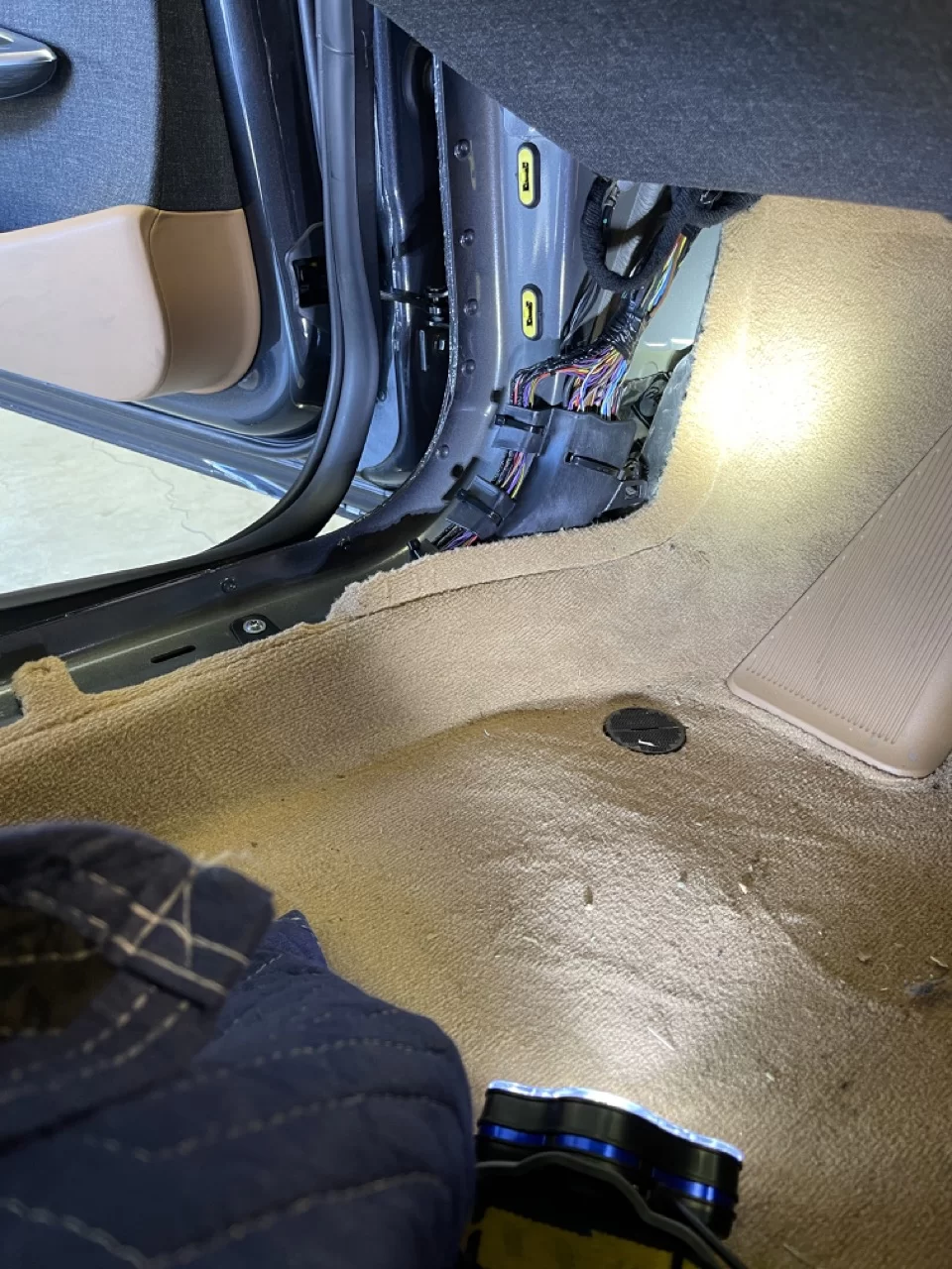

Update: Success!
Service (Frank) was at my house today to fix the problem with the woofer in the footwell on the driver side. I previously called in a subwoofer, but he corrected me… It is a woofer. Anyhow, the woofer sounded like it was "blown" from the beginning, so he brought a new speaker with him. The best way to demonstrate it is with the song "Need You Tonight" by INXS, move it the 1:00 minute mark and stick your head down inside of the car next to the dead pedal. Shouldn't hear muddy vibrations on the kick drum.
Since the time that I originally discovered the problem, more knowledge has been gained about it. It turns out it's not the speaker at all. Behind the footwell carpet is aluminum body and in it, two 1 inch holes. These holes are covered by a piece of tape that looks like duct tape, about 4" x 2". It turns out it was that very tape that would vibrate and cause the sound of distortion. Frank removed that tape and replaced it with some foil backed butyl tape (Pella window tape to be specific). Voilà, the problem was instantly gone. The sound system sounds amazing now. While he was at it, he also did the passenger football which had some of the same problem, but not as pronounced. So happy with the sound system now!
While we were at it, he worked on the steering wheel to get rid of the creaking plastic to plastic sound. He took it off and apart (beat that, Tesla, even cooler than your dorky yoke), then put foam spacers at each of the four screws that hold it together from the back. A couple squirts of WD-40 dry lube, and the problem is gone forever!
We are blessed to have Frank here, he's patient and helpful. Thanks, Lucid. Love my GT!

View attachment 7596View attachment 7597View attachment 7598View attachment 7599View attachment 7600View attachment 7601
Oh, I love the picture where the steering wheel is removed. Imagine driving using those two handles! Now there's an idea along the lines of Tesla's yoke.
Makes the screen look immense!
