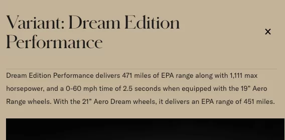

Typically due to battery degradation, an EV loses approximately 2% of range each year during the first 3-4 years prior to leveling off. It is sad to hear that @hydbob stated range at 100% charge currently is 445 when his Dream Performance is rated for 471. His degree of range loss is well beyond that which would be expected. During the first year, his range should not drop much below 460.

Further investigation would seem to be in the best interest of all owners (present and future). For this reason, I would like to initiate a SURVEY OF ALL CURRENT OWNERS. Please answer the following questions:
1. Type of car (Dream Performance, Dream Range, or Grand Touring)
2. Tire size (suggested by @hydbob)
3. Current mileage
4. Stated range when your car is charged to 100%.
If this reveals no problem, then GREAT! If multiple owners reveal significant range loss, then it would seem prudent to have the vehicles inspected at a service center. If would be really interesting to discover if @hydbob battery in his Dream still demonstrates 118KW. If not, cells have gone "dark" prematurely. If the battery still registers 118KW, then the software needs to be updated.
