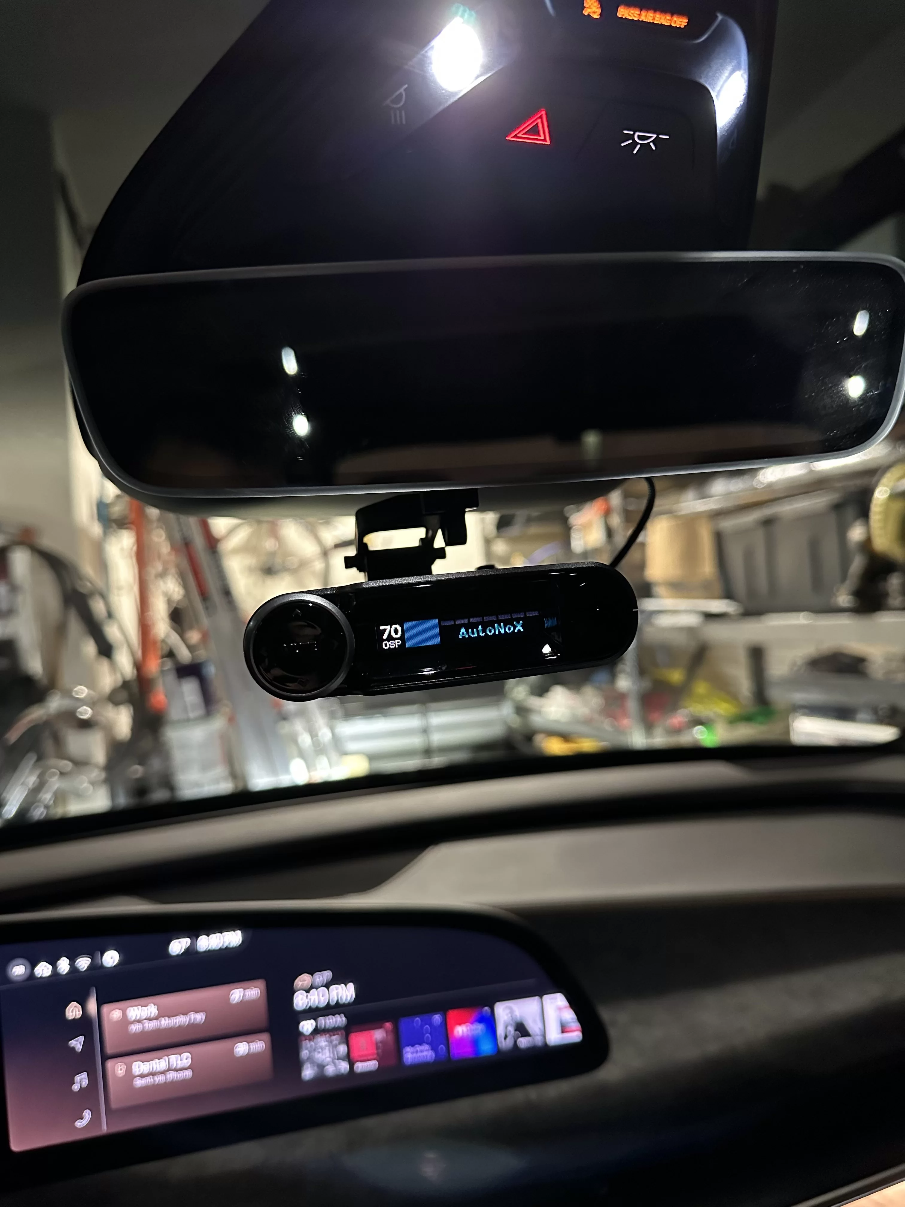

For the tap - yes, I did the mirror tap. The toughest part was determining how the upper pieces clip into place, but once that is figured out, it's all downhill if you know what you're doing. You want to look at the green/white clip, and probe with a voltage meter. Cars can and do change, particularly/probably in a small production car, such Lucids... so always keep in mind that you're doing this at your own risk!
Here is where I have the mirrortap connected. IIRC, the MT I used with the 360 was the MT-4015, and the Blendtech mount I used as the BMG-3014, although one of the set screws that comes with it has to be opened up almost to the last thread, so it's a tight squeeze. Someone in a DM suggested picking up a longer bolt from Home Depot for less than a dollar, and it worked like a charm. The rearview mirror post is just a funky size and can be a bit odd to mount to.
