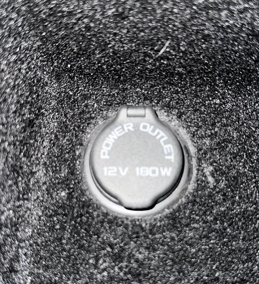

Are you talking about a portable detector that you want to hard wire or a permanent concealed installation?
If the latter, my installer found that the best power pickup point was off this power outlet (under the cover to the right of the trunk lower storage bay cover). He said this was the only power tap that was switched to power down fully with the car:
ok understood yes this is the only 12v connection in the lucid air unfortunately its in the trunk, are they connecting it there or to the fuse box under the glove box directly at the source?
I don't remember the details, but he connected to the wire feeding the trunk outlet. There was some reason he didn't use the fusebox, but I don't remember what it was. Since there were rear radar antennas and rear laser detectors, he was running wiring to the back of the car, anyway.
I’ve had the GT with and escort 360, for 2.5 yrs now, But I bought 20 foot extension cable, plugged it into rear lighter switch and ran it under plastic pieces to front of car, it does turn off after leaving vehicle.
is it better to keep it on? do you turn it off manually to not drain the battery though?
If you plug it into rear lighter, it automatically shuts down when car closes.
