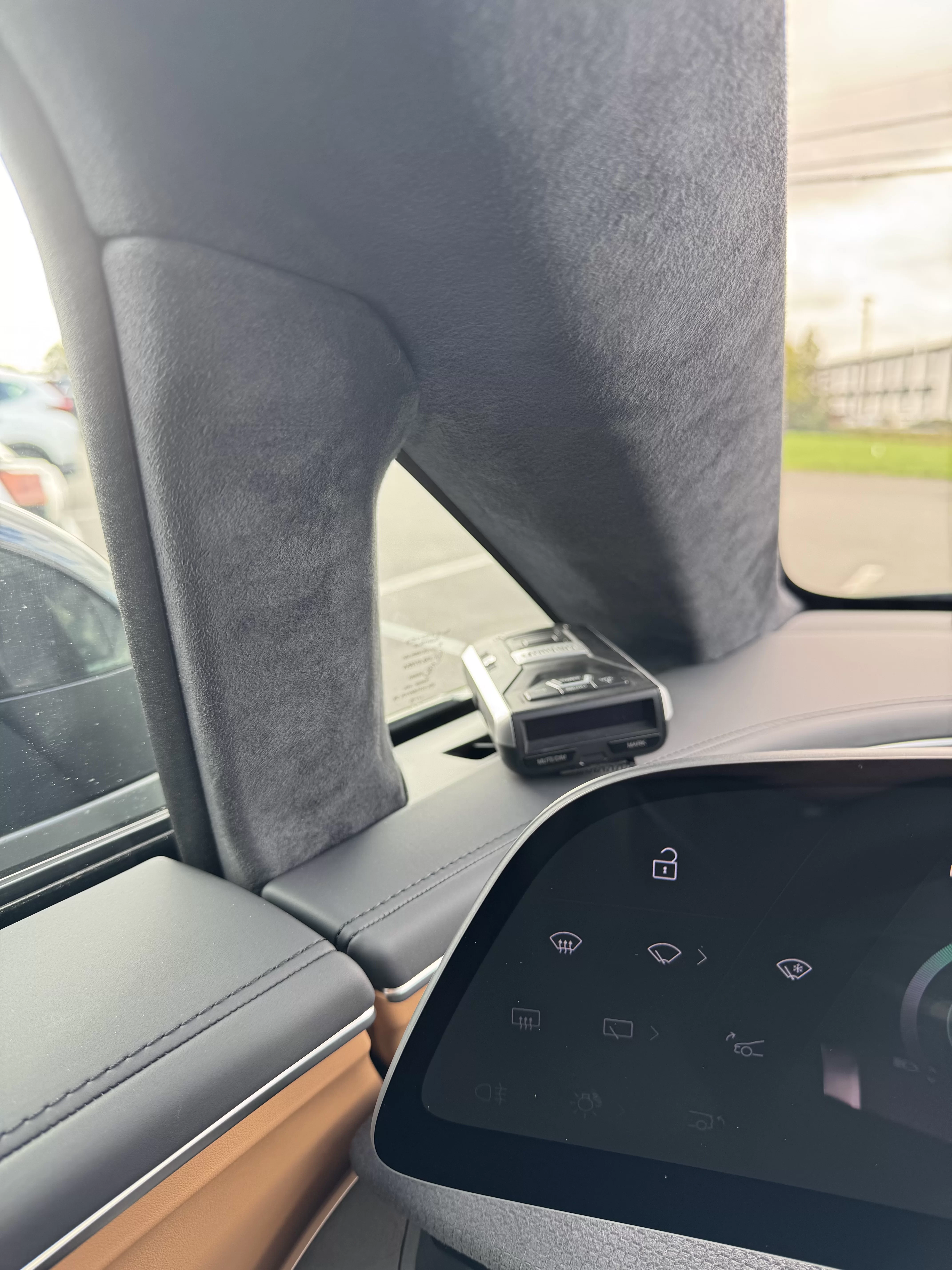

Thanks that’s helpful, in direct sunlight I was able to see where there’s a gap in the window tint but yeah sadly only that tiny spot like you had shown. So my EZPass can go there ok. I was gonna try my old Uniden in this location in the pic, but the thing is completely broken, I tried it in both Gravity USB jacks with the 12v adapter and confirmed power cuz it will charge my phone but the Uniden is dead so now I can’t test it. If it’s not too much trouble could you try your R8 in the position in my picture and see if it works? If so then I’ll get an R8, otherwise I guess just use Waze to alert me of the cops but that’s not very reliable in my experience.
Thanks that’s helpful, in direct sunlight I was able to see where there’s a gap in the window tint but yeah sadly only that tiny spot like you had shown. So my EZPass can go there ok. I was gonna try my old Uniden in this location in the pic, but the thing is completely broken, I tried it in both Gravity USB jacks with the 12v adapter and confirmed power cuz it will charge my phone but the Uniden is dead so now I can’t test it. If it’s not too much trouble could you try your R8 in the position in my picture and see if it works? If so then I’ll get an R8, otherwise I guess just use Waze to alert me of the cops but that’s not very reliable in my experience. View attachment 33339
So, to answer your question about putting the detector in that spot: Yes, it will work there... in fact, it will work anywhere in the front window. When I originally mounted it in the center of the windshield below the mirror, it was working adequately (albeit it was only showing me backwards arrows which is how I knew the front window was blocking radar). That being said, the detector is still able to pick up radar signals (presumably coming in through the side windows and/or roof). As the R8 is an excellent detector overall, it still provided decent detection range even with the front antenna blocked by the window--enough so to pick up radar signals with time to spare. Outside of the tint cutout, the range (and directionality function) are definitely reduced but THIS detector is still reasonably effective. I'm not sure I would trust the "works anywhere" mantra with any mid or low tier radar detectors, however as they will have less range even in ideal circumstances and may fall below threshold of being effective.

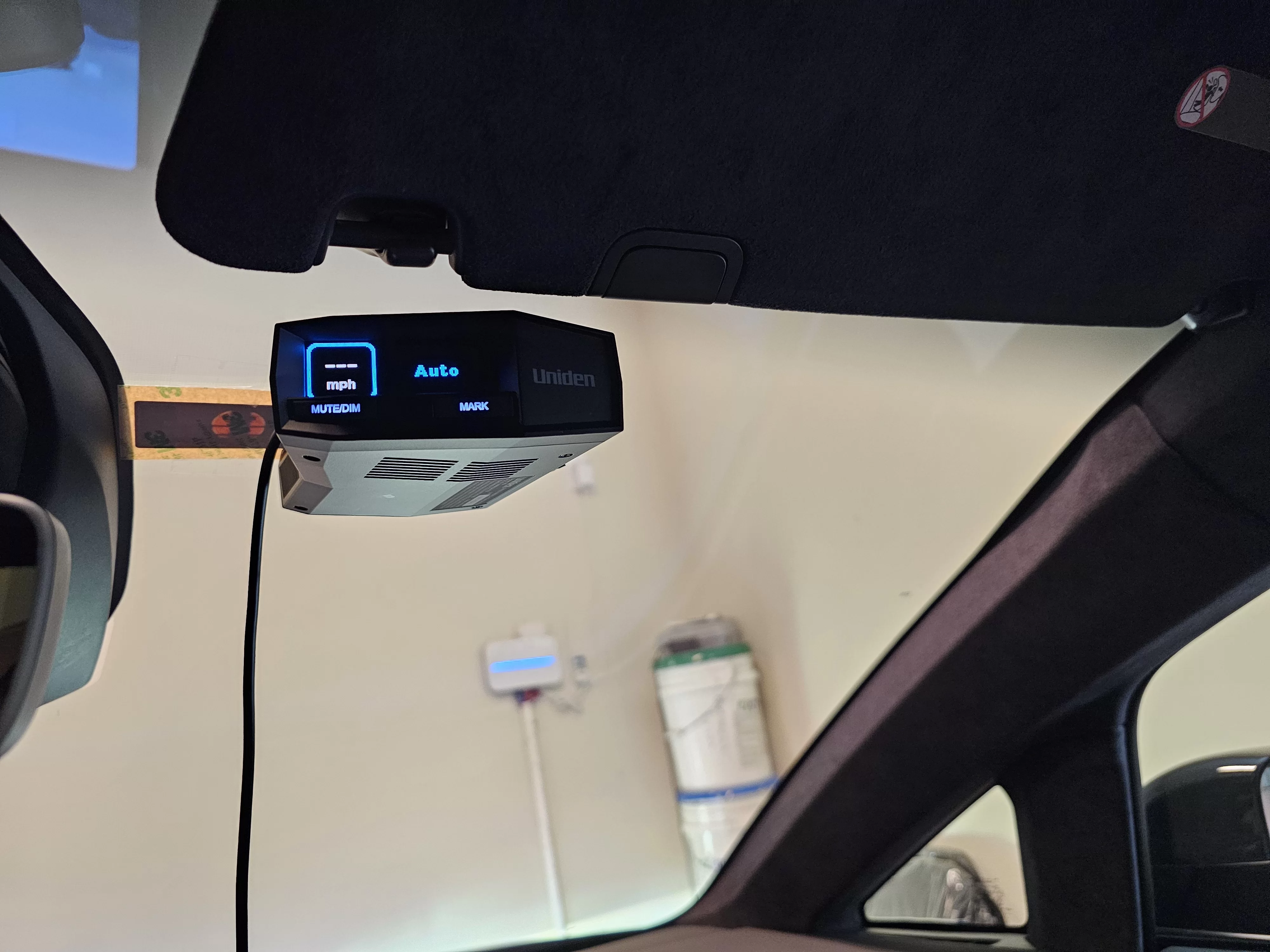

As promised, here is the delicate fit of both the detector and tolltag in the window: The only mount that works is the dual suction cup one provided with the detector. I had to tape the tolltag into that specific spot which did not block the radar sensor but did interfere slightly with the edge of the suction cup (so, the corner is off the window and on the back of the suction cup). Also, you can see the visor situation.

Thanks so much, definitely will get the R8! I’ll just put it in the left A pillar window since I should be able to reach to mute it. Are you using USB c plug for it or 12v to USB c adapter?

I definitely recommend the R8 (or R8w)! Please report back on the performance in that spot (including if you are able to see forward arrows).
I bought a USB-C cable from Amazon that I have plugged into a small power brick underneath the 2nd row screen on the back of the center console. The cable runs behind the screen and down between the passenger seat and center console. The wire is very unobtrusive and the detector reliable turns on and off appropriately when entering and exiting the vehicle (per the setting for the power plugs).
