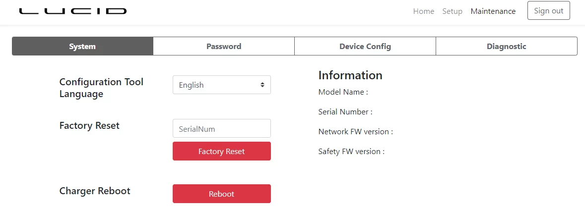

Good idea, I'll give that a shot. If no luck is there a way to factory reset it ?

Log into the LCHCS' home page within 15 minutes of power-on, and navigate here:

For 15 minutes after every power-on, you can reach the LCHCS by connecting your phone or laptop to it's internal setup WiFi SSID at 192.168.5.1, rather than your home's wifi.

The instruction on the manual is as follows:
1. Using a laptop, seek its Wi-Fi Network (SSID), matching the serial # of the unit, a 10- digit number found on the label on the right side of the unit. (ex. 2215200034). Once selected, use the serial number again of the station as the password to connect. (e.g.: 2215200034).
2. Once the laptop is connected to the WIFI Network (SSID) of the charging station, open your preferred web browser, enter the station's IP address: 192.168.5.1
3. This will then load the Lucid Web Configurator login screen. Enter the same 10-digit serial # of the charging station to log into the configurator.
4. This will then load the Lucid Web Configurator login screen. Enter the same 10-digit serial # of the charging station to log into the configurator.
5. Optional Password reset step: It is recommended to change this Password by selecting Maintenance in the top right corner. Select Password, and then enter the new Password, click Save. This will log you out and you would be asked to sign back in with your new Password.
6. After signing in with the updated Password, connect the Lucid Connected Home Charging Station to the home network via Wi-Fi, select Setup and then Wi-Fi.
On this screen, enter the preferred home network's Wi-Fi name and associated Password, then click Apply. Other options can typically be on their default settings.
The screen would show buffering status for few minutes, please wait, this is the time when EVSE is rebooting and is trying to connect to internet using your home network.
Select the Cloud tab under Setup, and ensure Lucid Cloud is selected. The Customer’s Lucid ID is displayed. Click Apply.
Note: This must be the same Lucid ID email address that the customer used to create their Lucid account for the vehicle and mobile app.
Once you hit apply, the EVSE would reboot again and the screen would show buffering status for a few minutes, this is when the station is connecting to the backend.

  • As soon as the reboot is done, sign in and click on Maintenance and then Device Configuration. On this screen is the WIFI IP address of the charger. Take a screen shot of this as I'd need the IP address to log on the router later. This info would save me from doing all the complicated things such as doing the cmd command, or signing on to the router, to manually look for the IP address of the charger.
