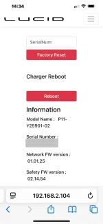

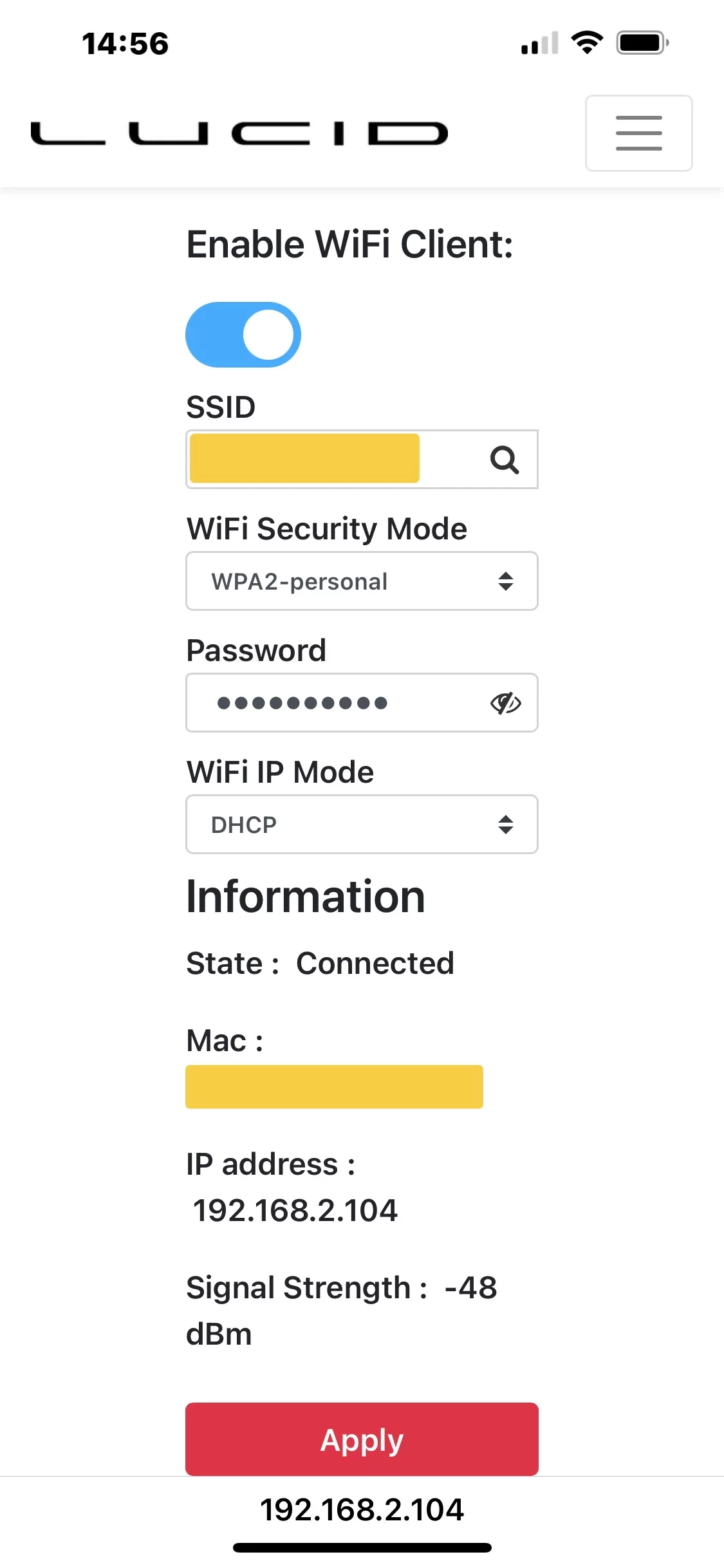

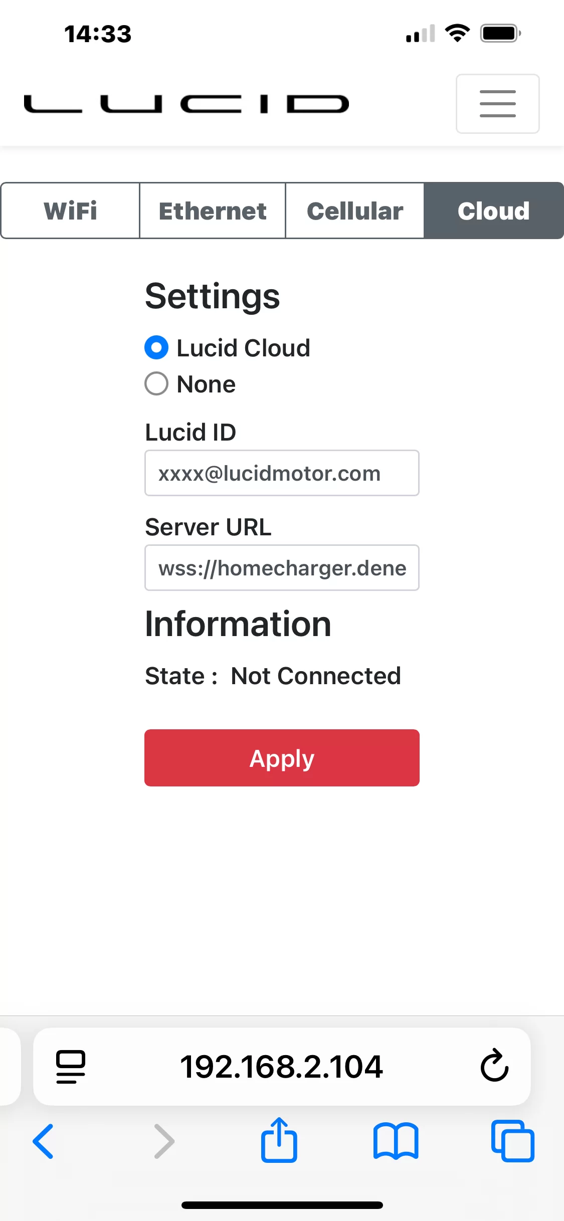

That was the secret sauce:
I didn't complete the setup yet, but at least I got into the browser's web page.
Yeah, I just suspected that due to the instruction saying the browser might throw a warning; that almost always means they are using a self-signed certificate for TLS, hence adding https.
It is obviously a mistake in the documentation. You should report it as I’m certain it has burned others too.
I just installed my LHC, but--based on these types of threads--haven't tried connected it to my WiFi network since I have a low tolerance for tech FUBARs. I set the charge time and limit in the car, plug it in, and it works fine. Am I missing any useful features by not connecting via WiFi?
It’s not bad, it’s just the instructions are a little unclear.
You’re not missing anything today. Future eventual software updates, though. No, I have no idea if or when.
Congratulations! Which browser did you use and what from what device platform iPad? Win11? Details may help others facing similar issues
The browser should make no difference. The “trick” is making sure to use https, and not let the browser default to using http. You may get a “insecure” warning because it’s a self-signed certificate, but you can tell the browser it’s fine and keep going.

I used my Android phone this time S23+ and Chrome.

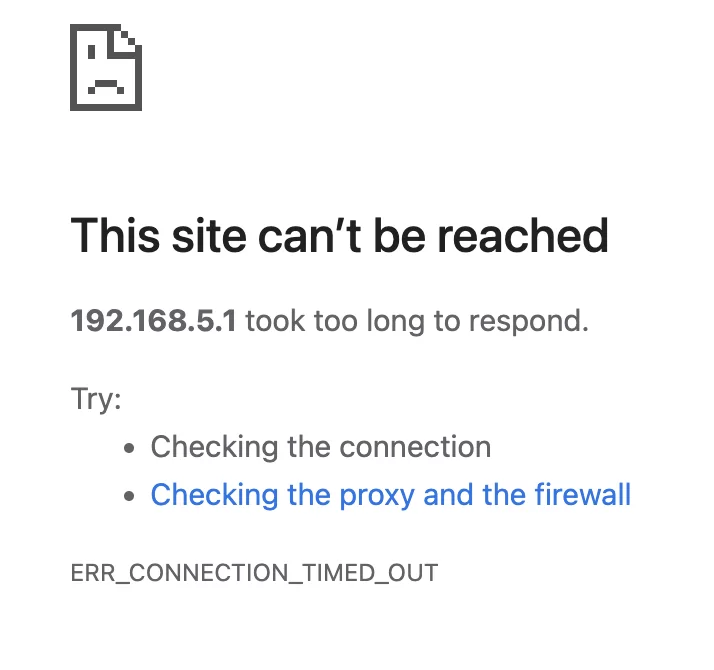

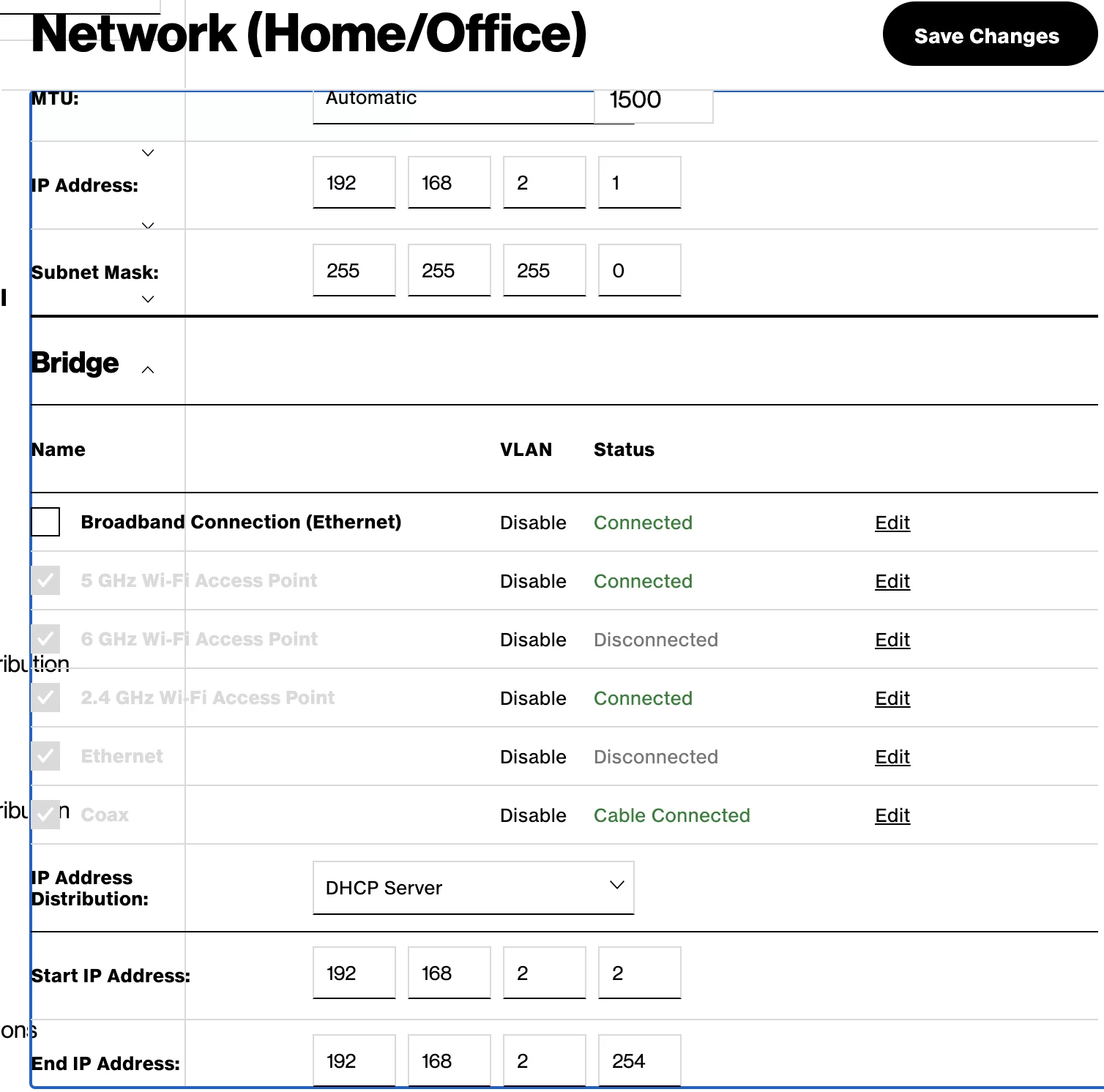

Had Lucid home charger (NACS version) installed today.
Been stuck at that dreaded step of charger not connected to home wifi.
Yep, I changed the home network ip address to something other than 192.168.1.1.
I used 192.168.2.1.
Also changed the DHCP Server ip address range to 192.168.2.2 thru 192.168.2.254.
See image below.
Thought I was good because I was able to go to the cloud tab and enter my Lucid ID.
Then realized I was still connected directly to the charger, not making the change via wifi.
Interestingly, when connected to the charger and seeing the Device Configuration information, an ip address of 192.168.1.163 is shown. See second image below. Tried entering that ip address instead of the charger's default ip address of 192.168.5.1, but still not wifi connection.
Third image below shows the screen that displays after no connectivity.
Really thought I had this figured out from all the previous posts.
I used 192.168.2.1.
See image below.
Waiting on call back from Customer Care.

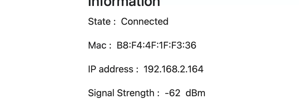

Correction:
The second image I posted was the charger ip address after I had changed the home network ip address to 192.168.2.1.
When the home network address is 192.168.1.1 the charger ip address is 192.168.1.163.
Correction:
When your laptop/phone was reconnected to 192.168.2.x, you couldn't access the LCHCS at 192.168.2.164?
Correct.
I can see the charger in the list of connected devices, based on its MAC address.
Shows it's connected at 2.4GHz.
Correct.
That's the same behavior mine had while my home subnet was 192.168.1.x. It worked properly when I changed my home subnet to 192.168.2.x.
I repeated this experiment when I installed a new home wifi setup from a different vendor, and the result was exactly the same.
Worst case, you can temporarily connect an ethernet cable to the LCHCS for a few hours to let it update its firmware and try again, or ignore the problem and just use it as is.
When I ping that ip address, I get successful pings.
Test fails if I ping 192.168.5.1 which, I think makes sense if the router has assigned the charger the dynamic ip address of 192.168.2.164.
Maybe not.
