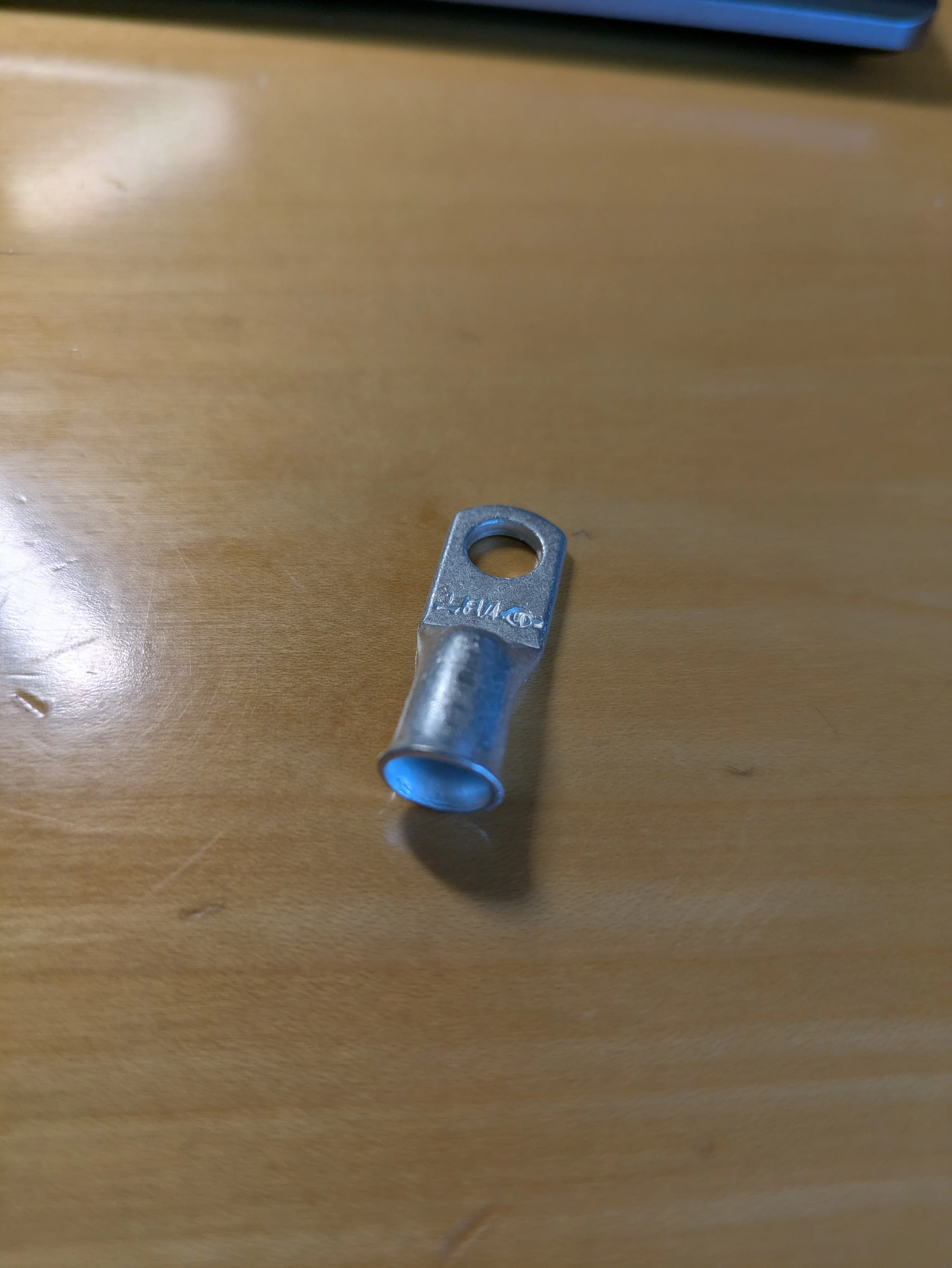

Are you using the proper lugs on the ends of the wires to connect to the charger? If you did a simple replace of the existing wires of the plug to the charger, maybe you need to do a new cut/strip/connector.
I think you need to check from the breaker and the unit itself. Make sure you get 50A at the breaker. Then make sure the unit itself is receiving 50A at the lugs. Then keep moving forward until you eliminate it at the unit itself. It's possible you have a bad unit, but I haven't seen posts like that on the forums.
I have a hydraulic crimper from when I did a Miata EV conversion in my garage. I crimped on pure copper lugs (tinned) for 6AWG wire.

Here is a photo of the type of lug I'm using. The bolt hole is just the right size for what the contact block uses, and there is no room for a wider lug. In other words, I can't use a bigger lug.
