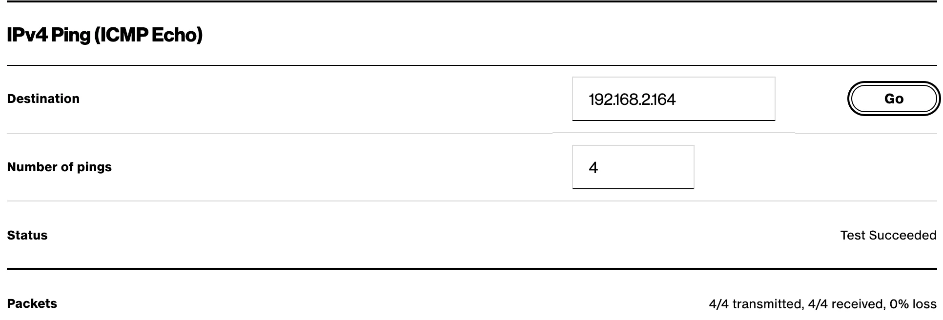

When I ping that ip address, I get successful pings.
Test fails if I ping 192.168.5.1 which, I think makes sense if the router has assigned the charger the dynamic ip address of 192.168.2.164.

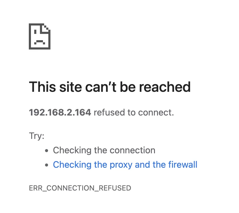

Had to use https and the ip address (192.168.2.164) assigned by the router instead of https://192.168.5.1 that I had been using.

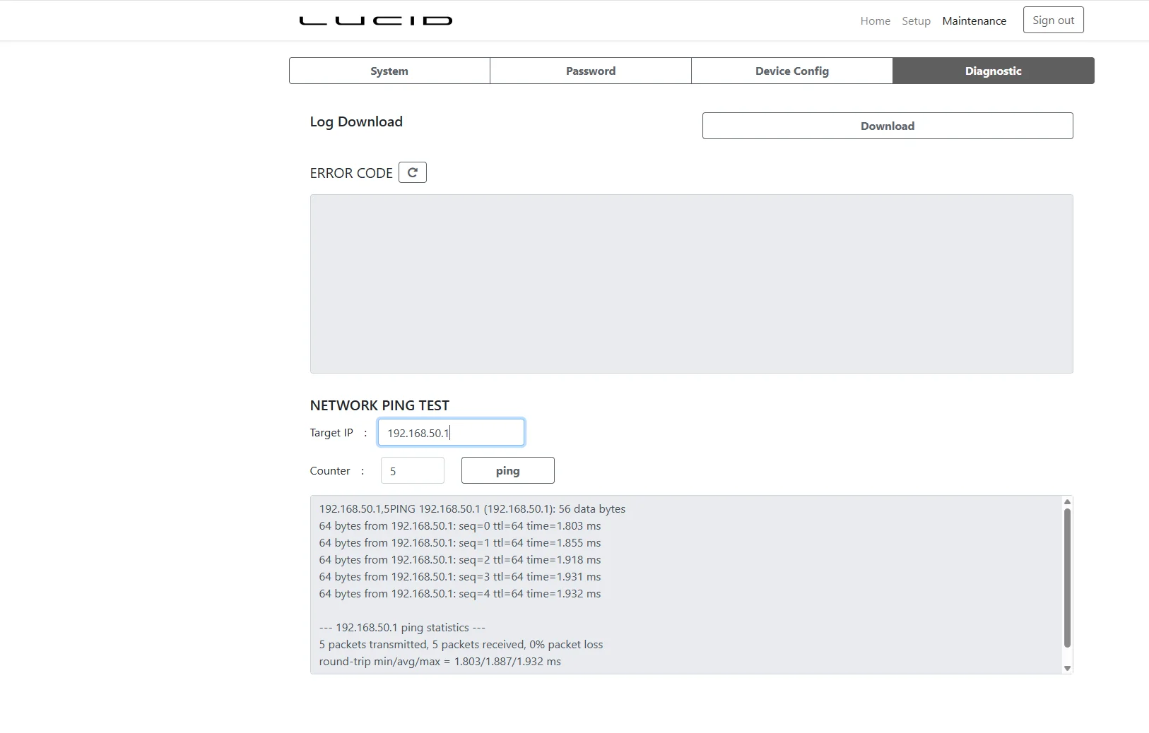

I'm on the Diagnostic screen telling it to ping the router, working like a champ.
The entire interface is pretty much useless, though. Lots of work to get it going, no tangible benefit other than checking for firmware upgrades...but by and large, I'm treating it like a black box especially since charging speed is going to be controlled via the car in 2.8.0 in any case.

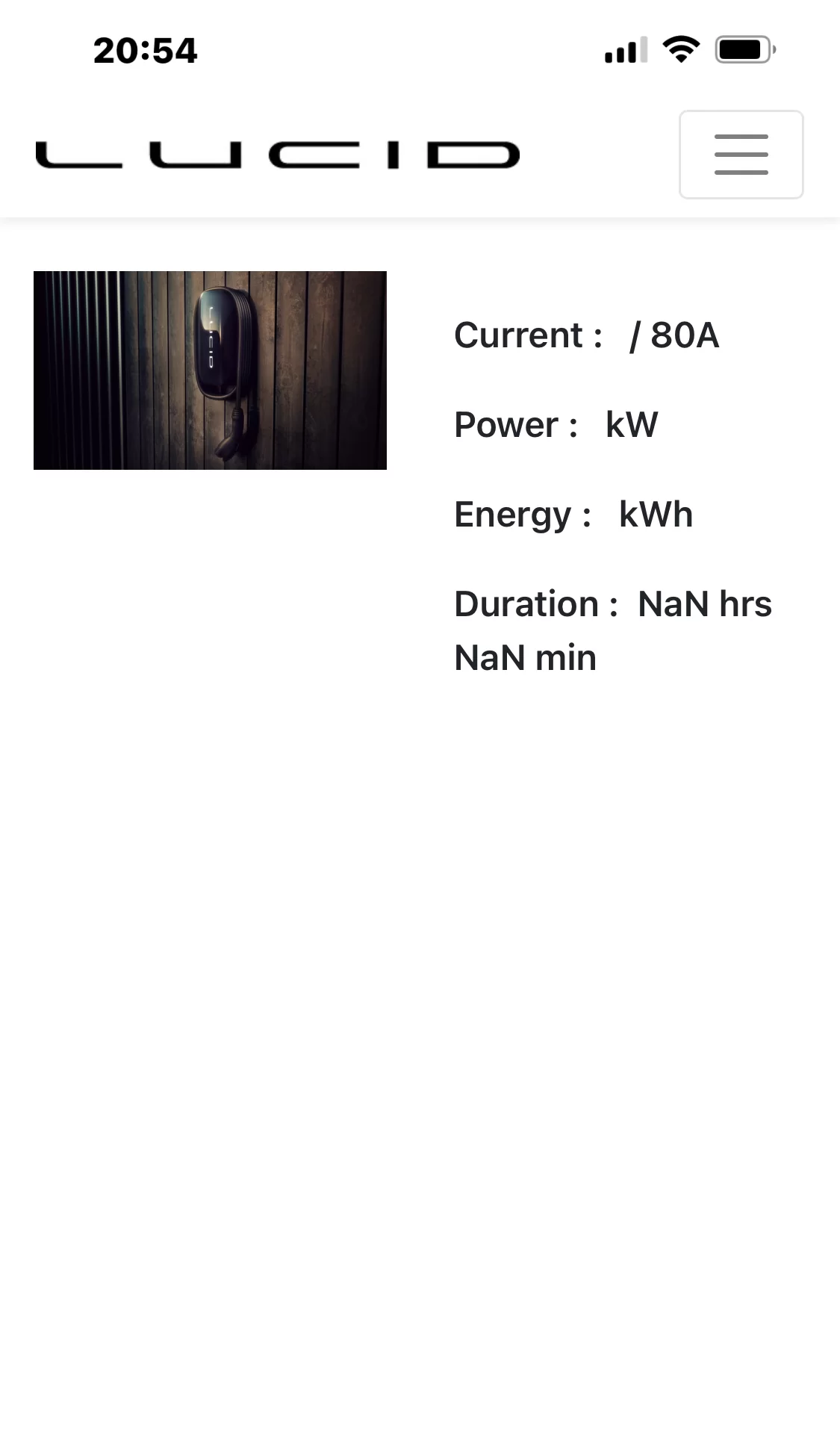

I concur, the setup is not kind. The fact that there's no secure connection support isn't a biggie for me, but the fact that it only support 2.4Ghz WIFIis critical to know ahead of time. I have the whole thing working and have spent some time accessing the interface with the browser development mode (F12) enabled showing all the network interactions. There's a lot of asynchronous operations taking place, allowing the initial page (minus any useful data) to draw quickly...then as various background calls get answered, more and more data starts coming in.
I will say that the home page display (current, power, energy, duration) sometimes dies, requiring a reboot. Otherwise, when it IS working, it is refreshed once per second in the background, which I imagine is cool if you want to watch it charging from a web browser. You can see the same thing through the Lucid App on your phone, though. The 'download log' function is not working for me, the operation is timing out on the charger itself, I can see it clear as day from the network interactions on the developer console. Whatever embedded webserver they are running, the request timeout is too short once your log file takes a log time to be compressed before sending. I imagine a factory reboot (which will clear the log) will result in this function working again, since it'll be completed within the requisite time limit, but I truly find myself not caring, and definitely not wanting to set this up again from scratch.

Are you making sure to put https:// in front of it?
that is a surefire way for the connection to be refused, I am all but positive that it's not listening on port 443...only port 80.
Mine doesn't support secure connections at all. you should either skip the protocol designation, or specifically use http:// (note the lack of an 's').

Mine is connected to my wifi BUT it is totally useless. Nothing other then the connection KwH and Amps.
No log, no data storage, no control
Useless apps
