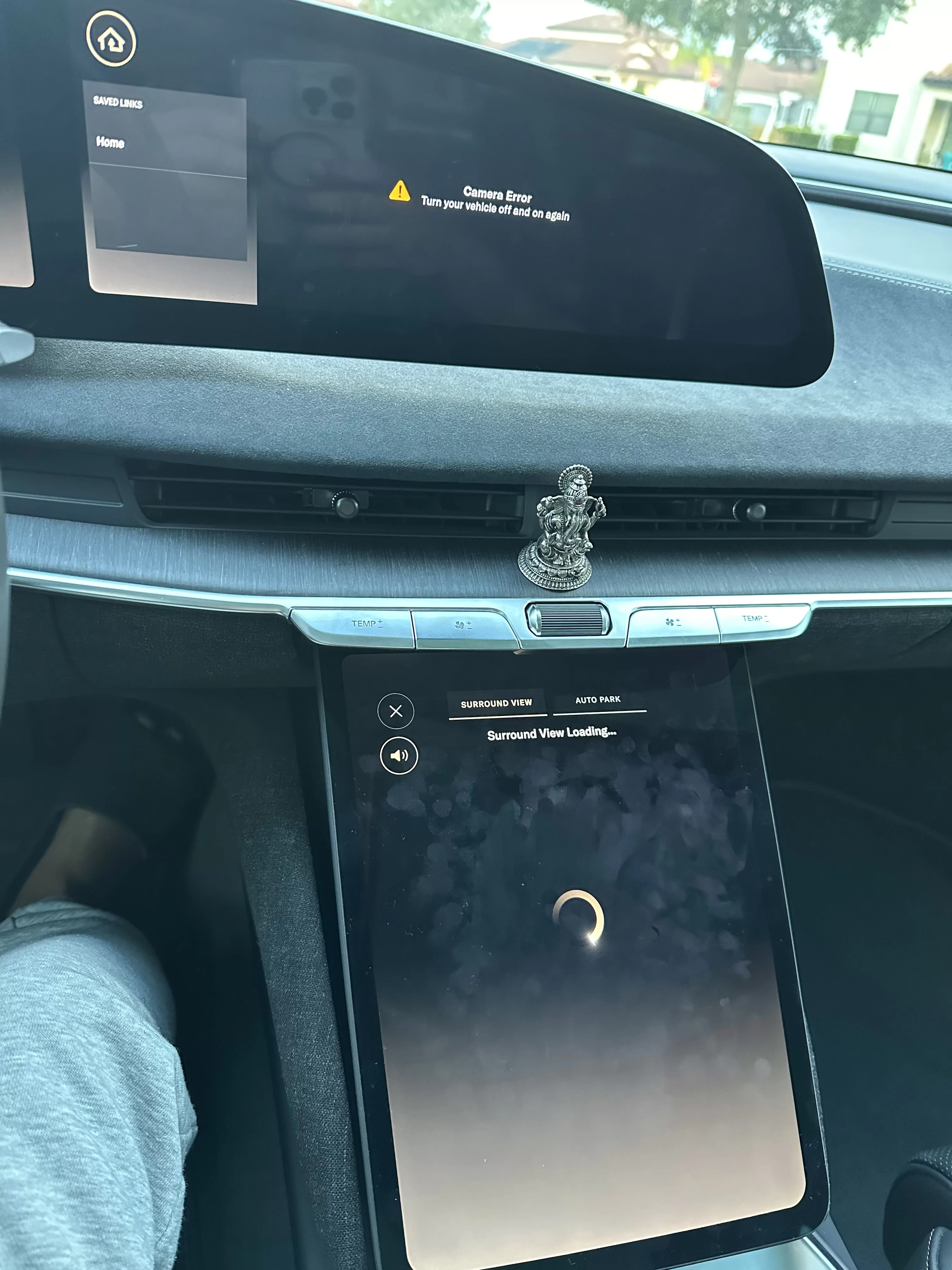

Any one having issues with camera since update, i have camera error after driving a bit and that goes only after i lock and wait and unlock the car. This is happening very frequently to me, my mobile tech says this is a software bug and he have no info on when this will be fixed.
Any one having issues with camera since update, i have camera error after driving a bit and that goes only after i lock and wait and unlock the car. This is happening very frequently to me, my mobile tech says this is a software bug and he have no info on when this will be fixed.View attachment 24986
Yes, lots of people are seeing, including me, and yes it is a software bug.
I’ll turn my base down. I usually always have the balance slightly in the back. I feel like it sounds better too.
Did you notice the balance resetting itself to default, every time you start the car? Mine does that. It only loads my custom setting if I tap into the balance settings on the screen, otherwise it completely ignores it. It exists in superposition, like Schroder's cat, until I look at it.
This is linked to the new curb rash feature in the 2.5.0 update. I got multiple crashes per day so I simply turned the curb rash feature off until the bug is fixed.
This is linked to the new curb rash feature in 2.5.0 update. I got multiple crashes per day so I simply turned the curb rash feature off until the bug is fixed.
Thank for the info, i will go ahead and disable this.
I got that error multiple times. Mostly when I drive into my garage which is a tight spot.
