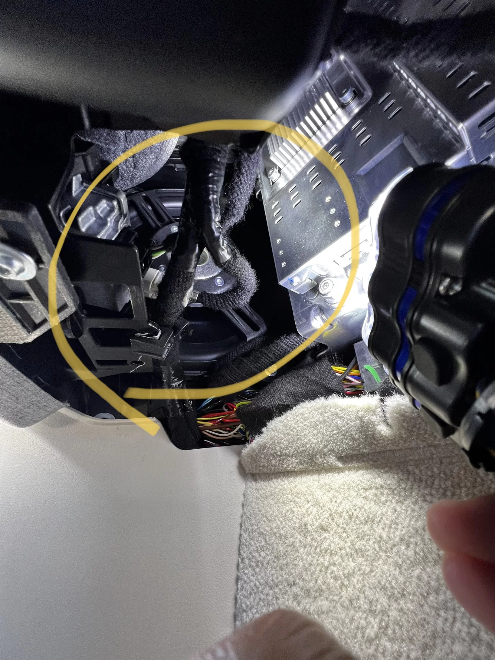

Following up on this. My front subs are working and likely have been working this whole time. I presume it is working for most of us 😅
They're located on the walls of the footwells. This is my driver side sub.
I could feel it thumping nicely when I put my head down there and physically touched it.
And my left one is on order for replacement.
It’s very odd to have a speaker buried without access to being able to push air.
Is that downward firing?
