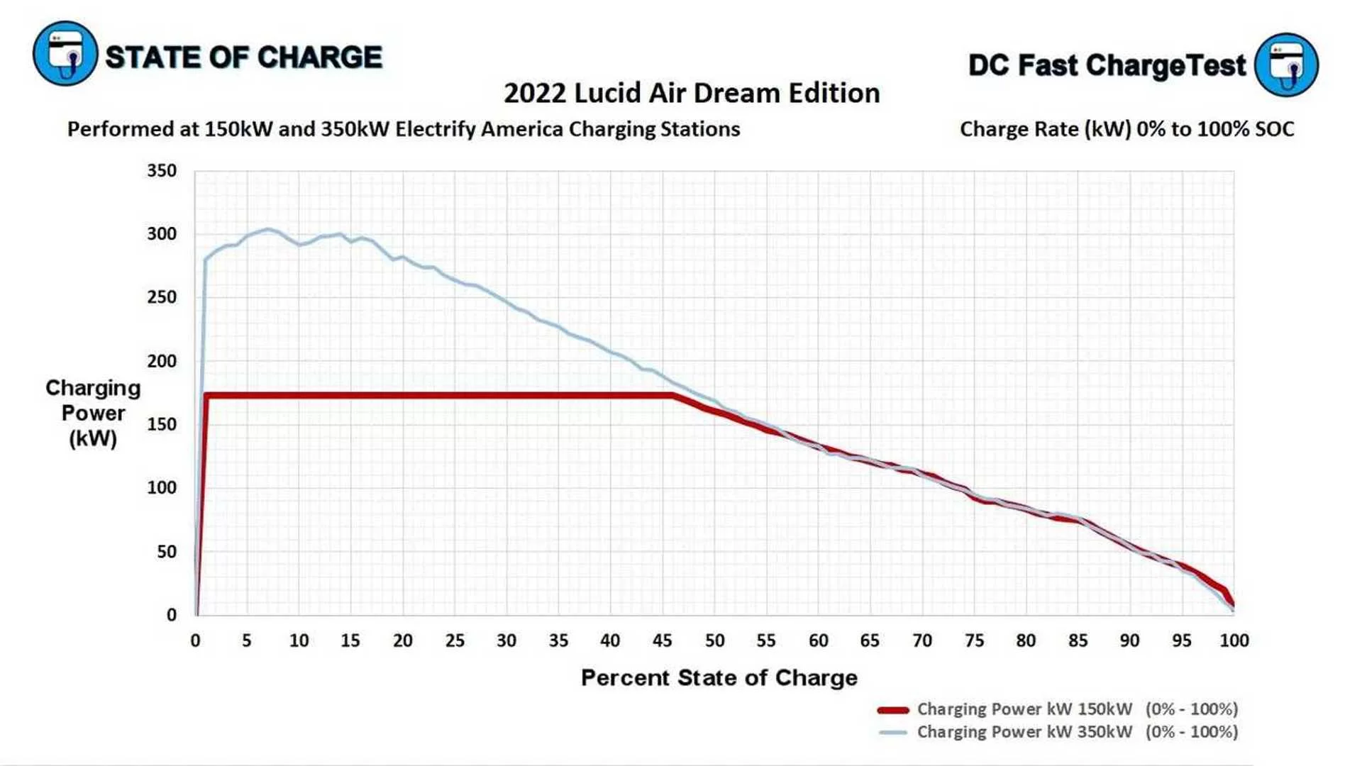

I was wrong about pulling 80 kW as I near 80% SOC. Someone published the Lucid GT charging curve, kW vs %SOC . I can't find it.
I posted in another thread, but no one has ever posted a GT charge curve from <20% up to 80% (or it's hidden somewhere that i haven't been able to find). Only a few flexing screenshots of hitting 250+ at 20% or 30% SOC. I wanna see the overall curve!!
I think you may have seen a DE-P charge curve. Those seem to sustain a lot higher speeds than the GT/Tourings. That can do 80kw at 80%. For a 25% larger battery compared to the Touring, it does 50% faster charging at any given SOC %
I have the GT "regular" battery. Pretty sure the Dream Edition, and the GTP are a bit better.
Note that at ~ 45% SOC the charger 350 or 150 makes no difference.
yea that break-even point is way lower on the regular Pure/Touring/GTs. Under 40%
