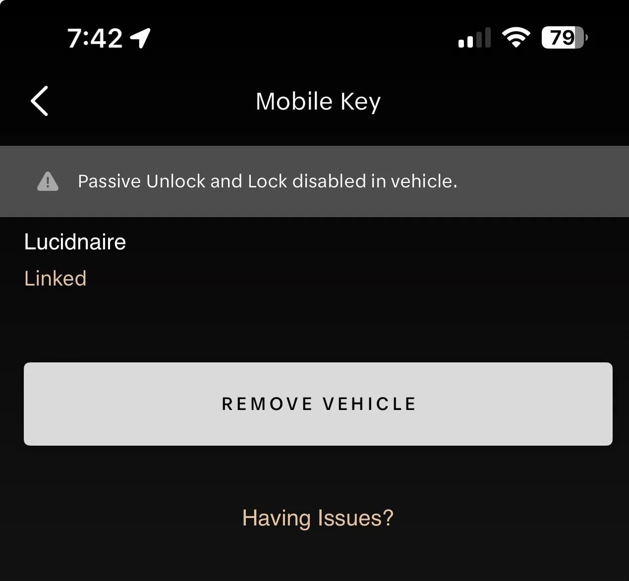

Cool. That didn’t answer our questions, lol, and in the interest of understanding if this is a real issue or due to you not having mobile key set up, I’m still curious.
But cool. :)
Mobile key was setup many moons ago
Then I suggest, in this new moon, deleting and removing the mobile key from both phone and car (carefully following the instructions, including forgetting the Bluetooth device), and trying it again. If it still fails, you need to see service because you have a hardware issue likely with your antennas.
Funny how this has evolved into two threads in one... I have a Pixel 7, and I never take the fob with me. With regard to the Pixel asking for your five digit code... If auto-open does not work, and you use the app to wake the car and unlock the door, the car will not recognize who the user is, and the code number will be asked for. Instead of opening the app, while you are standing by the car, you should toggle Bluetooth off and then on again, and the app (running in the background) will quickly activate the auto-open, AND recognize you as an authorized driver. [BTW, if you do it the first (aka wrong) way, the car will ask for your code every time you get in the car UNTIL you exit the car, lock the car, and when you return, let the auto-open function do it's thing. Hope this helps.
At least for iPhone, the new Lucid mobile app is super stable and quick, nearly as quick as the Volvo EV app which is impressive since the Lucid app has many more features than the Volvo app. As for mobile key, never bothered with it, always have the fob in my pocket, have only had to manually unlock the car by pressing the fob maybe 3 times in the last year and that was due to a low Keyfob battery. I have noticed since the prior OTA my key fob has been plowing through batteries, at first I thought it was a bad batch but I’ve had both energized and Panasonic bitterant free batteries and I’ll get the “no key fob detected” alert briefly quite often. 🤷‍♂️ has any other fob devotee noticed this more often lately?
I just got the same message for the first time.
If the car locks and unlocks 10 times without a door opening, it disables passive unlock for 4 hours
Ok thanks. I did not know that.
It’s an attempt to resolve the complaint that the car opens and closes and opens and closes when you are working in the garage, for example. You’ll need to actually press the door handle unlock it if it goes into that mode.
Now I know why I always have to press the door handle in the morning. The app says the car is waking up during the night, I think because we don't always put the key fobs in their pouches, and they're not that far from the garage.
