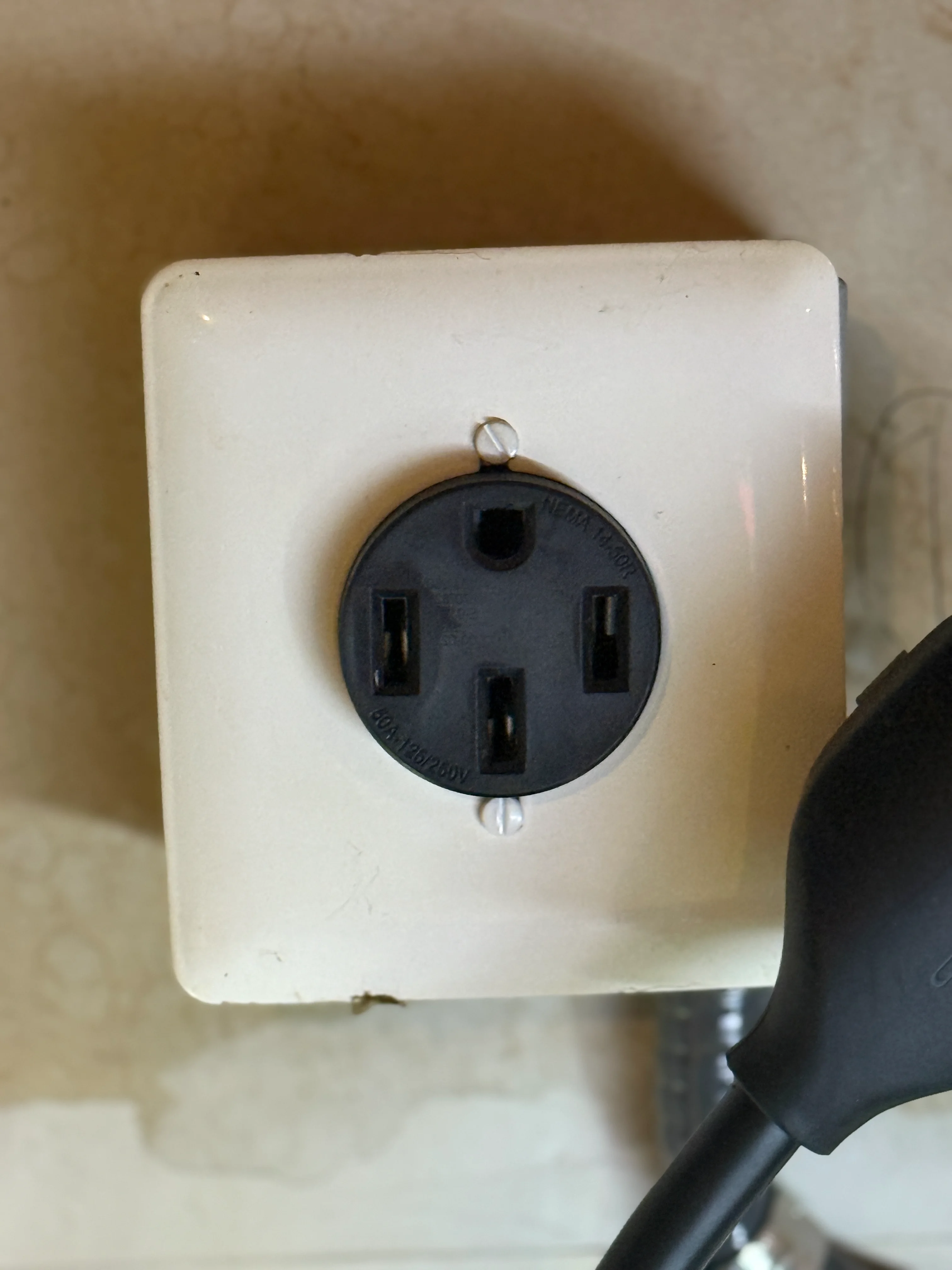

Good afternoon,
I use the Lucid Mobile Charging Cable. I had an electrician install a NEMA 14-50 plug and I believe a 50 amp breaker. The mobile charging cable feels warm, but since I never touched it while charging before, I'm not sure if warm is really hot or just warm. I don't really have anything to compare it to.

Let the car charge for about 30 minutes and then stop charging. Remove the mobile cable plug from the 14-50 outlet and feel it. If you can, please post a picture of the 14-50 outlet. Some outlets really should not be used for EV charging.

Good evening,
Here's a picture of my outlet. I completed the charging earlier today, so I'll have to charge my car again in a couple of days.

I think something is overheating. Your outlet does not appear to be the heavy duty type suggested for EV charging. If you have a family member or neighbor with either a 15-50 outlet or EV charger, you could rule out a car issue if it successfully charges with another EV charger or your mobile charger works in the 15-50 outlet. If not, then you should keep an eye out for when your charger stops and check the cords (both ends) and your outlet for excessive temperature.
