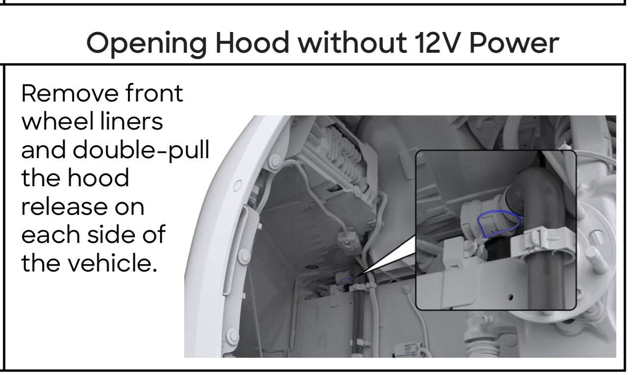

Where did you find this? Do you have another one that describes where the navigation module connector under the driver seat is located?
Came up with this on a google search.
