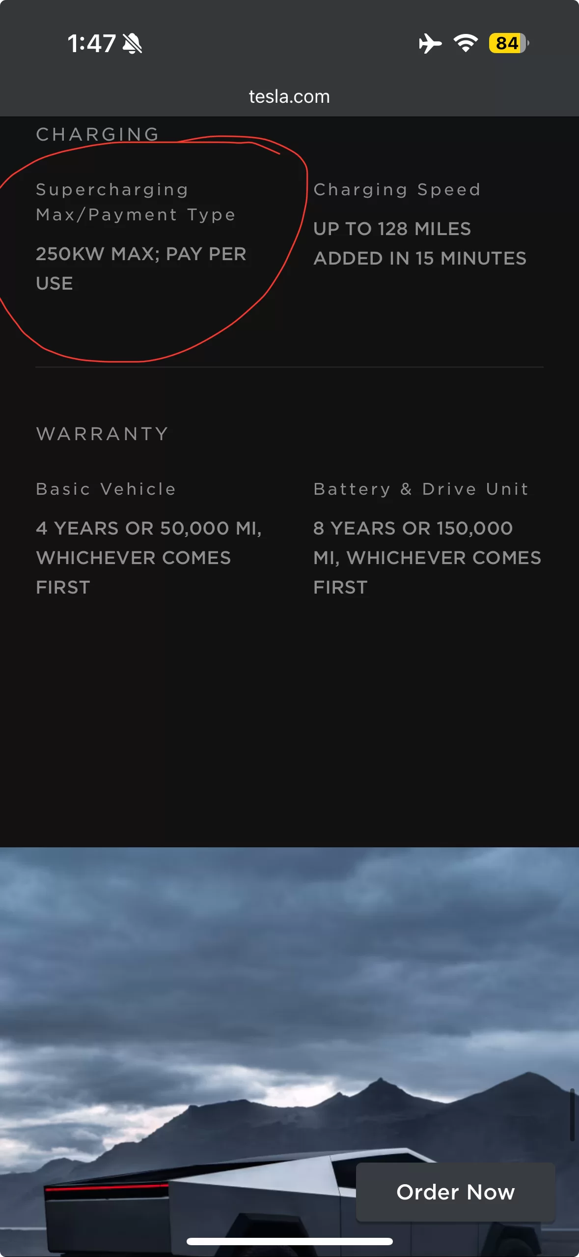

It looks like the Tesla 1000V is not in a hurry anytime soon because today's expected 1000V Cybertruck is actually only 250kW max with the first deliveries:
screenshot-2023-11-30-at-4-31-39%E2%80%AFpm-png.995141

Tesla is not known for underselling its specs. If it were 350, they would have announced 350, especially since they already delivered 10. They didn’t, because at present the CyberTruck cannot handle it.
Also, stolen from a Tesla forum: “136 miles out of 340 is 40%. Adding 40% in 15 minutes is not indicative of a great charging curve or c-rate. Pretty much every other battery type Tesla offers adds 50% in 15 minutes. Heck, even my Model 3 RWD standard range adds 50% or 136 miles in 15 minutes, and it’s one of the slowest charging Tesla models.
When calculating gas savings, the Tesla website uses 42.9 kWh / 100 miles for the Cybertruck AWD, meaning that’s how much power it pulls from the wall to go 100 miles. Multiply by ~88.8% to account for charging losses (that’s the factor used for Model 3 on their website), and then by 340 rated miles, and we can guess that the Cybertruck AWD has a roughly 129.5 kWh battery. Multiply by 95.5% to get a usable capacity of 123.7 kWh. Multiply that by 40% and we can estimate that the Cybertruck added 49.5 kWh in 15 minutes, meaning average charging power was 198 kW. If peak is 250 kW, that means it might have already slowed down to around 146 kW after only 15 minutes, assuming a fairly linear drop. Ain’t no flat 250 kW charging curve happening here.”
