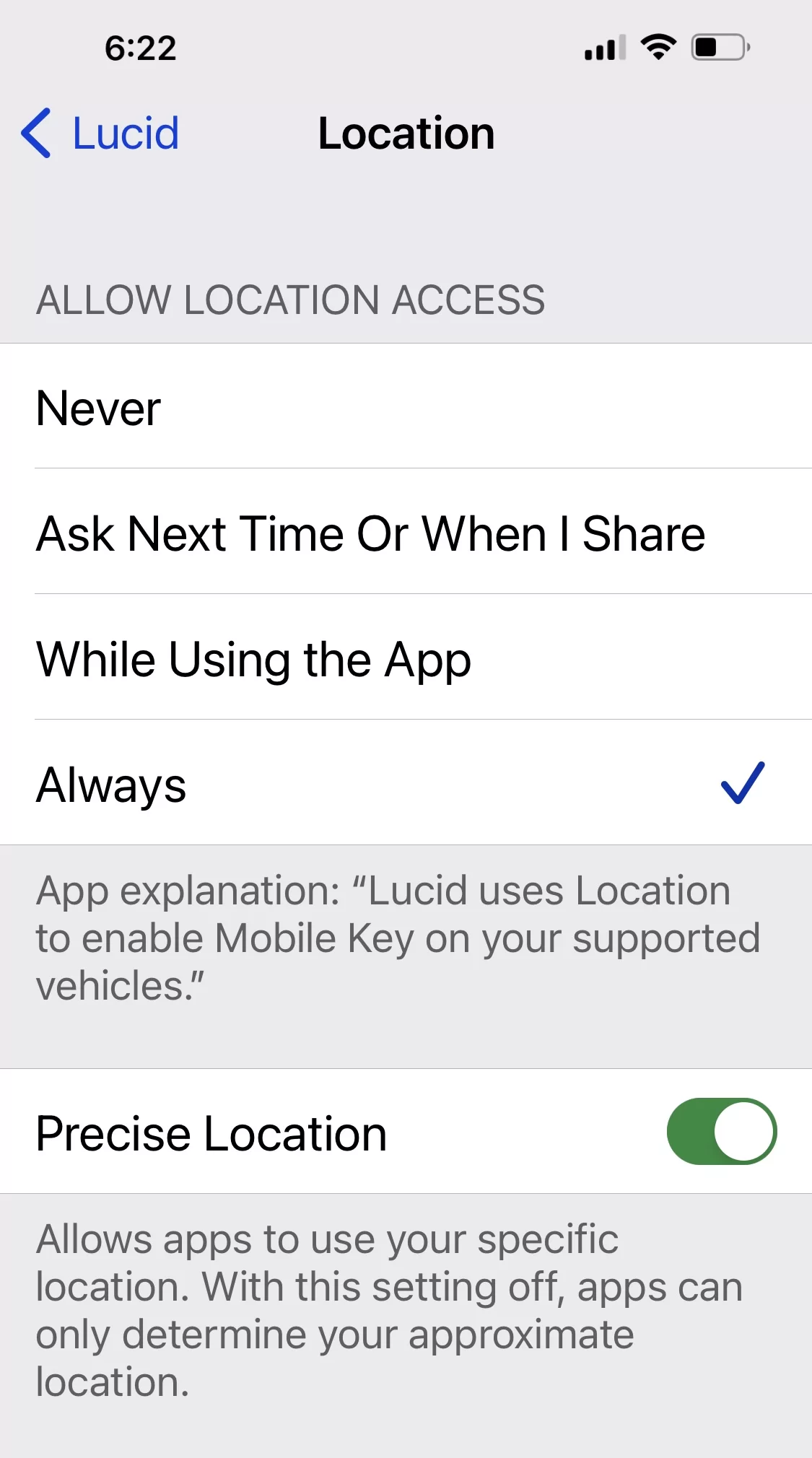

Is your Location set to always with Precise Location turned on?
Was going to ask the same question. Haven't had an issue with my mobile key in a very long time...

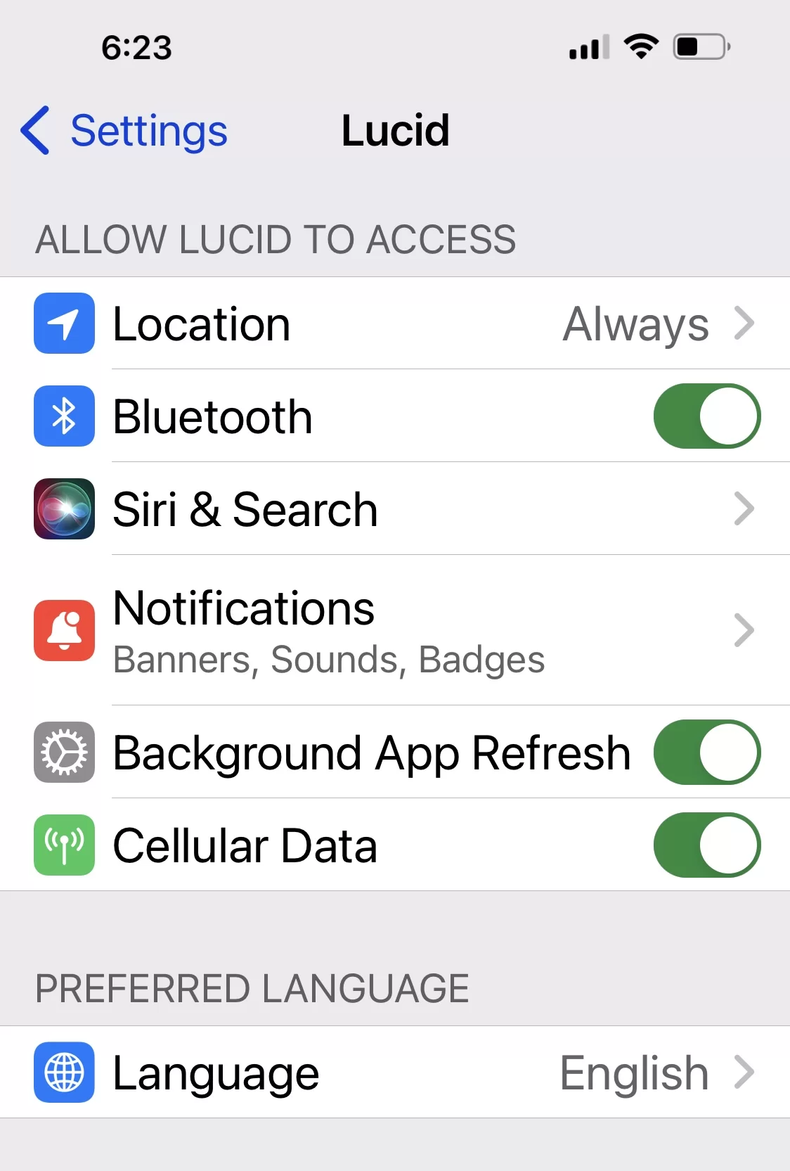

Un-pairing and re-pairing the mobile key to the car hasn’t changed the behavior. And I’m pretty sure I have all of the location services set correctly for the Lucid app, but feel free to check my work:
