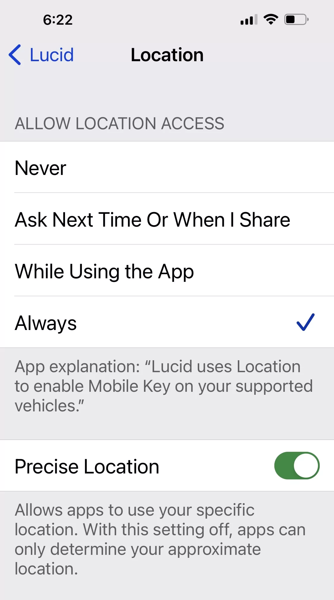

Un-pairing and re-pairing the mobile key to the car hasn’t changed the behavior. And I’m pretty sure I have all of the location services set correctly for the Lucid app, but feel free to check my work:
My profile is the only one with keys assigned to it (I have a guest profile for the Bobby reset). When using the mobile key exclusively in this case, I keep the fob in a faraday pouch. I have a service appointment in a couple of weeks where I’ve asked them to specifically look into the keying issues because the fob is also inconsistent, but in different ways.
