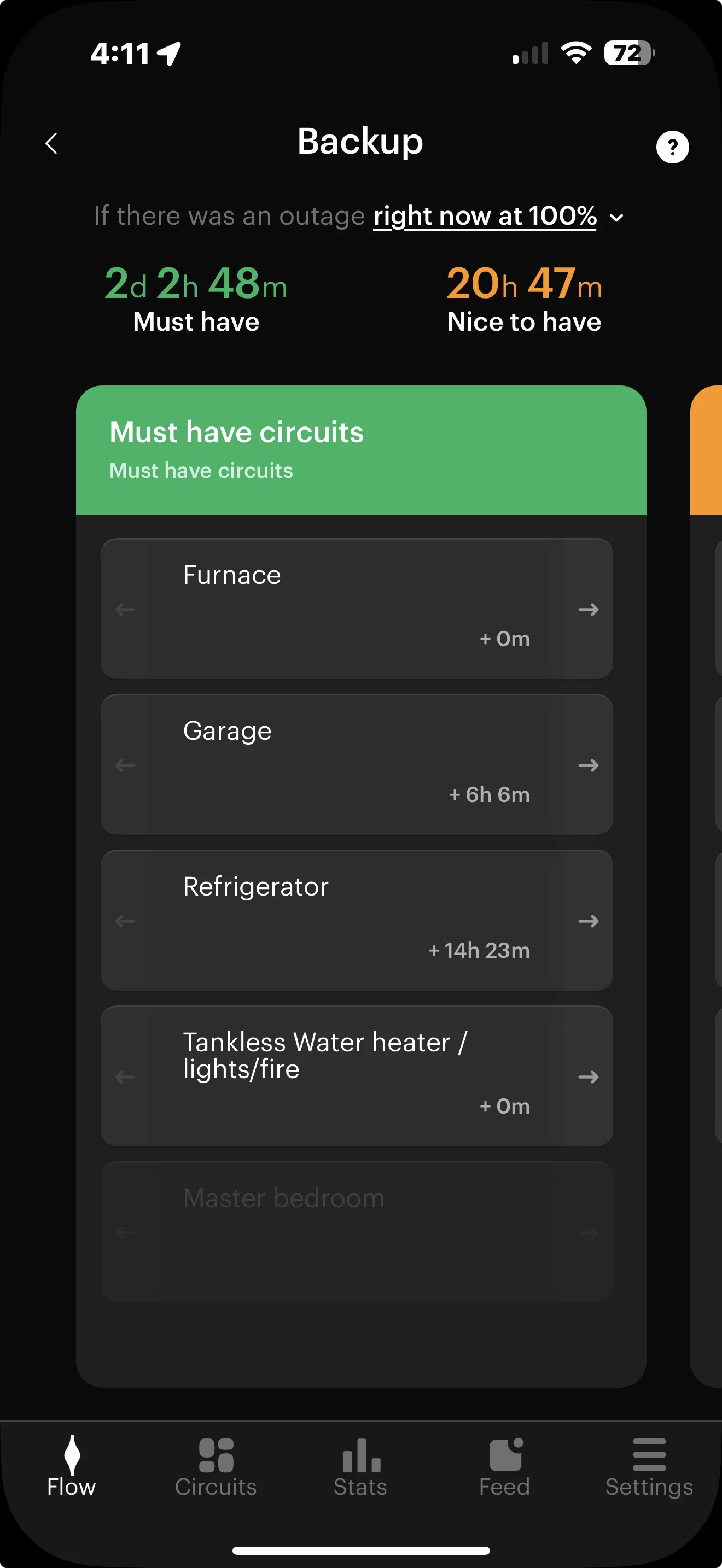

I replaced my breaker box with a smart breaker box SPANIo so I can dynamically choose my must have circuits, nice to have circuits, and circuits to shed during a power outage.

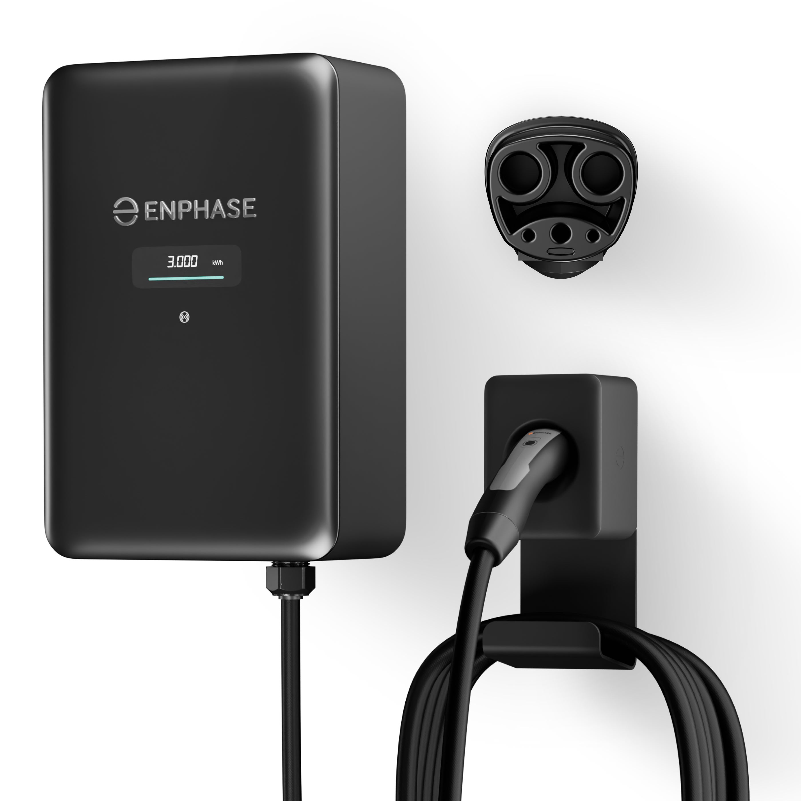

Enphase's AC bidirectional EVSE is available now, at least the 40 and 48 amp versions. I assume they will eventually work with Air and Gravity when everybody has their software working.

Right, Enphase's AC bidirectional EVSE is available now. I have one in my garage. Their DC bidirectional EVSE introduction has been pushed out several times over the last 18 months. In the meantime, wallbox, dcBel, sigenergy, etc are beginning to sign up early testers for their products.
I'm planning to stick with an AC bidirectional EVSE and compatible car for now. It's a little more elegant solution than DC bidi, but with a narrower choice of vehicles.
