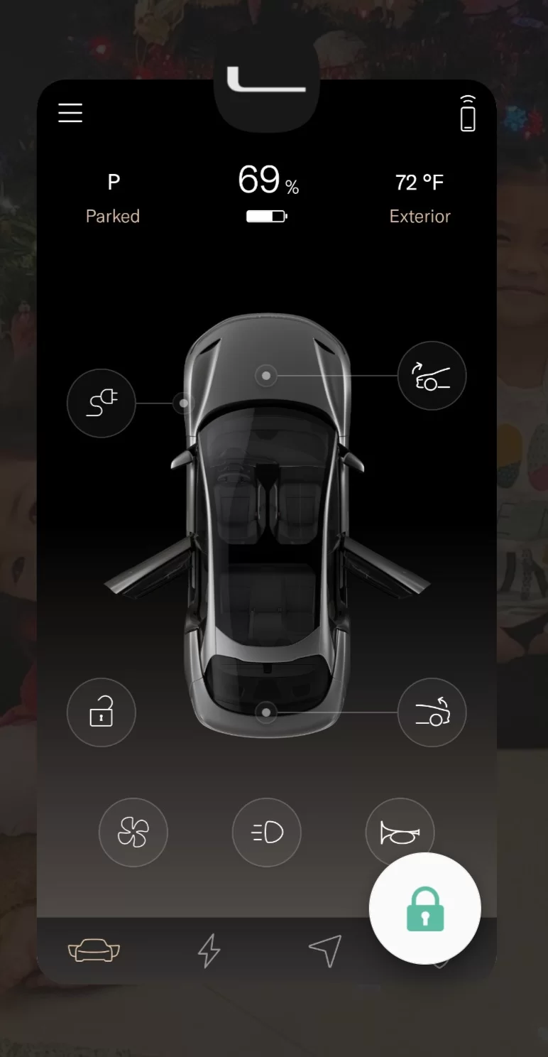

My doors are slow to unlock solely because of my android phone. No matter how I try, the phone eventually puts the app to sleep and I have to open my phone and app if too much time has elapsed from the last use. I could save myself the irritation by using my iphone but I'm stubborn 😅
Lock it so it doesn't

Also it doesn't give the option to keep open
