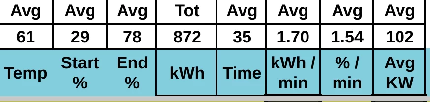

Display the % and not the miles as you would on a phone. Estimated battery life on the phone is meaningless. Likewise, the estimated range is EPA based which you don't get. That said, unless you really need to travel long distances, you can expect about 1.5 to 2 kWh of charge or about 1.5% per minute these days at a 150 or even 350kW EA charger if you charge from 20% to 60 or 70%. If the ambient temperature is 60F or more when you charge, you will not see much difference in the charging speed whether you pre condition or not but 50F or below it can matter. Hope this helps. Look at the current lucid charge curve as a guidance.
Also, here is data I collected so far.

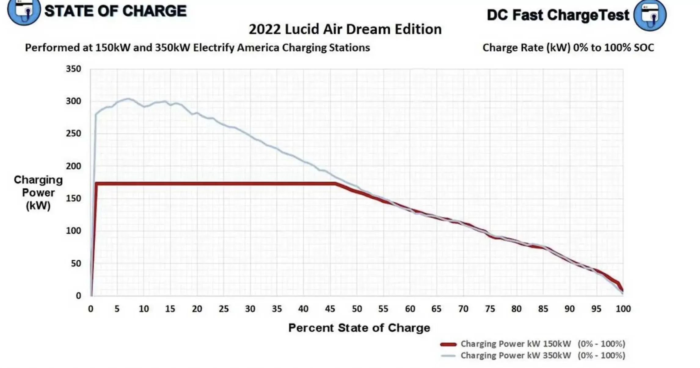

This is a hugely optimistic curve as related to EA chargers. My experience is that the rate drops to 40 or below at 70%SOC.

That means it is a bad charger for sure. Try EVgo

You've got bad luck then. I charged from 38-80% today. I was still pulling 90 kw at 78% (and only maxed out at 150 kw on a standalone 350 kw station).

I have not seen that personally. But I know there can be a lot of variance depending on location.

Wonder if it's the heat. When I'm standing near the charger, it sounds like a wind tunnel.

There is a 150kW EA closest to me that used to deliver full power ( I've pulled 172 kW initial at a 150 with low SOC and conditioning) and bottom out above 70kw at 80%. Recently I was there when it was being " serviced ". After the "service" I tried it: the power dropped to 48kW and said it would take over an hour ( I was at 35% SOC ) so I switched to the charger next to it. They "serviced" that one to 52 kW, so I left and drove to a 350 EA a little further from home. At 32% SOC I got over 200 kW for a while, and finished ~ 90kW at 80%. Took 23 minutes. By driving another 10 minutes to an unhindered charger I saved time.
What's great about the Lucid: two cars charging there when I arrived, and still there when I left with a full (80%) tank. I took a look at the KIA and it was pulling 23kW... at a 350kW charger. Guess he was staying overnight. The other car was pulling a respectable 52kW (joke).
I would not accept fewer than 100kW at 2 minutes in, and if it's still jumping around at 2 minutes in, goodbye.
