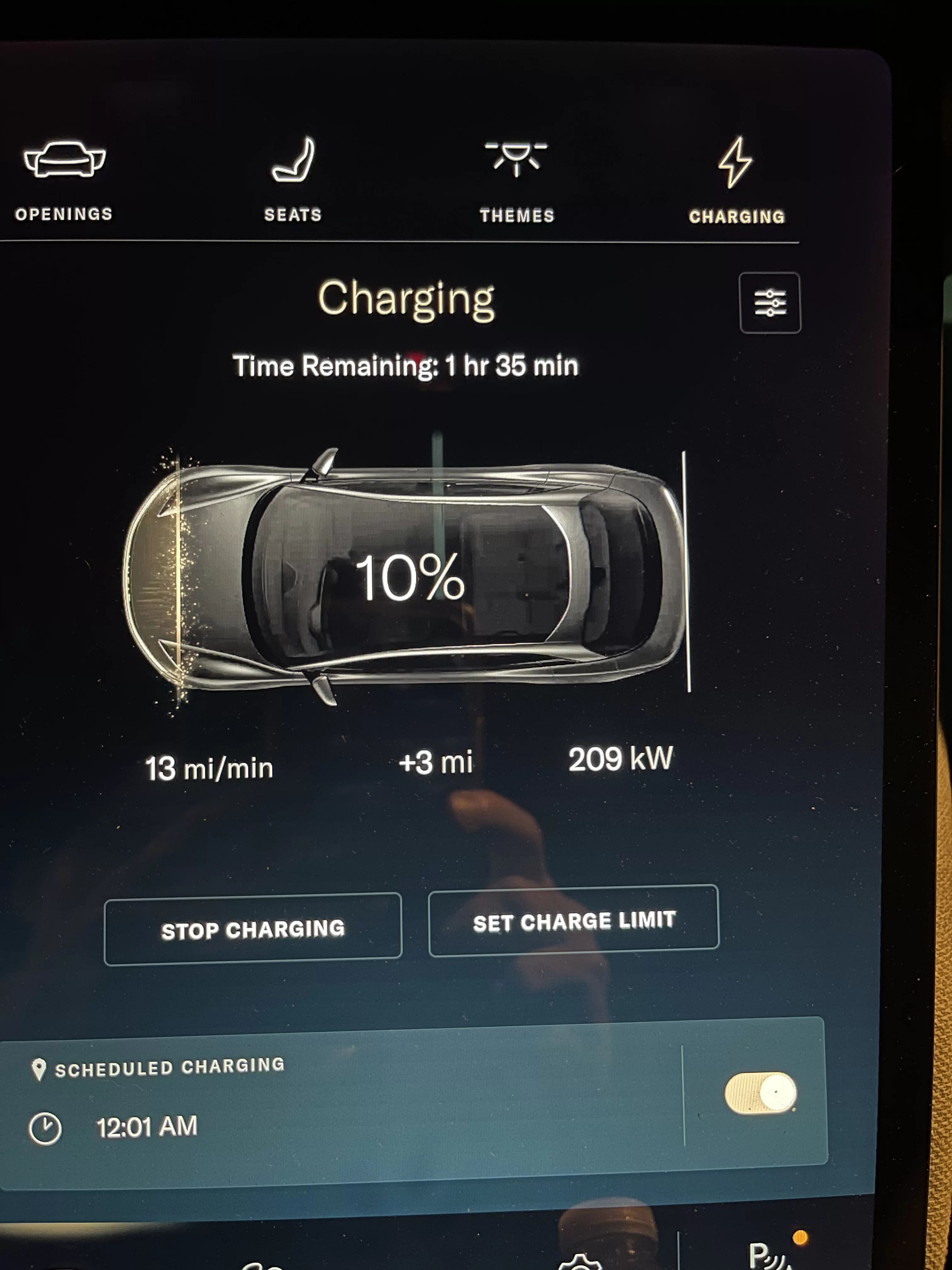

I have an AT and here is my 20 minute preconditioning speed. It’s possible to see higher if you are low enough and you preconditioning.
View attachment 27737I have an AT and here is my 20 minute preconditioning speed. It’s possible to see higher if you are low enough and you preconditioning.

I started around 240 but couldn’t snap fast enough. Here is 13%. It drops almost as fast as my accelerator at a light!
Also I started charging to 100% to see if that made a difference in speed. I had no intention of going all that way.
