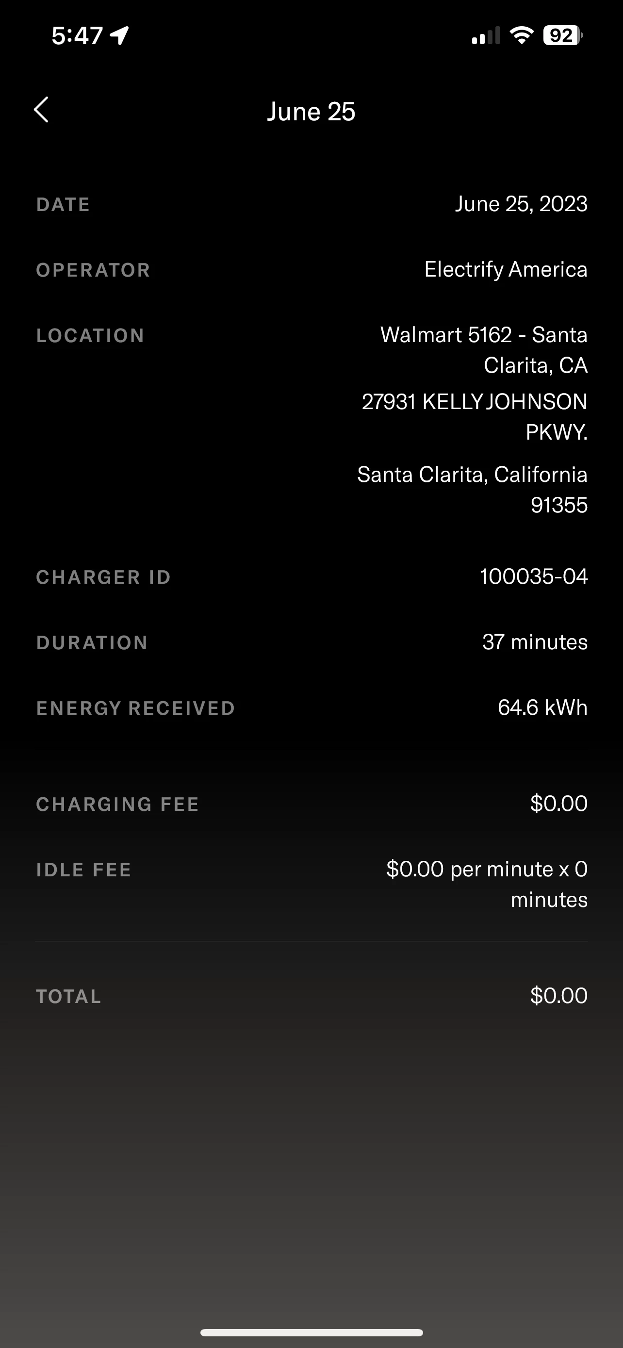

I charged it today at a 350 in Santa Clarita. Preconditioned for 20 minutes, arrived with 26%. It ran the normal charging curve starting in the high 200s. Here is my charge record:
