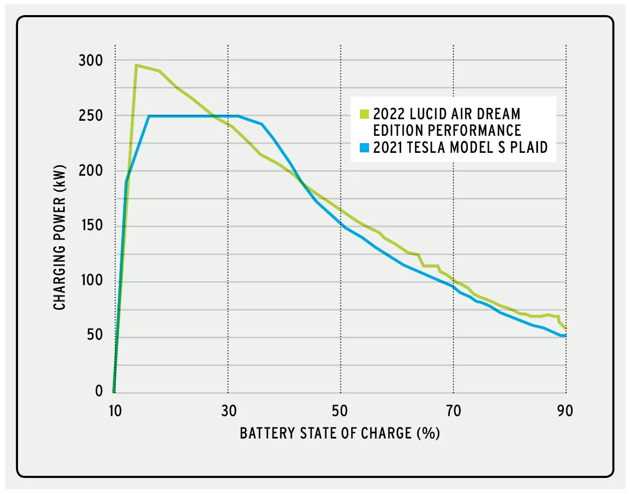

At 49% your *max* is going to be somewhere around 160-165kW, so on a shared charger you actually did very very well.

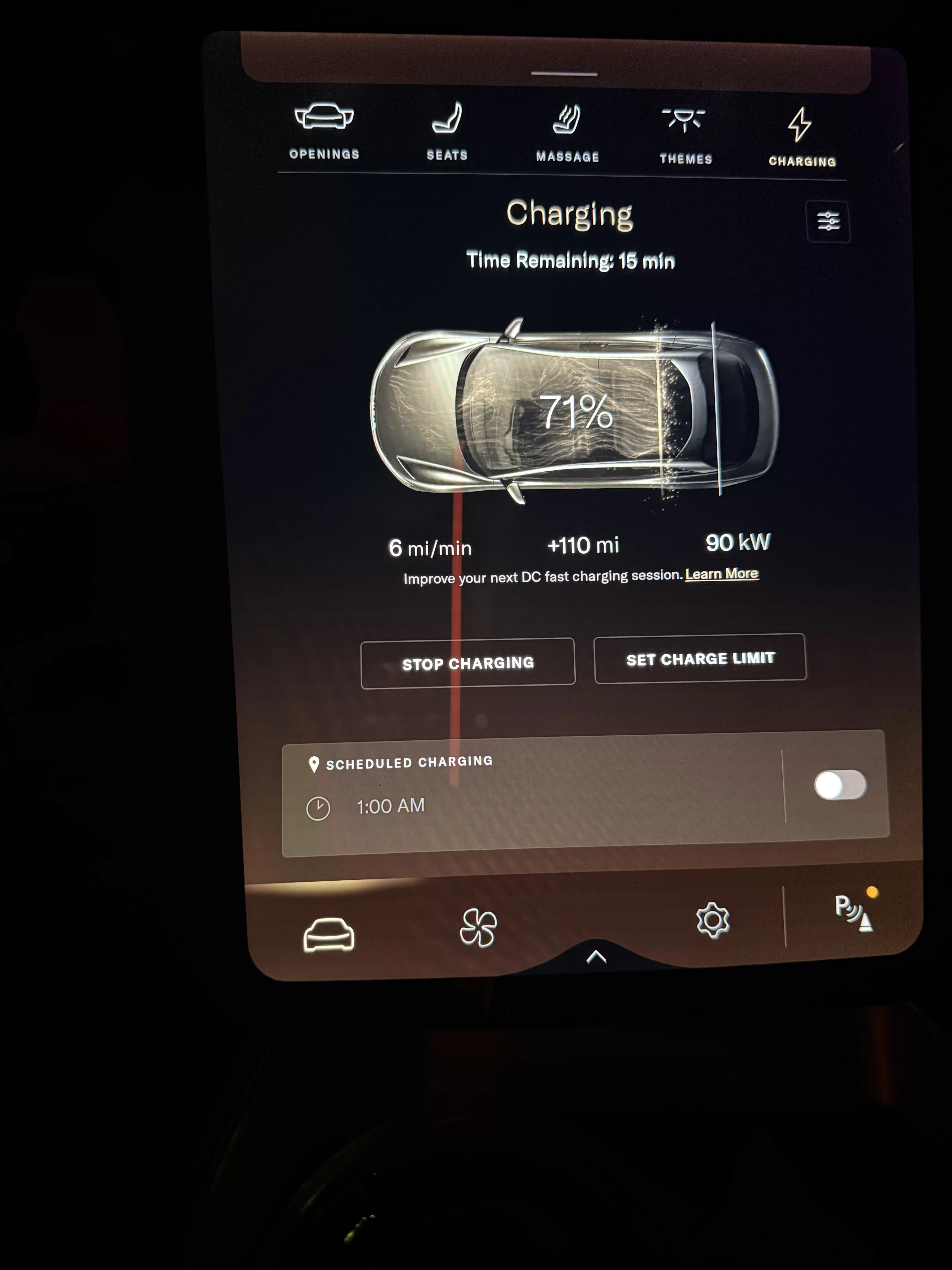

My Touring is well below this curve. At 71SOC, I'm probably at 70kW.
