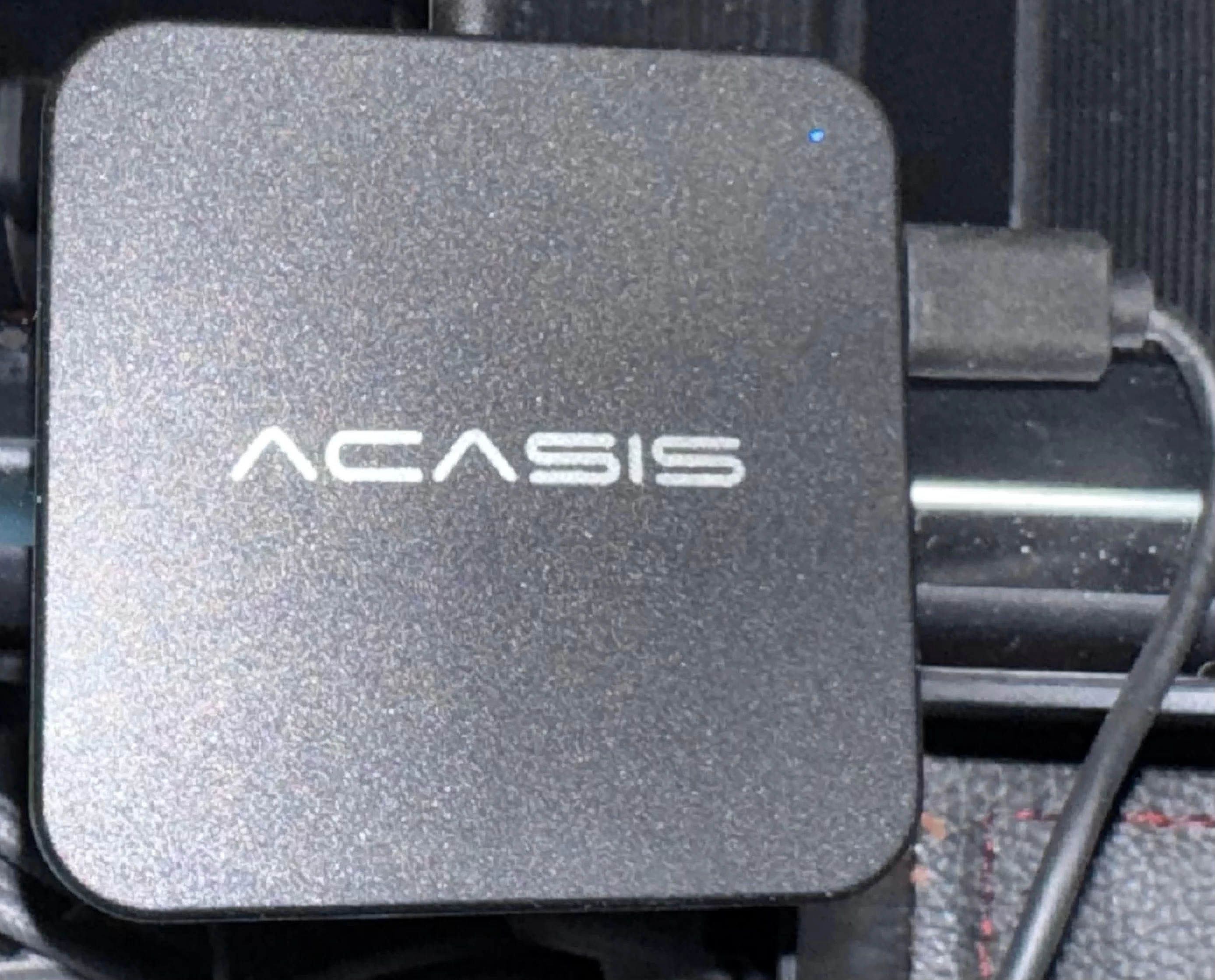

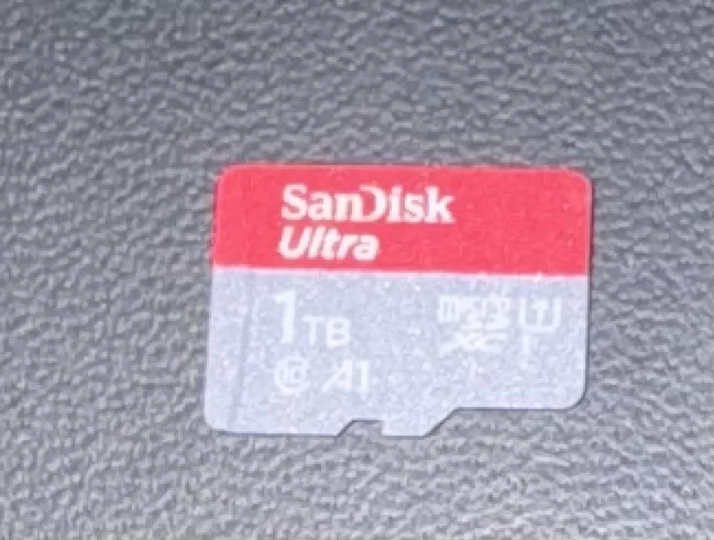

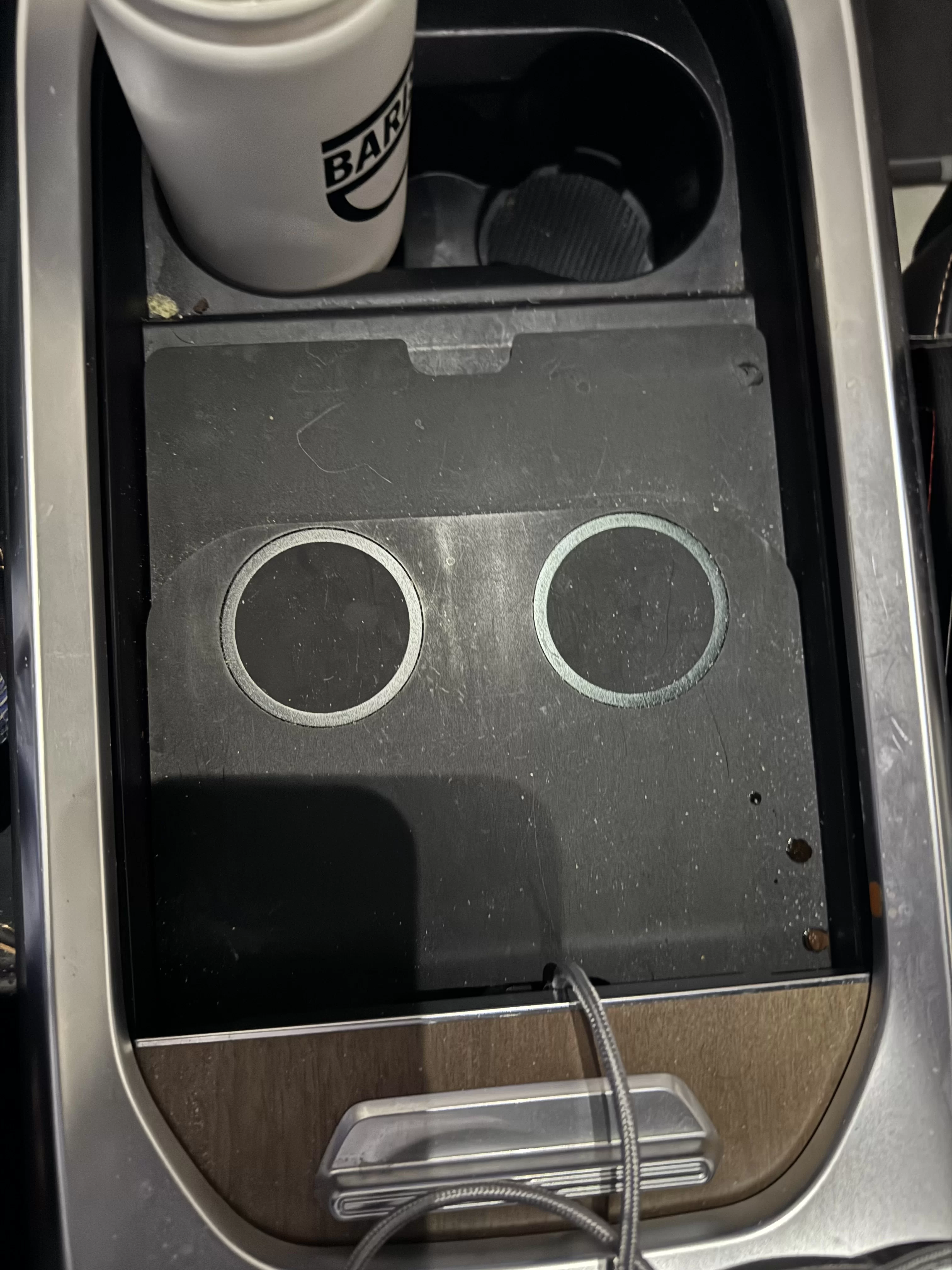

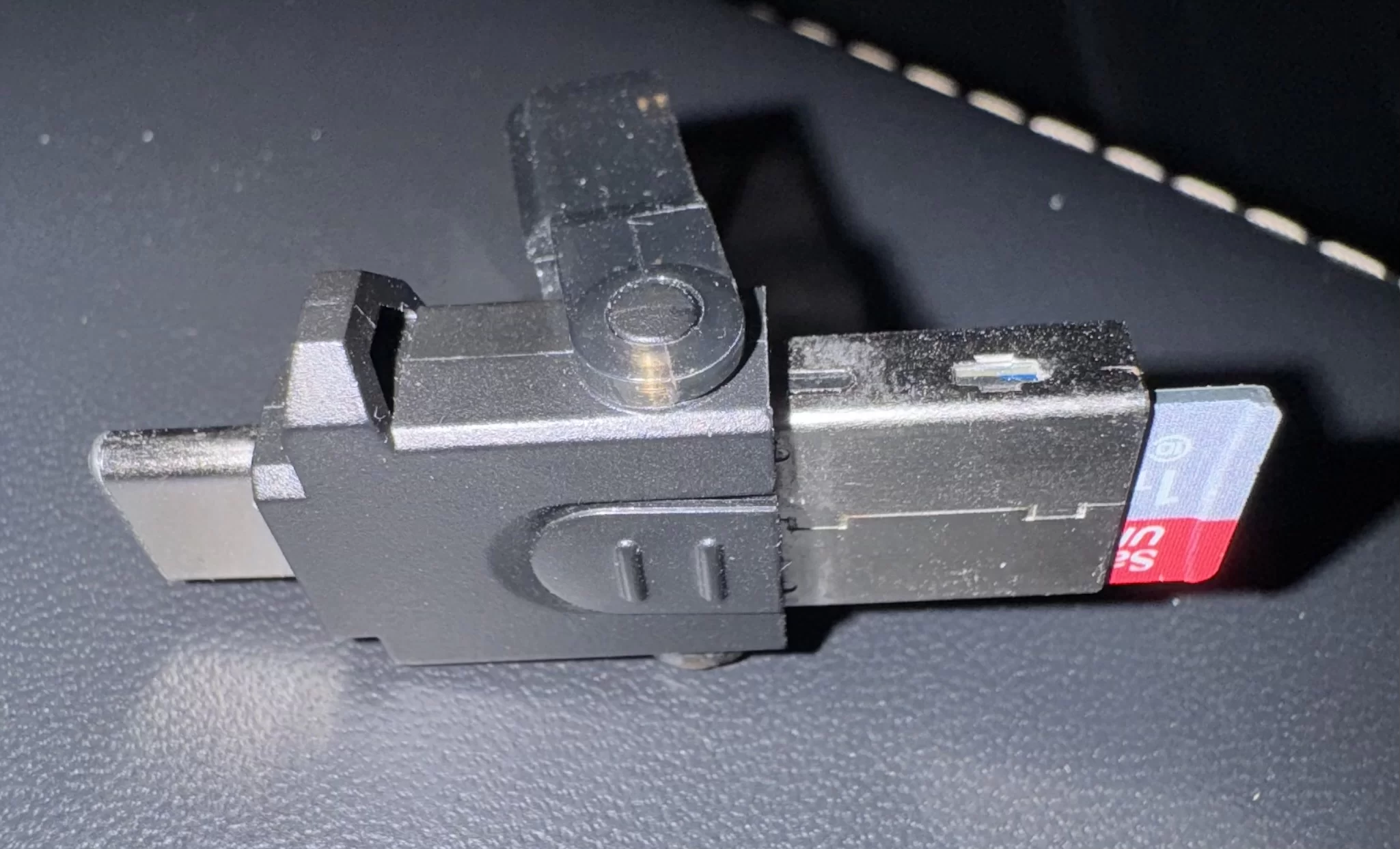

Hi,
Checked my setup. Using the following:
USB C hub ACASIS also connected to my TWRAPS charging pad
USB C to micro sd stick
Sandisk Ultra 1TB micro sd formatted MSDOS-FAT32
Music files are WAV, FLAC, and MP3. Some FLACs that I converted from DSD do not play—I have to try the conversion settings on them again. But 90% play just fine.
Hope you have good luck—the sound is outstanding.
