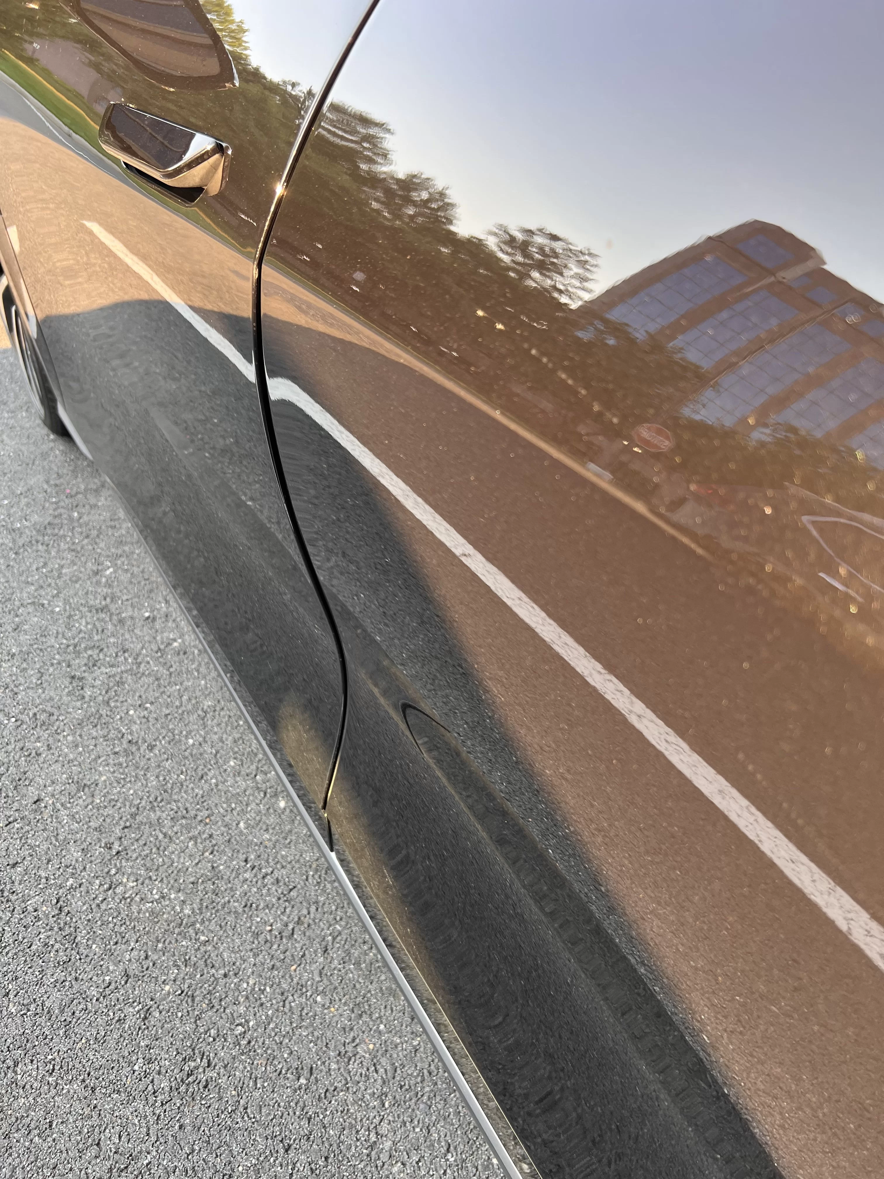

When I first received the car it had issues with the frunk which was fixed. Then an issue with the driver's door not staying latched on very hot days. The service tech readjusted the striker and it fixed the issue however the door was clearly sticking out enough that it was very noticeable and wind noise came through. The tech came back out and readjusted it is now lined up well against the body but is slightly lower than the rear door. And the door closes with a very strange sound like it is not lined up well with the striker (kind of like the sound if your seat belt insert accidentally stays in the door jamb). The other doors do not make that sound.

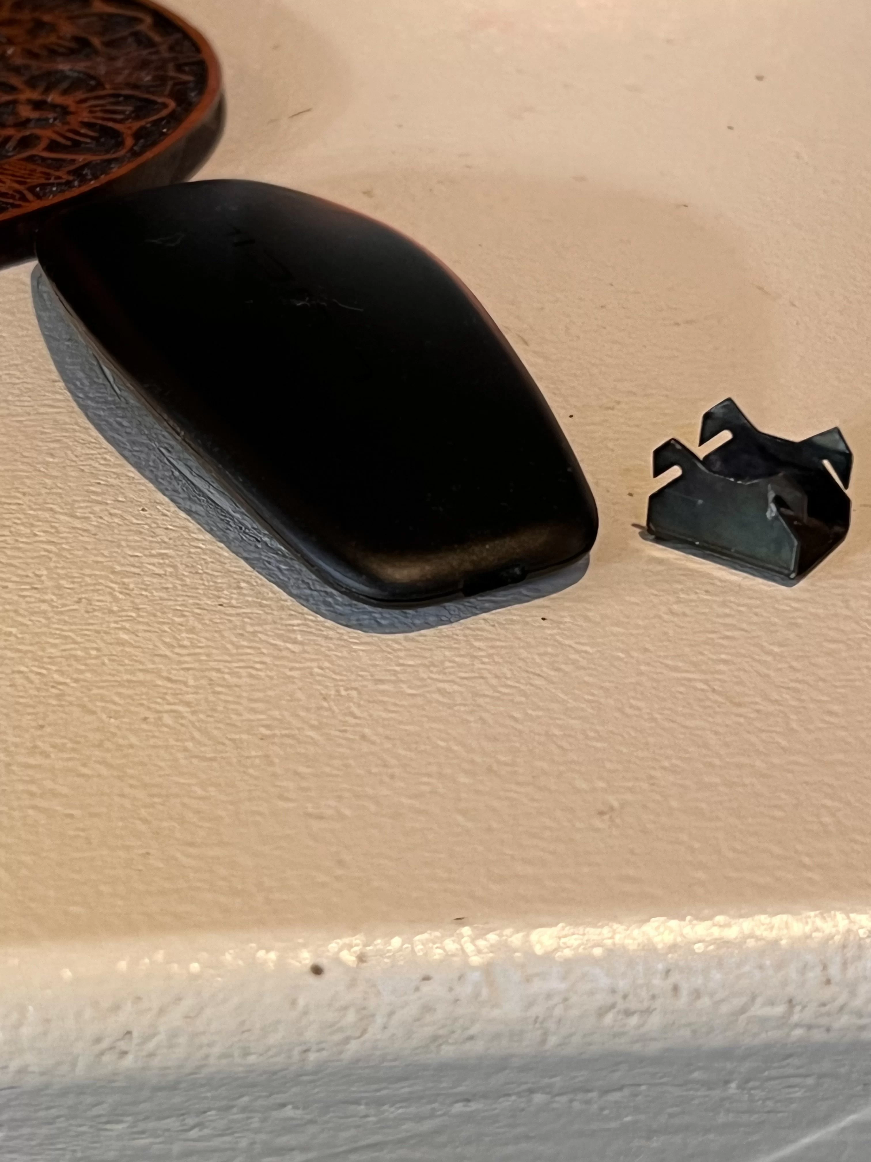

Finally, this weekend I opened the trunk and a retainer fell out and hit the trunk deck. I sent a picture to the service tech and he immediately text me back stating:
"Hey, so that clip goes to the decklid molding that goes around where the 3rd brake light is. I will be coming back up to northern VA either this coming week or the week after that. I will come by and reinstall that for you."
Here is a picture of the piece next to the FOB for size comparison (in case anyone else found a piece like this near their car):
One thing that does stand out is Lucid's service tech. They are extremely dedicated and communicate with car owners.
