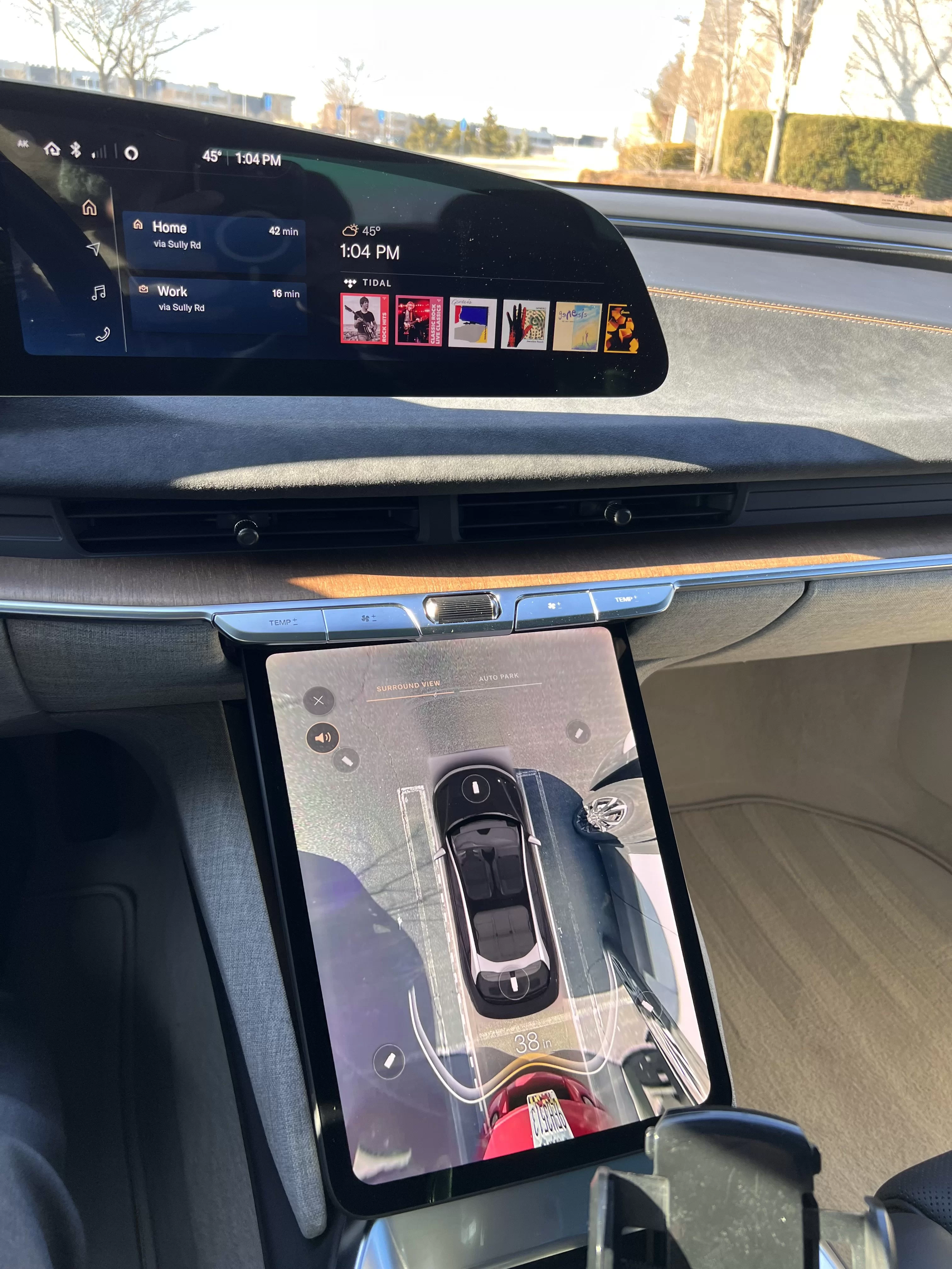

1. I have condensation in the driver’s side pillar camera
2. I cannot get the right cockpit screen to show the rear camera when I back up (the 360 on the large screen comes on with no issues).
3. I continue to get the “brake light malfunction” warning. So that everyone is clear, the brake light in fact DOES NOT work when this warning comes one (sometimes the middle light and other times all the brake lights)
I have performed several resets the Bobby profile switch and nothing seems to correct the brake warning or the rear-view camera.
I have reported this to the SM and ST, waiting to hear from them.
Any other technical suggestions to resolve this would be welcome.
After installing 2.0.45, my rear camera on the right pilot cockpit screen came back to life. We'll have to see if this fixed the brake light malfunction issue. I have to assume, since this update had nothing to do with cameras, is that the update process goes through a hard reset. Coincidentally, my SiriusXM hasn't worked since Sunday, but it worked after the update the entire 40-minute drive to work. I'll take both as a win!
