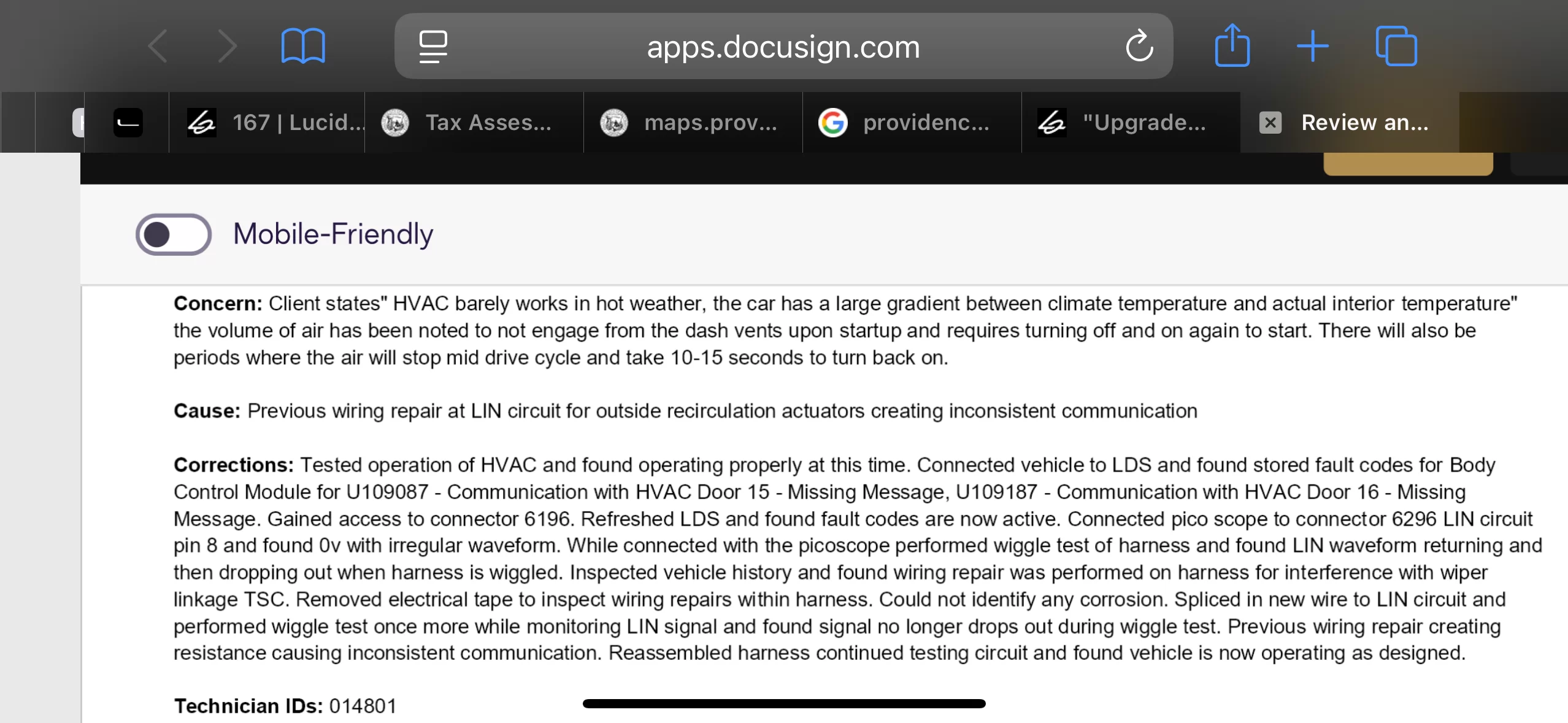

I recently had service in Natick Mass for a very bizarre HVAC problem where the front vents would intermittently cut out while driving, which was only remedied temporarily by turning the HVAC off and back on again. The tech wizards there managed to figure out the problem and fix it and now my HVAC is perfect. I very much doubt this fix would apply to anyone else’s vehicle so don’t go call service asking them to take apart a wiring harness to test resistance in an individual wire, but I just wanted to share how good these guys are at finding and fixing problems. See the service details…
