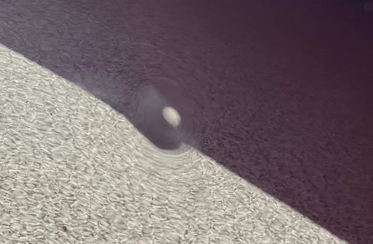

Here's the door ding that did not break the paint (about half the size of a nickel):
I was surprised by how good a job the "dent doctor" was able to do with the door ding. The first person I called refused to work on the car because it was electric. He was convinced that if he dropped a tool inside the door he would be electrocuted. I tried to explain to him that all the electrics in the passenger-accessible areas ran on 12 volts and that the powertrain electrics were fully isolated, but he refused to believe it. (He kept going on about how deadly 400 volts was. I didn't tell him that the Lucid has 924-volt electrics in the powertrain.)
The guy who did the work did say that everything about the car made the repair problematic. First, aluminum is a more difficult material to work with than steel when working out dents. Second, the side doors have laminated glass which is more prone to shattering as tools are being worked down inside the door. (He had a sheet metal shield that helped protect the glass, but he was nervous.) Third, the power sunshade adds to the amount of mechanicals inside the door that have to be worked around. Fourth, the ceramic coating prevented the use of a suction device that would have allowed working the dent from the outside. And, fifth, there was a large structural beam in the door that, had the ding been just an inch down, would have prevented the repair from the inside.
End of the day, though, there are no signs the ding was ever there.
@hmp10 , does that mean if you have just PPF and no ceramic coating, the dent could have been worked on just from outside? I have something similar on one of my doors and plan on getting it fixed later. It's probably smaller than what you had. The guys who did the PPF told me that the PPF for that entire panel (rear passenger door) needs to be redone after that.
My guess is that PPF would also present a problem in using outward suction on a panel, but I really don't know. I assume your PPF will have to be replaced because the object creating the ding tore the PPF?
With any luck, maybe they can fix it from inside the door. I hope so.

Is "dent doctor" just a regular body shop? Or someone who specializes in small problems like dings?
A dent specialist. Goes under the name "My Dent Guy". He had done some very nice work on an earlier car. The only reason I had tried someone else for this dent was that his schedule was backed up. I'm glad I ended up waiting to get on his schedule.
