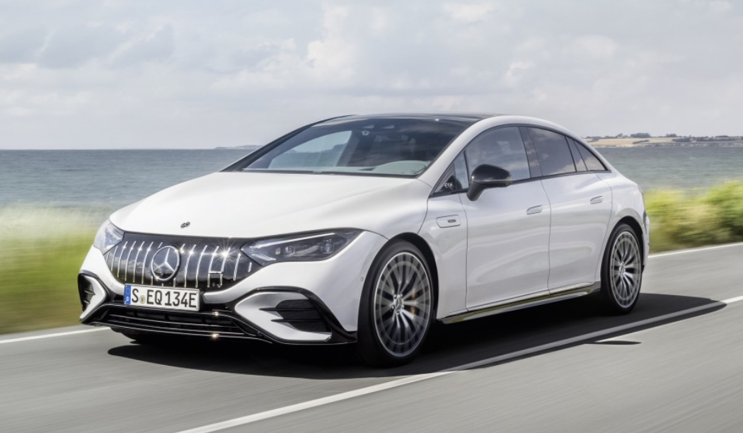

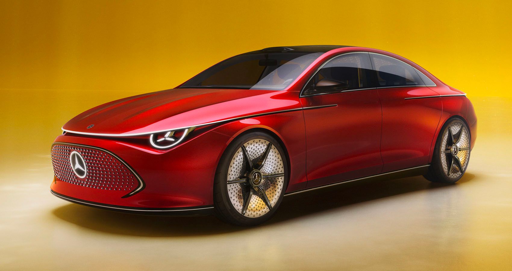

In addition to the Hyundai/Kia 800V,
Mercedes will upgrade to 800V architecture in 2025:
Polestar 800V
GM is not 800V architecture, but it is compatible with both 400 and 800V with a decent rate (350kW at 800V, 250kW at 400V).
Polestar 800V
Thank you for the correction. I was not aware that mercedes was going to switch. I wonder how they will handle that upgrade, same car with different batteries or just an all new EQS model? Or maybe discontinue the s class and replace it with a new EQS?(as mercedes has been planning)
I have no idea. It's an MMA platform. I imagine if the current design fits the MMA platform, then why not leave it the same?
