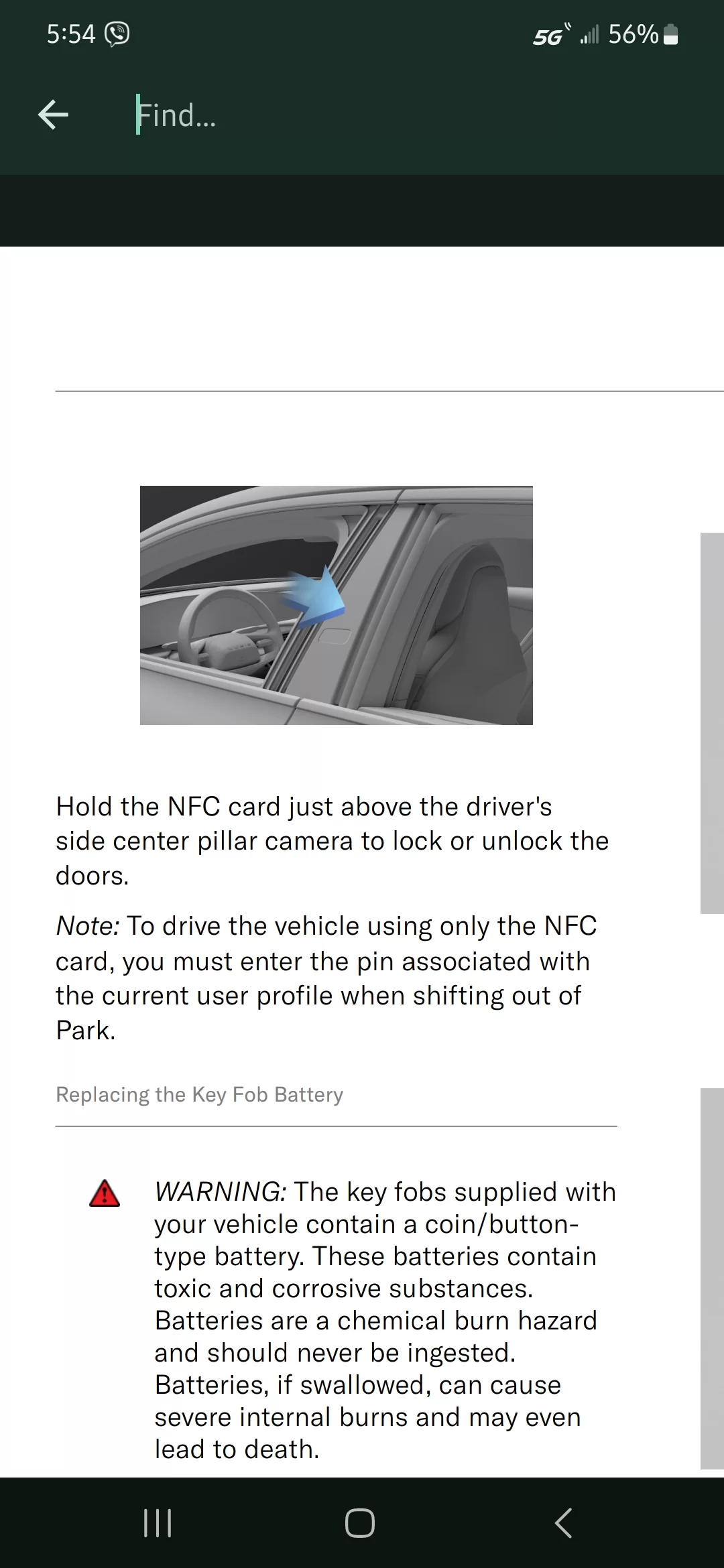

Did you hold the key up and push the handle at the same time?Well, then I can’t use by Bluetooth speaker for music while I am gardening...1st world problems right! But we were having multiple occasions of the car not opening due to my phone and my fob or my phone and my husband's phone both giving signals to the car and confusing it. My husband and often are both in the car together so both phones were signaling it. Lucid trouble shot it several times and felt the best solution was to unpair my phone as a key. We did that and the problems stopped. Until now with the fobs both dying about once a month. I will order Faraday bags and see if that helps. We tried with 2 different phone reps to get the car to unlock with both fobs, they said you could put the dead fob at the lower end of the column between the drivers door and it would open with a dead fob. We never achieved that. We even had issue with the valet card. So something is not working right. They replaced the column or the column glass about a month ago too, so wondering if the wiring to that isn't right?
Also in the right spot?
