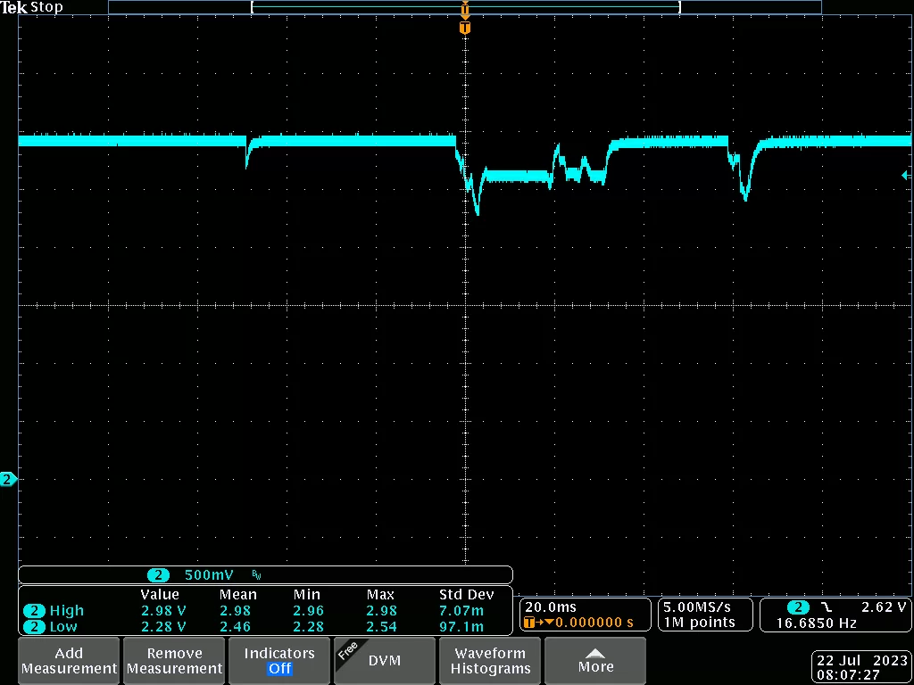

I think it would need to be under load to detect it. My fob battery warning came up for the very first time after the 2.1.3 update. I'm going to run some tests this evening to see how the battery voltage behaves when it's transmitting, before and after cleaning.
Welp, that was inconclusive. Turns out the batteries I have don't include a bitterant, and the one in my fob was actually low. With a dead battery, the voltage across it when transmitting dropped ~700mV from 2.98V to ~2.28V, pretty significant:
Once I changed the battery, the max voltage went up of course, but the drop when transmitting was much less, only ~180mV, from 3.32V to 3.14V:
The attachment is zoomed in and offset for more detail. I'll redo this test tomorrow with a coated battery and see if there's a noticeable difference.
I miss handling a Tektronix scope. Glad to see a familiar face.
