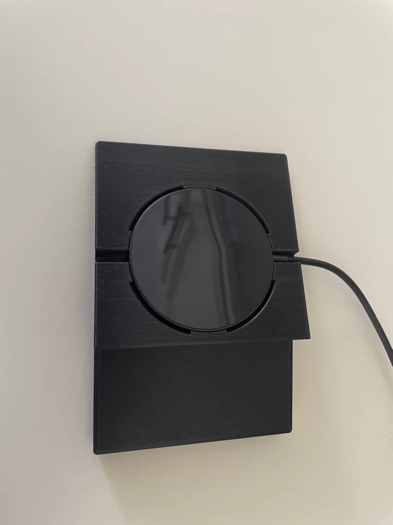

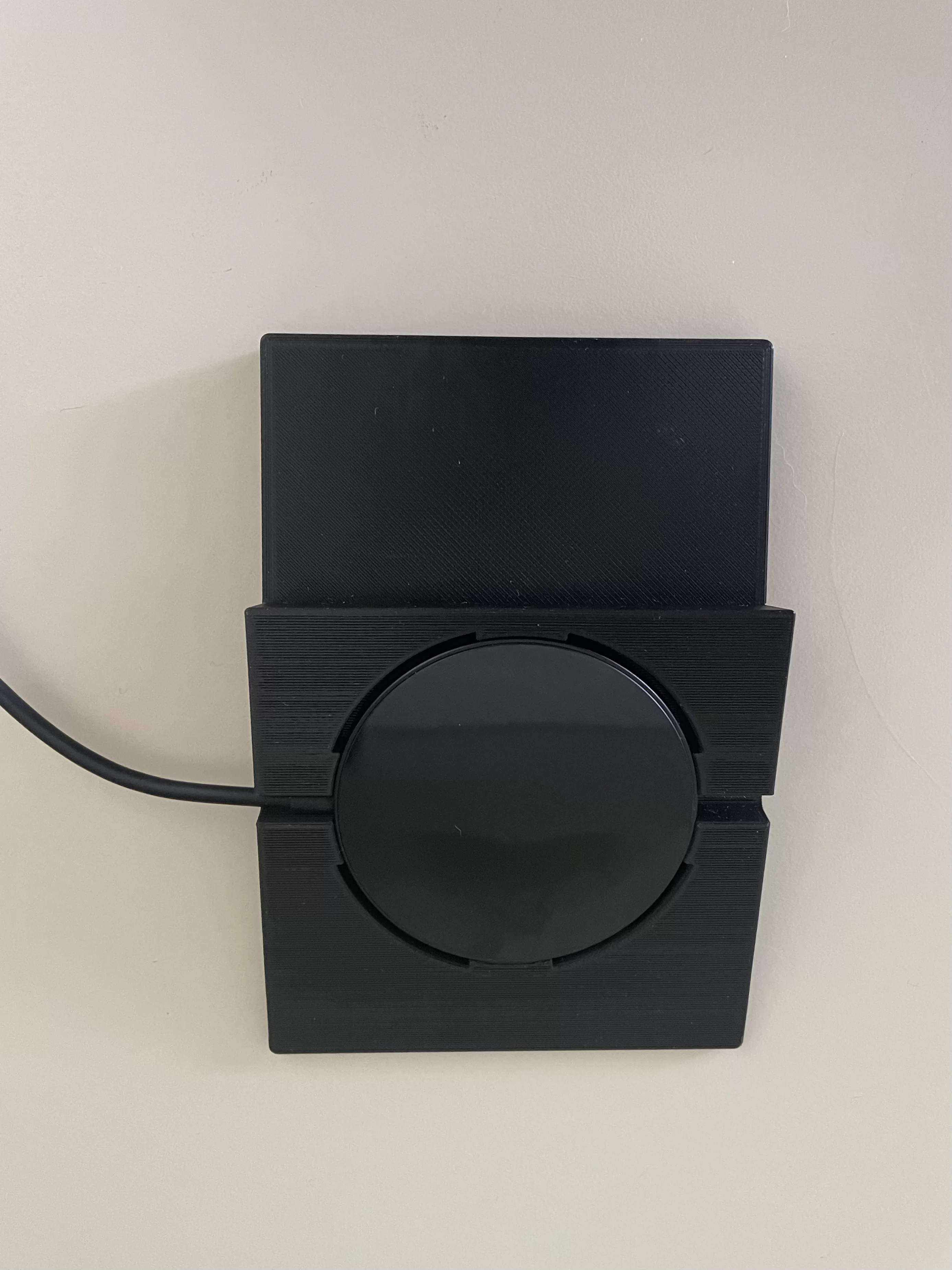

Here is my version, it is a takeoff on the original @Bobby version and the @Jonnyc versions.
Looks good.
The problem I had was that w/ my OtterBox, the magnet doesn't hold well enough and the phone wouldn't stay in place .. then I struggled w/ modifying (mostly w/ cardboard) the mounts, but they didn't work (phone would not stay .. especially when taking a right turn) and they looked horrible. Hence my "gift" from my nephew who loved the car, but hated the contraption I had made :oops: .. ..

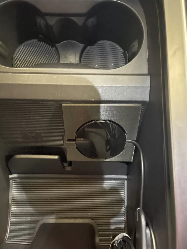

I have gone through several iterations of improving the useless wireless charging pad for my iPhone 12 ProMax in my GT. With the OEM charging solution, it is difficult to find the exact right spot for the phone, and even when I do so, it charges at only 5W. My previous solutions were working fine, but not as well integrated as I would've liked. Here are my requirements:
1. It is very easy and quick to position the phone.
2. The phone charges at the maximum possible rate without wires (15W).
3. The console cover can close while the phone is in place and charging.
4. It kind of looks like it was supposed to be there (i.e. no big suction or cupholder mounts sticking out).
My solution was to make a wedge shaped piece of 3-D plastic and mount a black iPhone Mag Safe charger (https://a.co/d/2JS2fJw) to it. Everything is put together with double-sided 3M tape and thus reversible. The phone holds on magnetically and road vibrations do not dislodge it.. This design satisfies all of the criteria!
Here's a picture of it for those interested. If anyone wants the G-code to print the little wedge or would like me to print one for them, please let me know. This will work for any iPhone 12 or higher.

In previous post, I forgot to post photos w/ the Phone in place .. attaching now.

The point of the wedge is simply to make room for the iPhone MagSafe charging puck since the iPhone Pro Max does not fit well in the provided charging spot. At first, I just stuck the MagSafe puck directly to the wireless charging spot in the car, but the bottom of the phone would not clear the clip down at the bottom. So I created a small wedge as shown in the picture to solve that. It is mounted with 3M double-sided tape, so therefore it is completely removable without any alterations to the car itself. There have been several other models proposed here on the forum, some with a recess for the MagSafe and its wire and some that stick down into the original holder. I've printed them all but had the best of luck with this simpler approach (simple minds, simple pleasures). It allows the user to position the puck anywhere he wants. I positioned mine low (see photo) so the rolltop could close when the phone is in there. Others may position it higher so they can see the phone better.
Any phone would definitely charge… but probably wouldn't magnetize... and might fall off or make poor contact. iPhones (12 and newer) have the magnet built in. For other models, you might need to get a case similar to this one (but for your specific model): Amazon: case with magnet. That would allow your phone to hold onto the magnet and stay snuggly where it belongs.

Got my nephew to print me up another one .. now the wife is happy! .. we can both charge our phone
