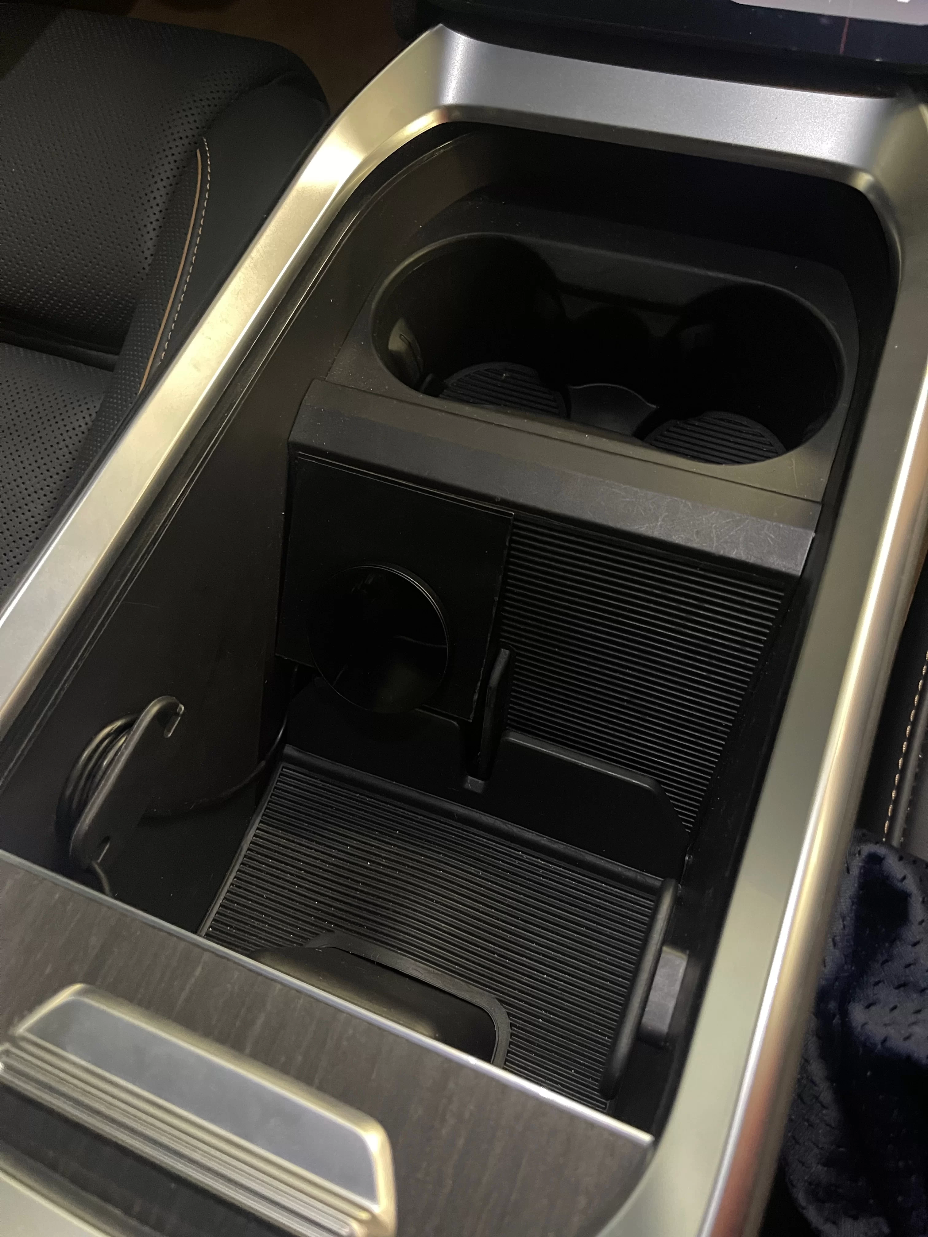

That looks great! However there is an alternative solution. If you lift the bottom pad you will see four screws that hold the support bracket. Your the remove the 4 (7 mm Hexhead screws) and remove the bracket. I put the screws back for safe keeping and then replaced the pad. Now you can you can mount your iPhone Mag Safe charger directly. I am waiting for my iPhone Mag Safe charger and plan to use Alien Tape to secure it. The advantage that @Bobby solution using a wedge is that it puts the phone a more of an angle to make the screen a little more visible.
With the bracket removed I found that I lay your phone in place and it will charge, however that is fine when the car is stationary, but probable not when the car is moving.
I did something similar a while ago and placed a "step up" pad under that rubberized piece and used longer screws to raise the rubberized part that keeps the phone in place. This creates enough space to allow larger phones with a case on it to fit in the slot and charge as intended.

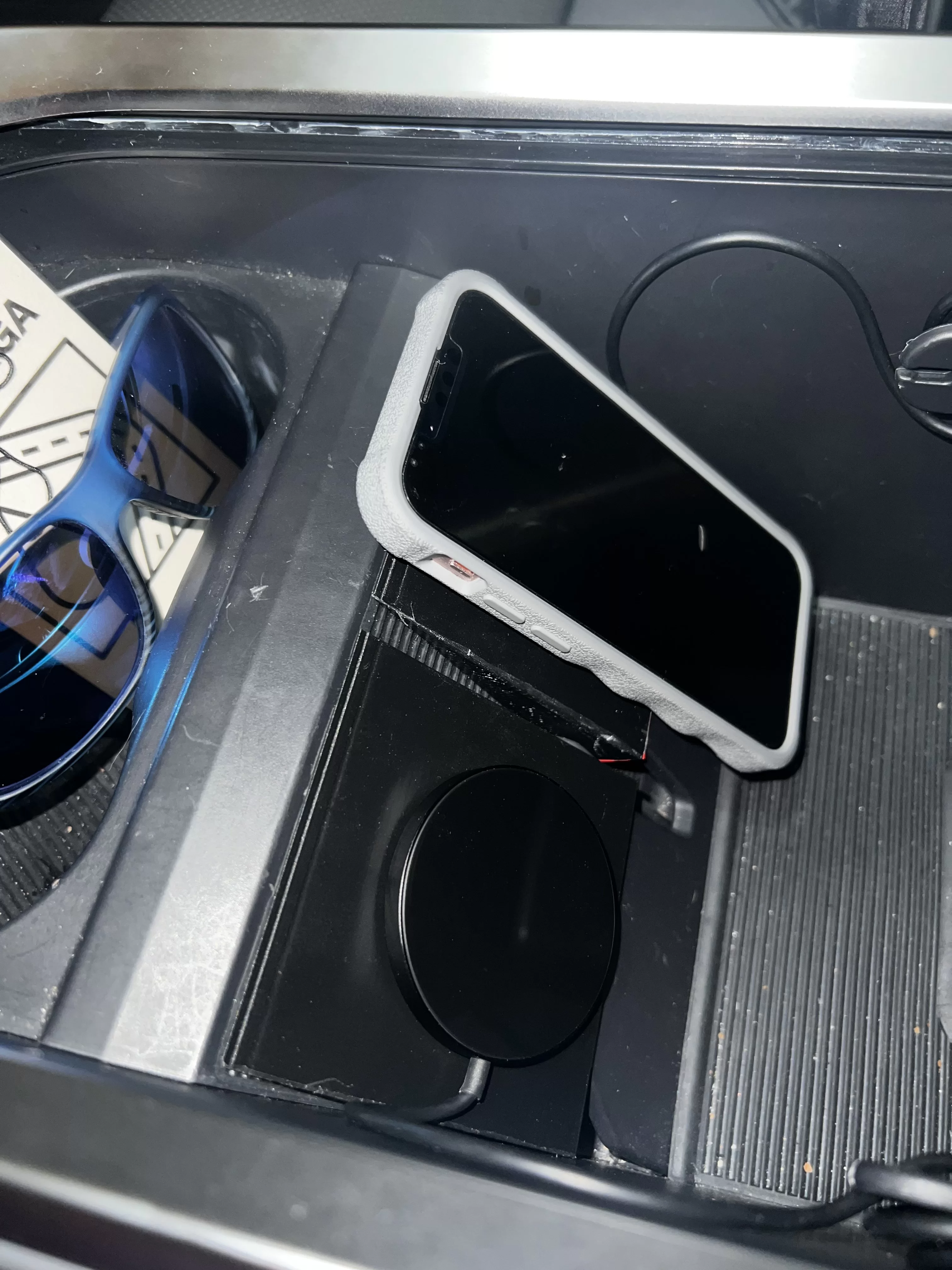

I have gone through several iterations of improving the useless wireless charging pad for my iPhone 12 ProMax in my GT. With the OEM charging solution, it is difficult to find the exact right spot for the phone, and even when I do so, it charges at only 5W. My previous solutions were working fine, but not as well integrated as I would've liked. Here are my requirements:
1. It is very easy and quick to position the phone.
2. The phone charges at the maximum possible rate without wires (15W).
3. The console cover can close while the phone is in place and charging.
4. It kind of looks like it was supposed to be there (i.e. no big suction or cupholder mounts sticking out).

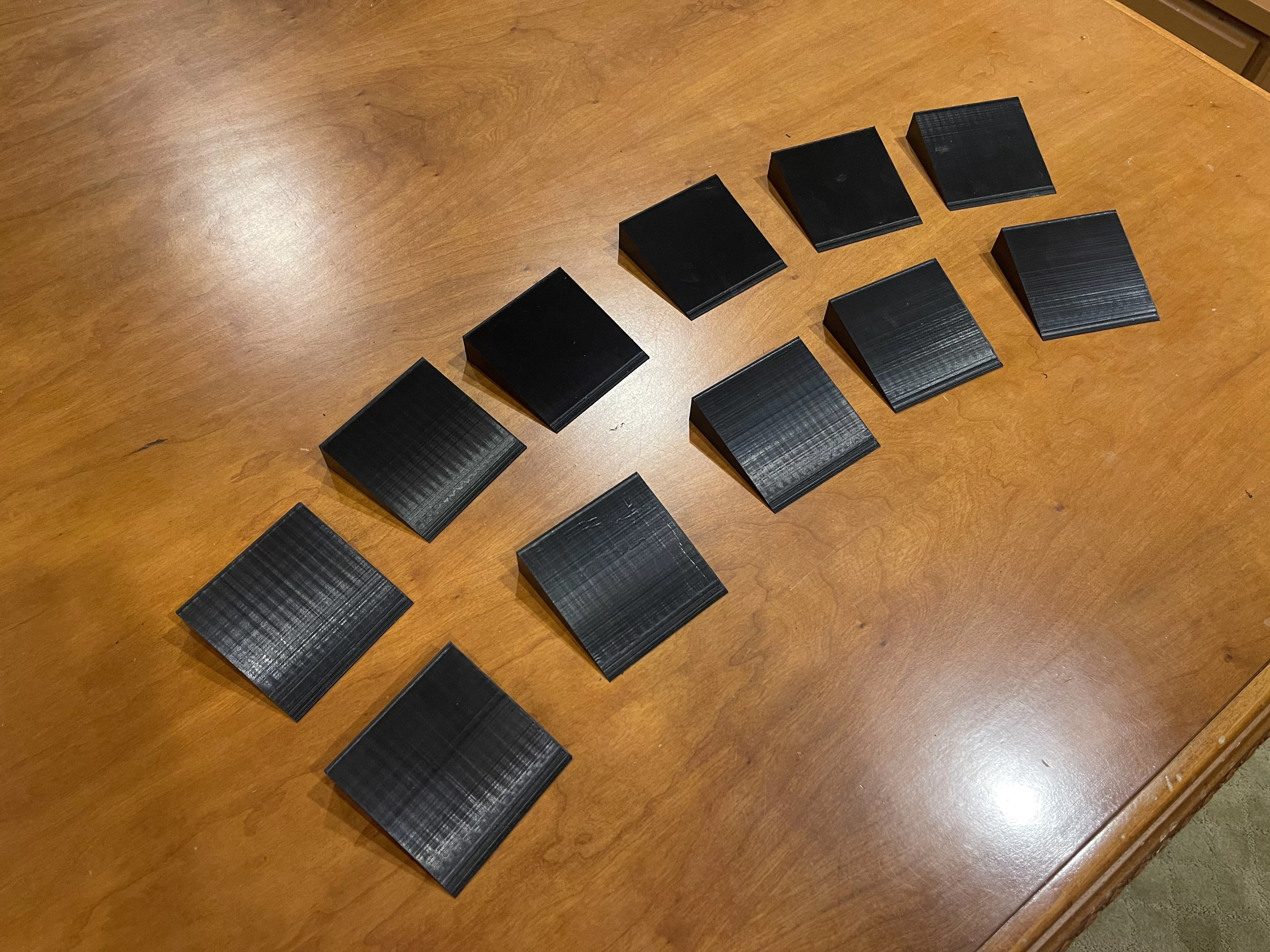

My solution was to make a wedge shaped piece of 3-D plastic and mount a black iPhone Mag Safe charger (https://a.co/d/2JS2fJw) to it. Everything is put together with double-sided 3M tape and thus reversible. The phone holds on magnetically and road vibrations do not dislodge it.. This design satisfies all of the criteria!
Here's a picture of it for those interested. If anyone wants the G-code to print the little wedge or would like me to print one for them, please let me know. This will work for any iPhone 12 or higher.

I will make a few and bring them. I like beer.
