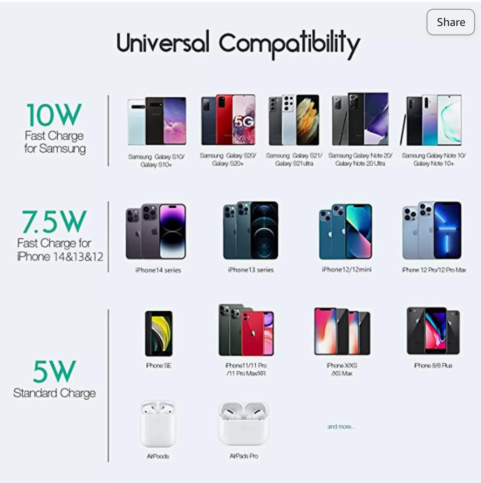

Noted. But upon reading about the product, seems like it works for Samsung phones also. See image below. Just one of the couple of places it mentions about being able to work with Samsung devices too
I’m sure it will work, I just wonder if the magnet will actually hold the phone up. There are magnets embedded in the iPhone to be compatible with that charger. If the magnet doesn’t work, the phone won’t stay on. However, you could certainly use the Wedge that I made and stick whatever magnetic charger you want to it.
