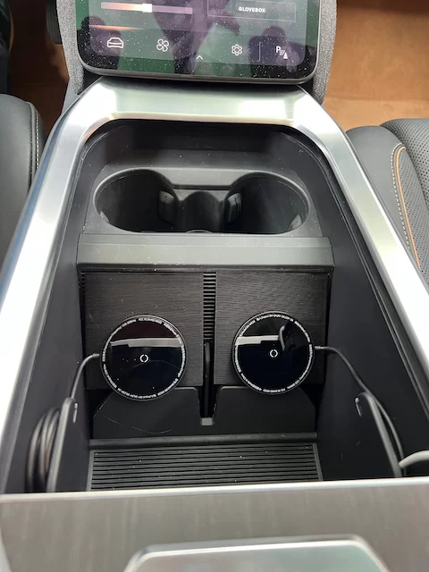

I have gone through several iterations of improving the useless wireless charging pad for my iPhone 12 ProMax in my GT. With the OEM charging solution, it is difficult to find the exact right spot for the phone, and even when I do so, it charges at only 5W. My previous solutions were working fine, but not as well integrated as I would've liked. Here are my requirements:
1. It is very easy and quick to position the phone.
2. The phone charges at the maximum possible rate without wires (15W).
3. The console cover can close while the phone is in place and charging.
4. It kind of looks like it was supposed to be there (i.e. no big suction or cupholder mounts sticking out).
My solution was to make a wedge shaped piece of 3-D plastic and mount a black iPhone Mag Safe charger (https://a.co/d/2JS2fJw) to it. Everything is put together with double-sided 3M tape and thus reversible. The phone holds on magnetically and road vibrations do not dislodge it.. This design satisfies all of the criteria!
Here's a picture of it for those interested. If anyone wants the G-code to print the little wedge or would like me to print one for them, please let me know. This will work for any iPhone 12 or higher.

Just wanted to say "thanks!" to all for their efforts on this solution, particularly @Bobby and @Jonnyc. I ordered a couple of wedges from CraftCloud per @Jonnyc's design and they work great. I couldn't find a suitable USB C splitter so, as others have done, went with an adapter to run the passenger-side puck from the USB A port; slower but still functional. And I added a splitter for when - as is often the case on road trips - the passenger wants to plug in an old-school cable to charge their 'phone while using it.

Is it still possible to get a couple of these wedges? I would like to try adding charging to both sides of the box. Let me know if I can pay you to defray the costs?

Happy to send you one. DM me.
