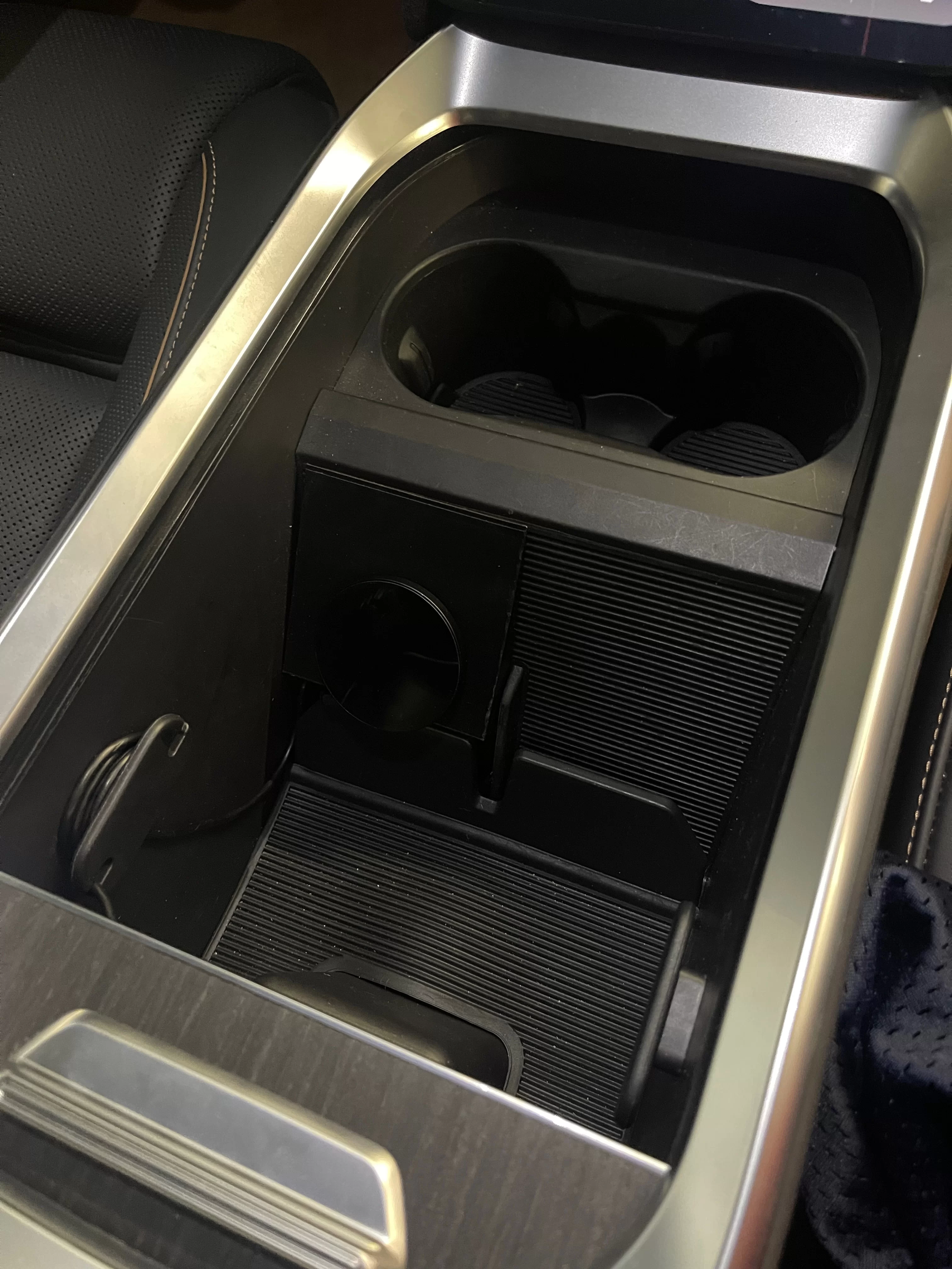

Do you not like the twraps solution? I love it, and haven’t looked back.I wanted to post some details on what I'm setting up, in case others wanted to.... refine a bit..
Bobby, being the cool guy he is, is sending me two of his 3D Printed fixes to Lucid's lapse in Qi charging judgement...
I thought it would be nice (at night) to see charging status and see where to target when putting your phone in the bay, so I was looking through all the options to find a charging puck that had an LED ring on it that's on when idle & throbs when charging. Braided cable instead of rubber is a plus as well, but not as much of a requirement since they'll never get moved. Unfortunately, most of them are white (ugh).
Then I found this... Aluminum, braided cable, and LED status that lights when idle, and throbs when charging in a similar white to the Lucid HVAC control glow:
https://www.amazon.com/gp/product/B0BGR552KM/ref=ppx_yo_dt_b_asin_title_o01_s00?ie=UTF8&psc=1
Now, you may be looking at that and going "But the LEDs are under it, so when mounted to the wedge, you'll never see them... That's where this comes in. Instead of double-stick tape, I'm planning on using these:
Their transparency allows the above LED glow to shine through on the edges (use the wider ones, attach to the pucks, then use a blade/exacto knife to trim them to exact size).
So, if you're wanting to do this, and have a little bit of a "light guide" to show you where to slap your phone - this setup might just be the thing for you.![]()
