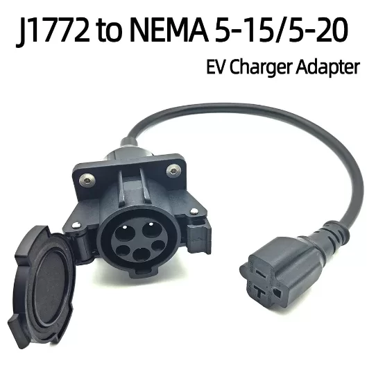

Shouldn't J1772 to any plug adapter work technically to allow having different type of outlets? For example J1772 to NEMA 5-15/20 below and have a working outlet when camping. Also J1772 to NEMA 14-30 and you can run a dryer from Lucid. This could be cool. HAHAHAHA. I wonder if wounderbox and charging cable have logic to adjust voltage and or amperage based on the connected consumer. Any brave souls to try it out?
Hmm, good question. I don't think the car will know it's connected to a 5-15 receptacle, so it might place 240V AC onto it if you tried this.
Here is one from Lectron.
This is probably a good time to remind folks that just because the plug fits, that doesn’t mean it “works.”
Stringing all manner of adapters together might technically get a connection going, but you can fry something pretty quick if you don’t know what you are doing.
If your car has a V2L function, that should work because it doesn't need a proper handshake signal from your toaster.
A proper J-1772 would implement a handshake signal. Plugging in a dumb device like a toaster won't work until someone can program the toaster to do an appropriate J-1772 signal.
