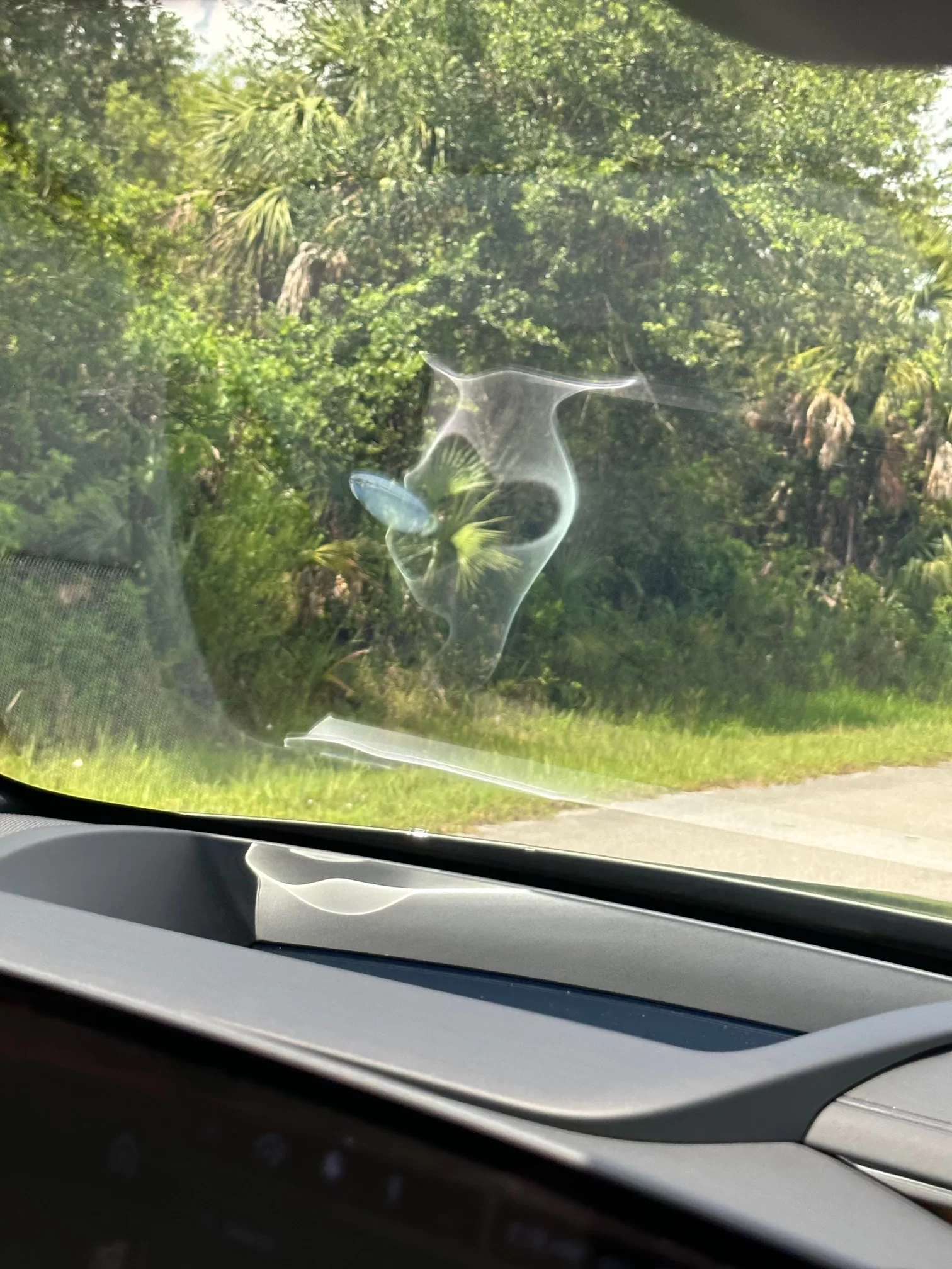

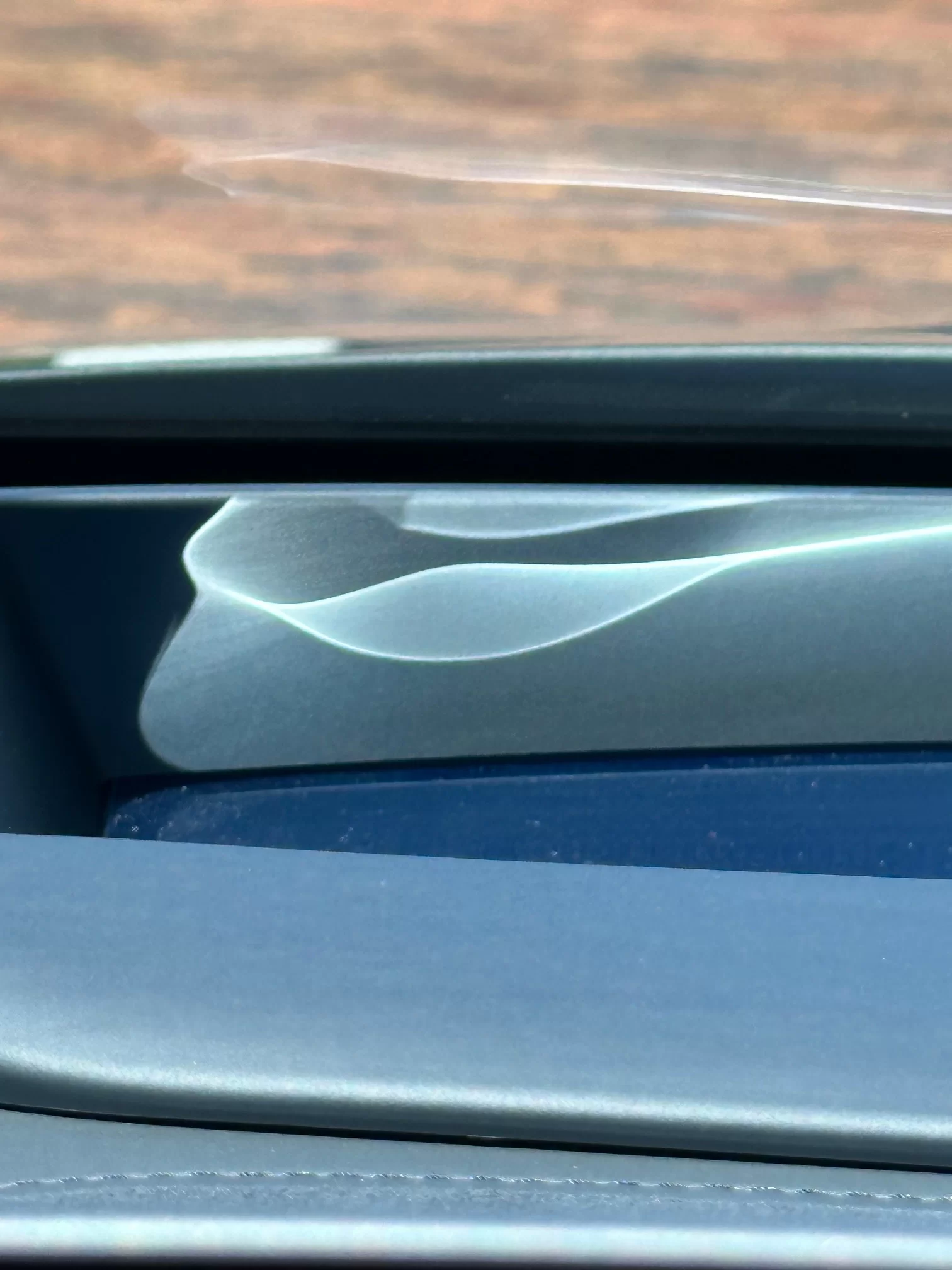

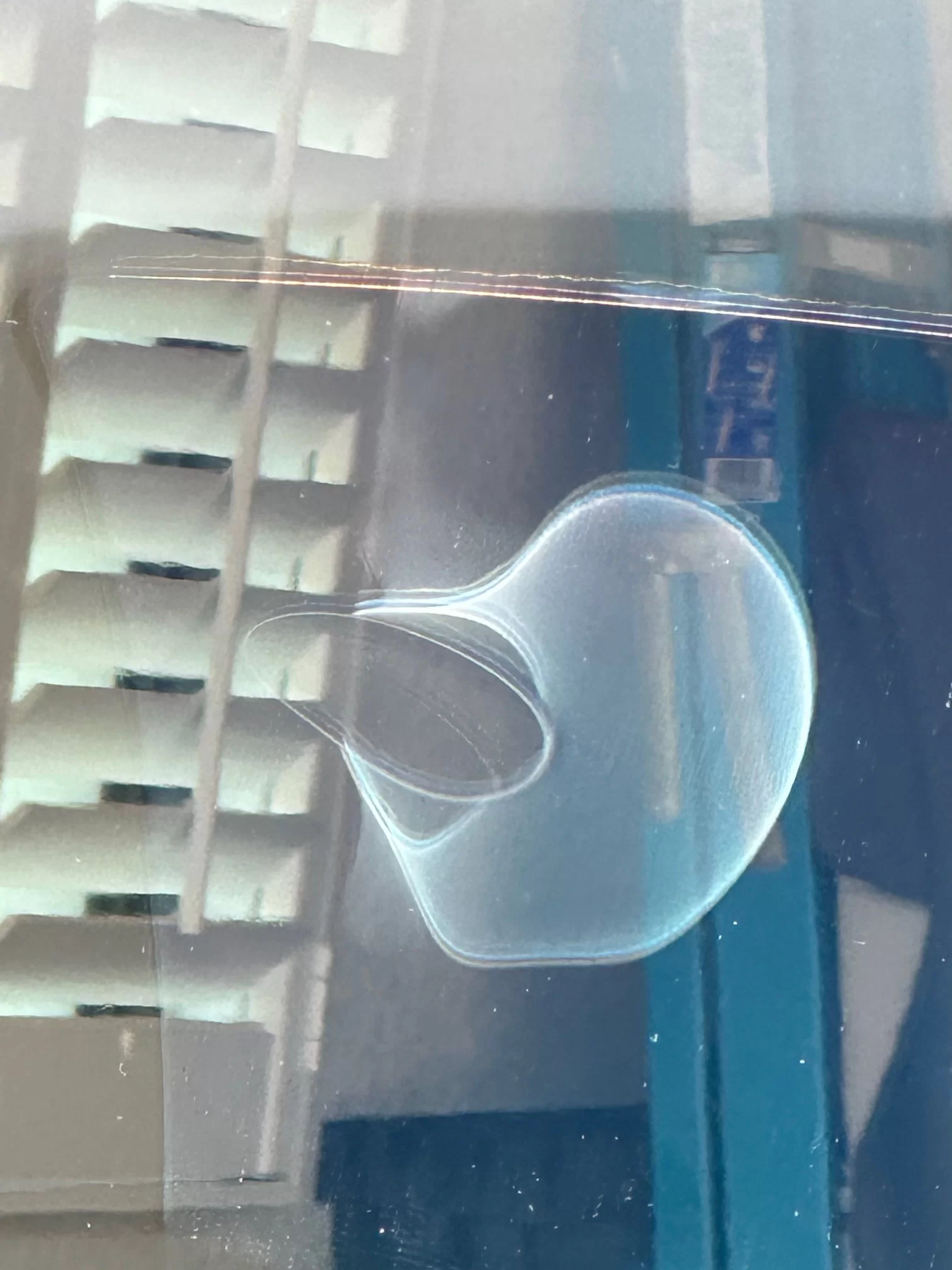

The mobile tech has been here for the past few hours. He was able to get Homelink working. He confirmed that a new HUD is required and has ordered one, but he doesn't yet know whether he can install it or the car will have to go back to Miami to the Service Center. Right now, he's re-torquing all the bolts of the second row seat to try to resolve the rattle and squeaks in it.

(The tech just called me back out to the car to tell me that he could not entirely address the second-row seat noises and is going to request that a replacement seat be ordered. He'll let me know how Lucid responds, along with the other issues still outstanding.)
