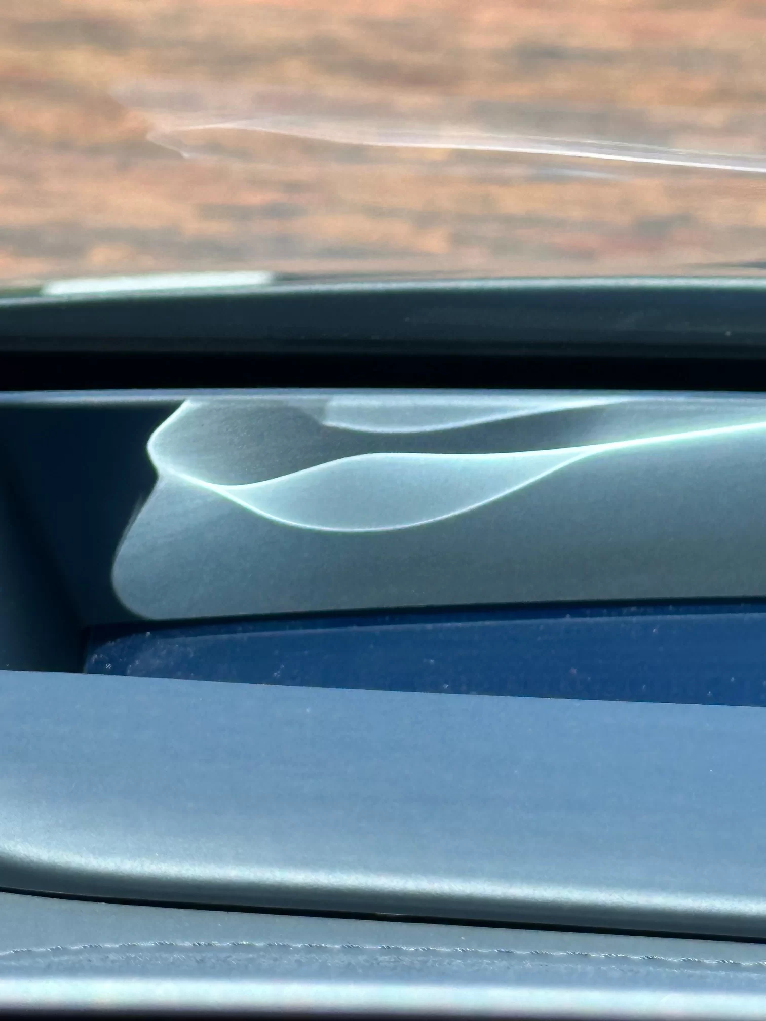

For my test drive, the car could not be shifted into Drive, with the fob in the center console. The SA just kept flipping, moving the key card and finally it worked. Took him maybe 10 attempts.
Everything else seemed ok. Didn't see the HUD reflection, driving East and West at 2 p.m.. No extraneous sound coming from the second row seats -- the SA was sitting there, though.
